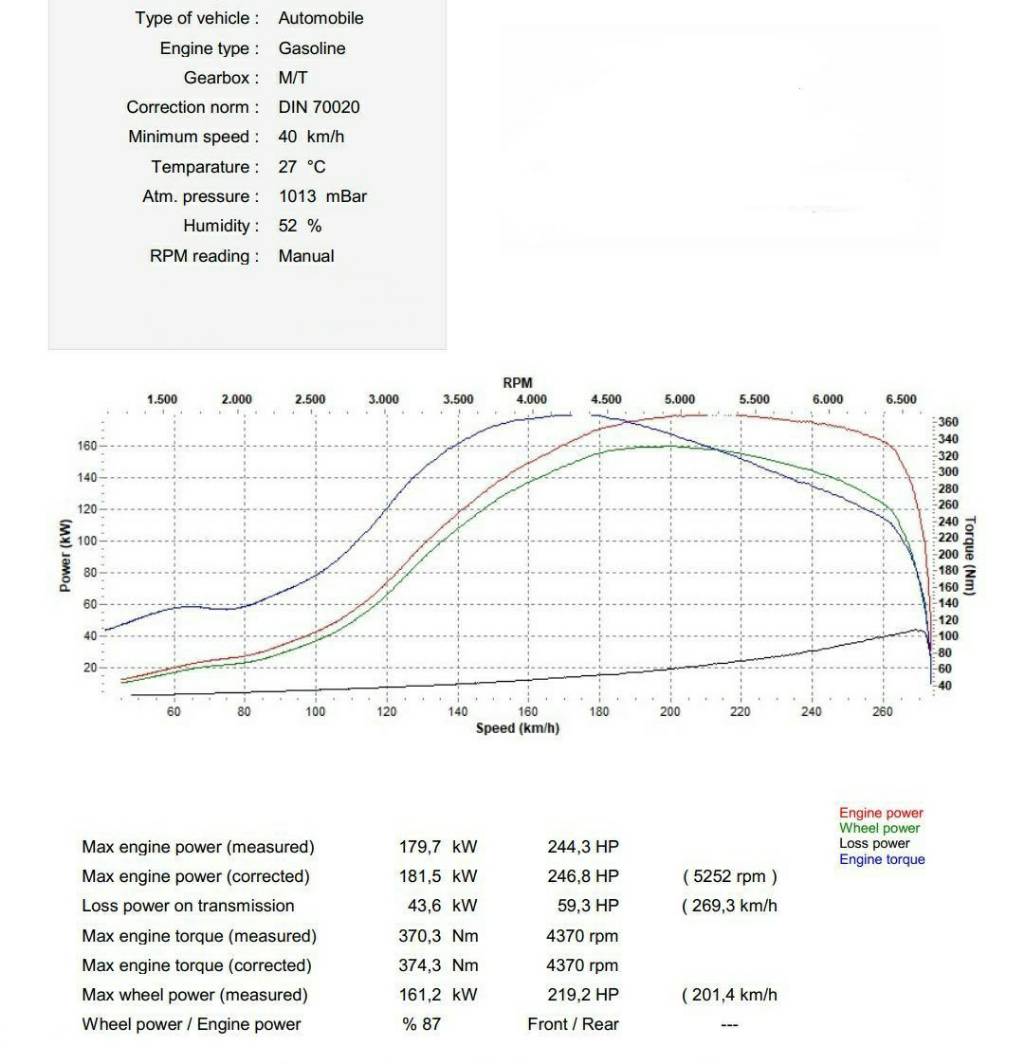

Didn't come here to get attacked. I'm just trying to help someone out
But here you go a dyno graph of my car: Snapchat-190022915__01.jpeg

how do we know thats your car... No details about the car, non about the dyno, non about mixture or boost....
Also 170mph in a 1.4 Punto.... that's impressive :D Not sure the gearbox would allow that....
68 more HP than a Punto Evo Abarth Supersport, but only 4 more Torques... ?
https://www.facebook.com/TorquePerformance/photos/a.451255634939051/2259740384090558/?type=1&theater
(y)
You do seem to be missing a bit of data there. ;)

That's just what I got sent on Snapchat by my mate who works there as you can see by the file tag.
Doubt me as much as you want but I know that its true.
