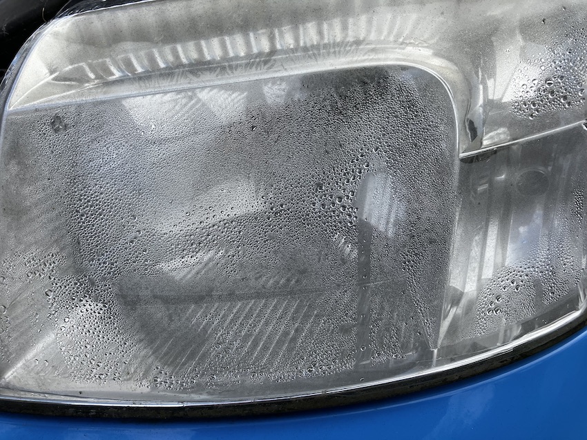

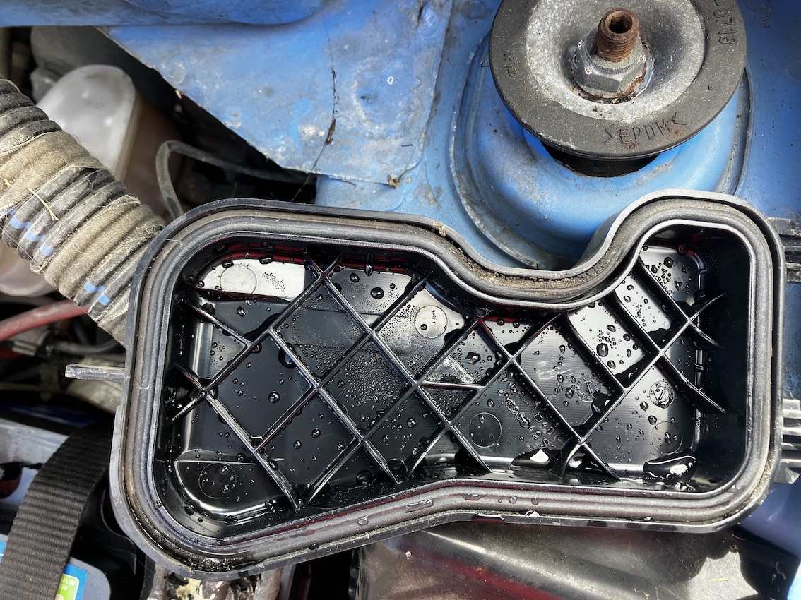

Sunny and dry afternoon here, so I've taken out the headlight bulb and holder and the indicator bulb holder too. Getting at the side light bulb seemed too difficult.
Left the cover off and left it under the bonnet near the battery.
I'll leave well alone for a day or so. We have another car, so we're not stranded!
I took photographs.
Fingers crossed by the end of the weekend, the glass will be dried out. The seal rubber doesn't look too good, so I may bring that in and pull off the rubber and clean it all thoroughly.
Thanks again for the comments and advice.

Just take the black covver off and drive it for a bit with the headlights on
A standard bulb, gets very hot,, it will evaporate any moisture very quickly, as long as it has somewhere to escape (leave the back off) you basically have a mini one of these built in https://en.m.wikipedia.org/wiki/Halogen oven, makes sense to me to use it. It will be done in 1/2 hour. Less if you can find somewhere to drive with the main beam on
Works on the drive with the engine running. But I wouldn't leave the main beam on as its designed to be air cooled.
bulbs out and and letting it dry naturally will take forever

The bulbs have been out and the bonnet lifted for three hours this afternoon, and although the glass still has condensate on it, it looks "different". I was considering using a hair dryer tomorrow to heat up the glass and maybe inject the hot air inside. Meanwhile, I've closed the bonnet for the evening/night.
Cover off and running the engine with the lights on dip sounds better. I could go for a drive with full beam on I suppose, but I/we rarely drive at night these days. There are enough quiet lanes hereabouts where I could drive during the day on full beam without upsetting folk. Maybe the next idea if the hair dryer doesn't do it.

It's a rubber seal so don't use Vaseline. Use red rubber grease or silicone grease.
Sorry, but I've already used the Vaseline. It's fine with rubber. If you can put it on a baby's bottom, it can't be harmful. I've been using Vaseline on car battery terminals and hose connections for years without issue.
Meanwhile, I used the hair dryer, but it wasn't powerful enough, so dug out my heat gun from the workshop. It has three heat setting, warm, quite warm and VERY warm ............. and that setting will strip paint! Suffice to say, I used the second setting, but maybe six inches away from the glass.
By doing it for a couple of minutes whilst playing it about on the glass, and then waiting five minutes before another application, the moisture has gone so I re-fitted the bulbs. The seal was in good condition though dirty, and after a good clean, it looks great.
I cleaned out the cover and applied a smooth layer of Vaseline under and over the seal, and fitted the seal in the opposite orientation so the top bit is now at the bottom. I would expect that the seals when new, are circular.
All done, and time will tell if there's a deeper problem.
The car was laid up for a few weeks outside before we took it on, so maybe lack of use has exacerbated the issue of a poor seal.

Drove the car this morning, and although the light was condensation free, and it's been a lovely warm dry day ............. the condensation is back.
Just looked out of the front window.
So ........... although I dried the glass, the humidity must have been still inside, and now it's condensed on the glass again.

I opened the bonnet, took the cover off, removed the bulbs, and left the car facing south in full Cornish breezy sunshine.
Over the last two hours, the glass has cleared!!!!

Please just leave the bulbs in and on, back off, they soon dry out
Otherwise you just move the moisture around
Been here many times with various cars

What are the covers for anyway?
Had many cars in my driving life, and none have had these cover fittings.
I was out driving for half an hour today, and had the headlights on dipped. The glass cleared somewhat, but not fully, and I doubt it'll remain clear. I'm going to go outside shortly, and remove the cover, and I'll leave it off.
Mick.
The problem is that, even with the cap off, not much air is going to circulate through the unit. It's like trying to dry an empty wine bottle by leaving it out in the sun; it takes a surprisingly long time, and good drying weather.
If you can arrange to circulate air through the headlamp unit (blowing it in through a flexible tube is one way), it will dry much faster. If the air is warm and dry, so much the better. An airline off a compressor with an inline dryer with the pressure turned right down might do the trick; you just want a nice steady flow of dry air through the unit. An aquarium air pump might work well too, as might an airbrush compressor on its lowest setting.

I removed the cover yesterday afternoon, and the car hasn't been driven and the lights haven't been on either.
This morning, before breakfast time, the light was clear-ish.
By noon, it was completely clear and still remains so. 5pm+
All I did, was to remove the cover yesterday afternoon and close the bonnet.
