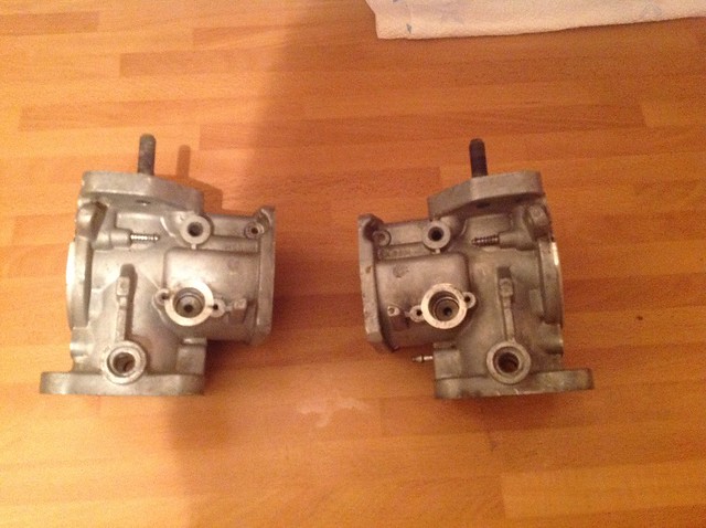

It what garages use to do everyday with k series blown head gaskets, there are full aluminium block, head and radiator
We are talking about a 20g tablet with around 30% alkaline so about 6g in 4.6L
More concentrated, direct in a dishwasher, does a fine job of cleaning aluminium parts
Not my photos
It will strip anodised finishes though
