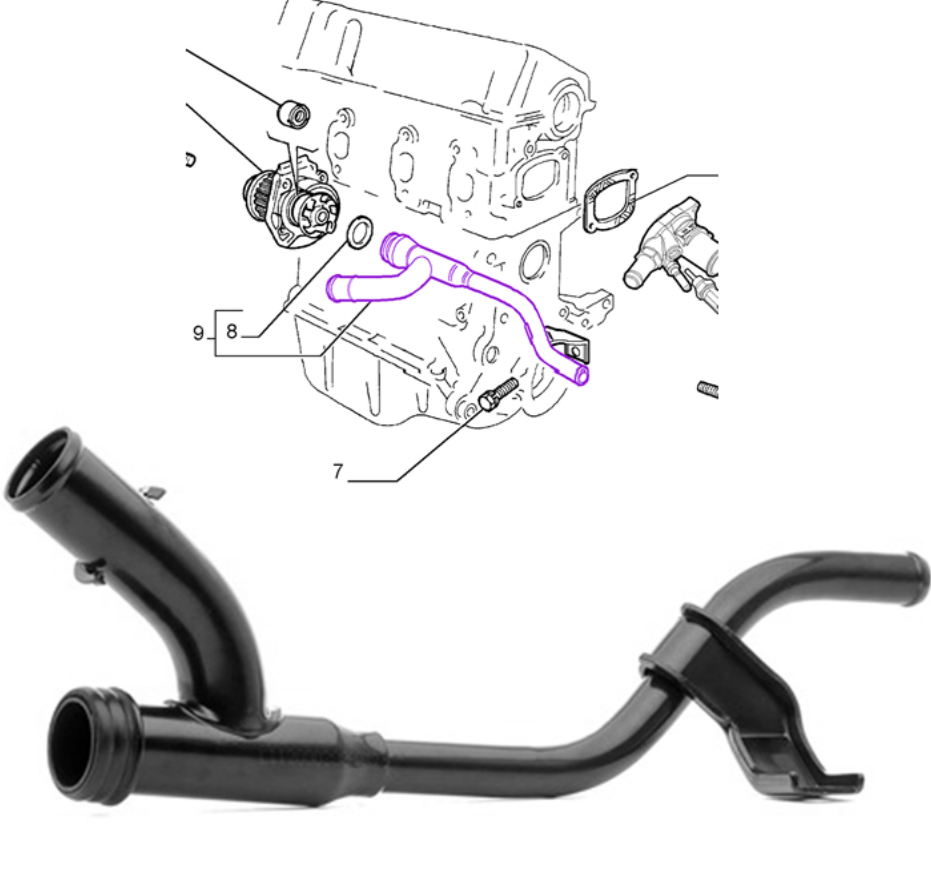

That metal pipe coming out of the back of the water pump looks pretty corroded. This is a known weakness and failure point, I'd suggest you change it now whilst you're waiting for the head to come back. You can get one from S4P for around £20 or so. It may save you from another coolant leak a year or so from now.
Well done for your efforts thus far.
Do you mean replace the water pump or the pipe behind the exhaust manifold?
I'm having trouble locating one -- could you send a link?
This pipe
It's hard to tell in your photo I looks rusty and possibly some red coolant stain
Search for
55245750 coolant pipe
If it needs replacing
This pipe
Search for

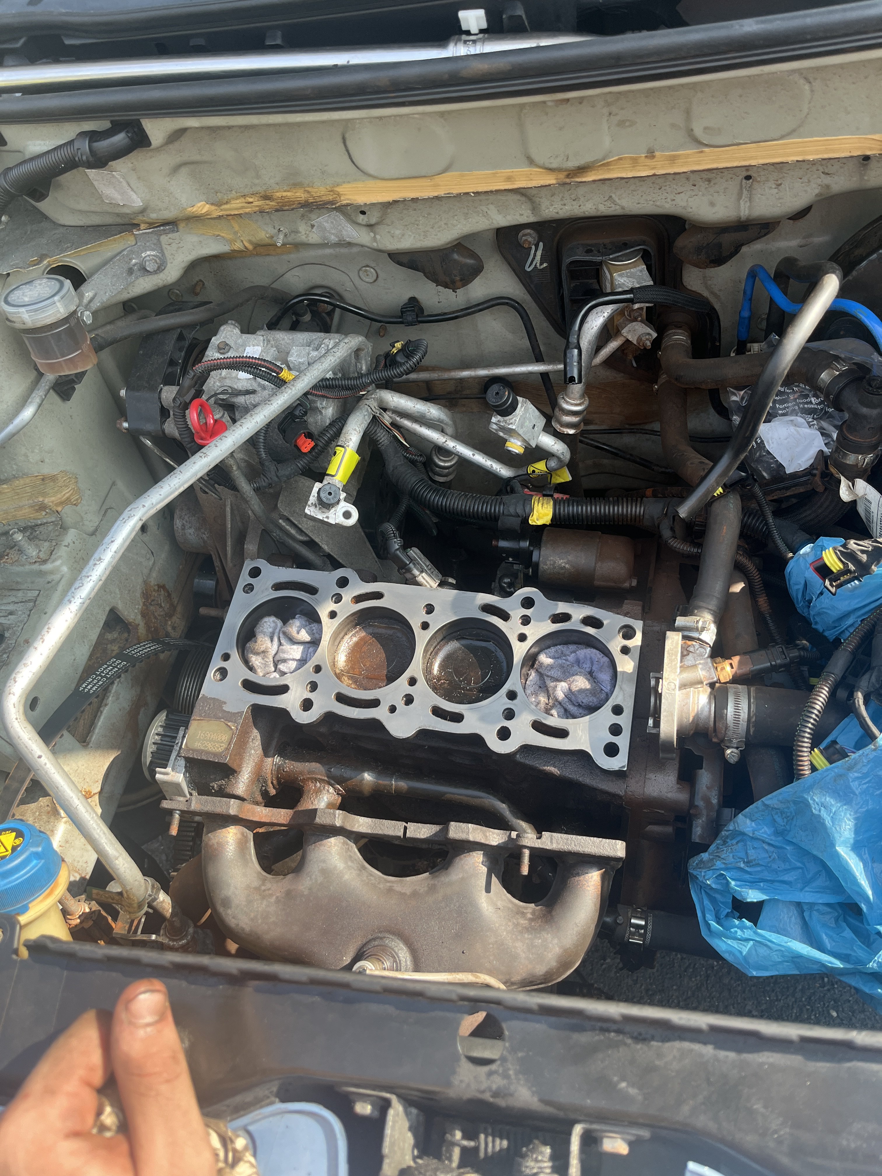

Updates: got a lot done today, and the head is way to be skimmed!!
Looking lovely, "Nice N Shiny" which is always good! I enlarged the image and notice there seems to be a fair bit of "crud" in the tapped holes. you need to clean these out before reassembling. (I blow them out with compressed air, then run a suitable tap down them and blow them out again.)
Thank you so much!! Iam planning to do something like that went the head gets back -- i know i risk cracking something if there's water or anything in there

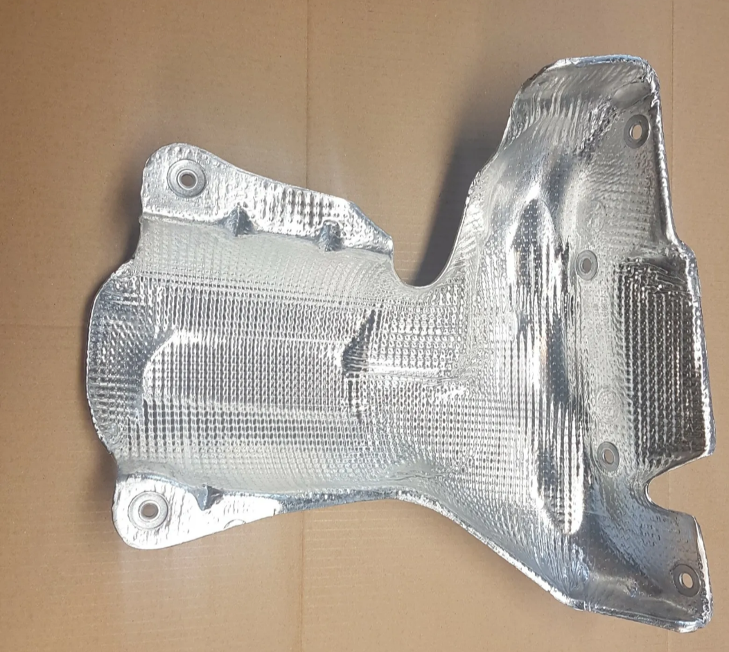

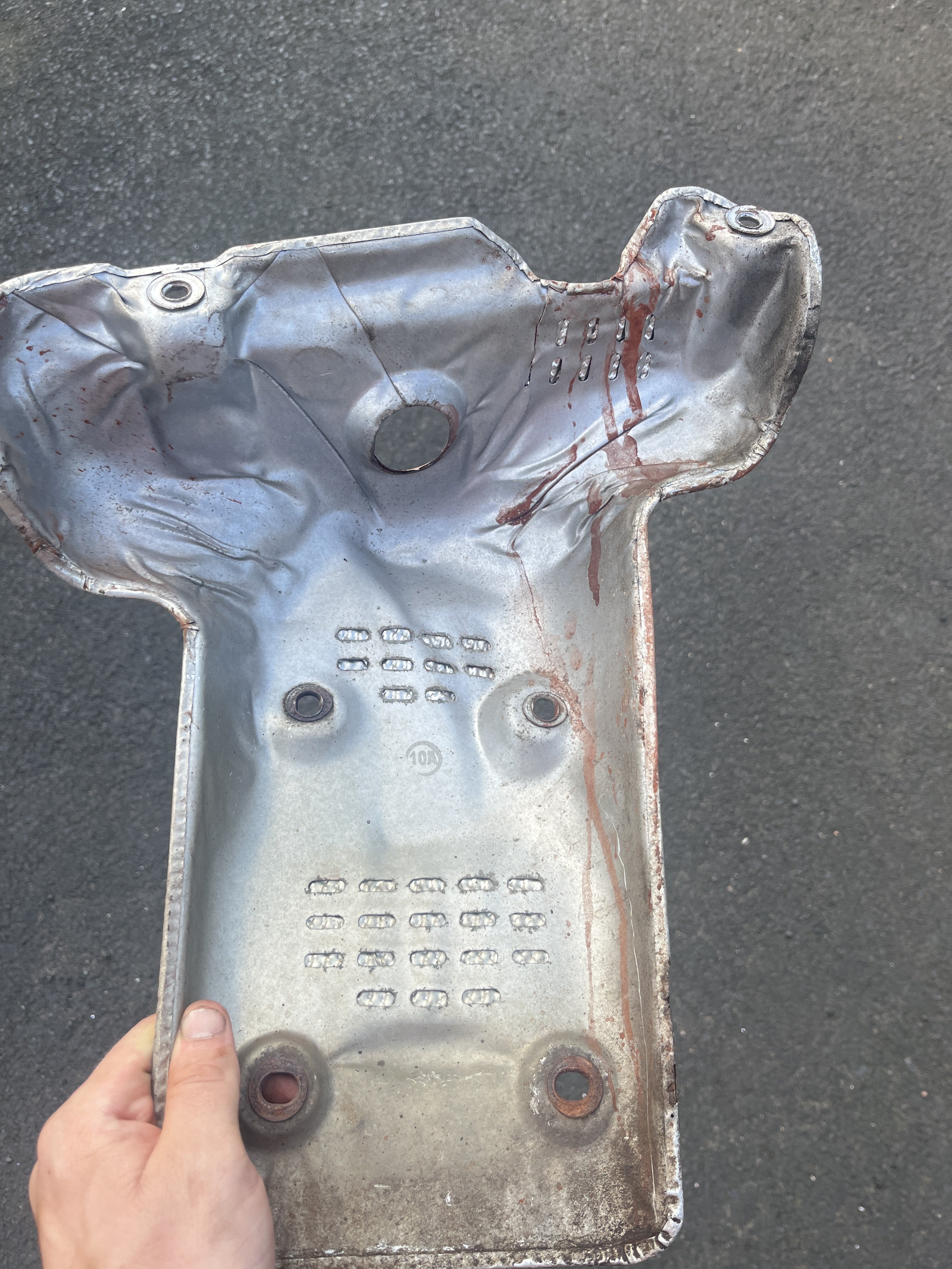

Thanks for the photo of the heat shield
It tells us quite a lot
looks like it's got an additive in the coolant
Looks like it's leaked from the top not from inside
Seeing it's gone over the exhaust it explains all the steam
