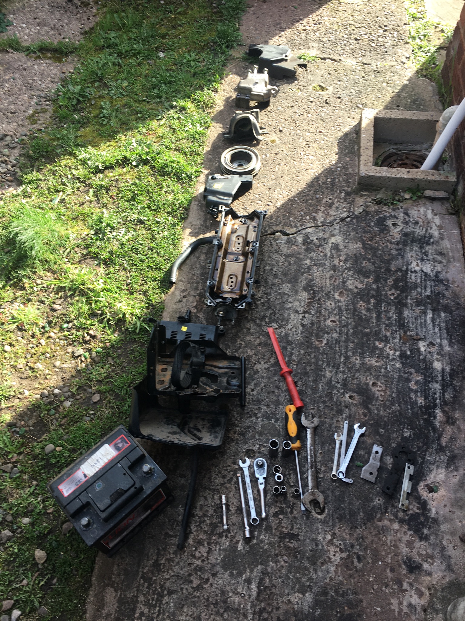

Not including a 510mm 1/2" ratchet
Or the block of wood and jack holding the engine up
These are the tools and parts needed to change the timing belt
Which is a long way into a head gasket change
The 10mm heads on the heat shield will probably be quite rusty, if they look bad I don't even attempt a 10mm, instead I hammer on a 3/8" (9.5mm)
If you have room to lay them down in order, it helps when reassembling, if you look at the engine mount you will see I have put the bolts back in the same place I took them out
This is lovely — I’m saving this picture and getting a marker and sandwich bags to keep screws together

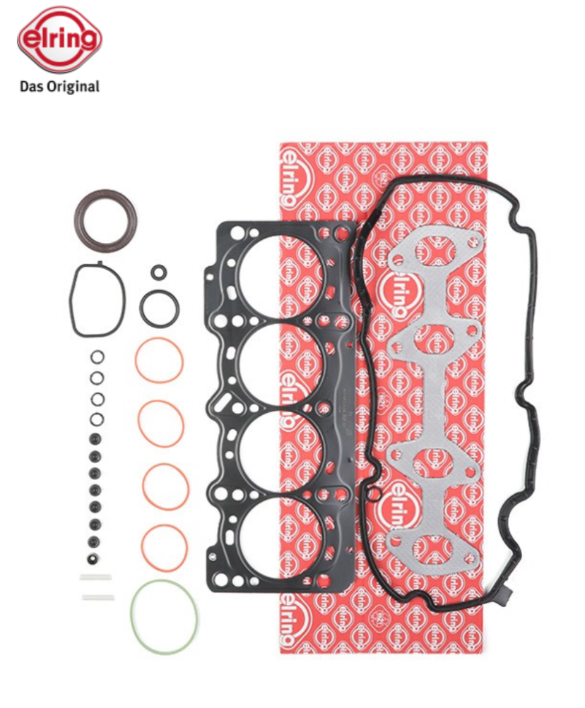

Also, the Haynes manual is telling me to put the HG on dry when replacing -- is that right?
No
The elring gasket comes coated with a special coating that's heat activated
The head and block has to be clean and dry, easier said than done as the VVT is full of oil that runs out as you tip the head around
All the rubber seals are just oiled
Except for the largest valve cover one, there's a high chance this will leak at the corners, I put a small bead of RTV at the sharp corner, there a thread on here somewhere probably Punto I will see if I can dig it out
The kit you linked comes with a new exhaust gasket, this is also fitted dry
traditional red rubber grease or more modern silicon grease. Nothing with a mineral oil base so never anything like ordinary grease or oil, not petroleum jelly either (Vaseline) as it's petroleum based which will degrade the rubber.
Oh hang on here, You talking about the O rings in the cam cover? They are designed for oil so a light smear of oil just to ease them into the groove. Sorry, something like the O ring on the metal water pipe where it fits in the back of the water pump would need a lubricant like silicon because it's not designed to tolerate oil and it's a very tight to fit.
Yup. head gaskets normally go on dry. In fact you may end up with it not sealing if you use a gasket cement. Some gaskets these days have a surface preparation which bonds with heat when the engine warms up to full temp
like should I use gasket sealant when replacing the manifold gaskets and HG?
Nope. Exhaust gets so hot it will burn normal sealants. Inlet gaskets are usually soft enough they deform slightly when the manifold is tightened down. Again, not normal to use sealants on head gaskets. In fact some inlet manifold gaskets and head gaskets have custom rubberized seals embedded around coolant galleries and adding sealant will interfere with these.
No
sorry koalar, I was composing the above as you made your reply. Glad to see we agree. Good point about the sealant in the corners of the cover seal, almost guaranteed to weep if you don't use a wee bit of sealant - not all way round, just in the corners.
Explained in link below
This is the picture from the link you posted, quite a lot of the seals on the left of the picture you won’t be using if you’re not doing a full recondition of the cylinder head. Things like the valve stem oil seals and some of those bigger seals are for the cam shaft so really you be mainly using the HG, the rocker cover gasket, the exhaust and the intake gaskets and seals you won’t need to worry too much about lubricating o-rings for what you’ll be doing.
