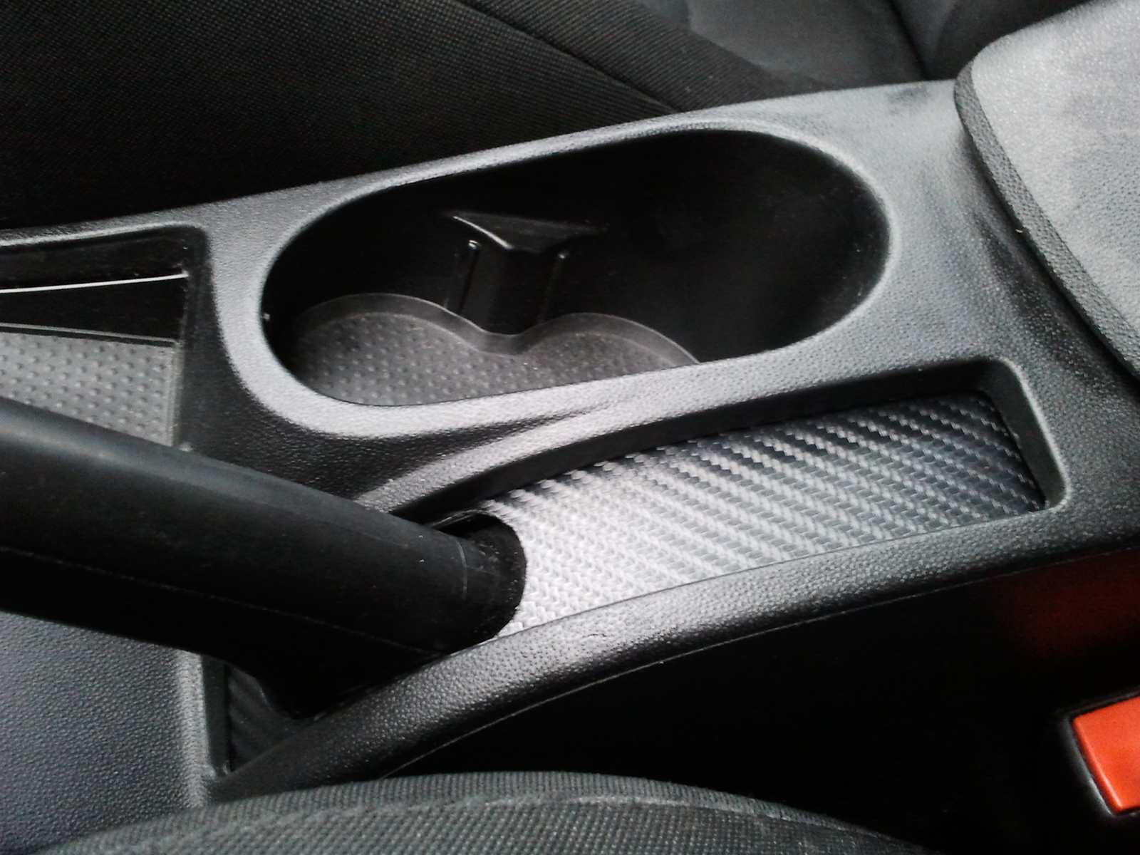

Small update as far as replacing broken plastic.
I managed to remove the plastic from the back of the center console (see the picture) so I have easier access to remove the broken plastic and I managed to find a small piece that broke off.
Of a thin flexible plastic and thick paper and using old plastic I made a new piece that I'm on both sides sticked with carbon wrap that looks attractive.
All that remains is mounting in the car and if I do it successfully will post pics to see how it looks.

I finally had time to replace the broken plastic (It took me about 3 minutes for installation as the new part was flexible enough for easy assembly) with new and I have to admit that it turned out fantastic. It looks so good that I should produce it and sell it on eBay ... :)
I think I would actually buy that.
It looks very nice. I would buy that!
I'm sure you could sell them (tho at a reasonable price... say 30-40 % of what Fiat is charging)
We would appreciate a description of what you did there .. on what did you stick the vinyl on?
