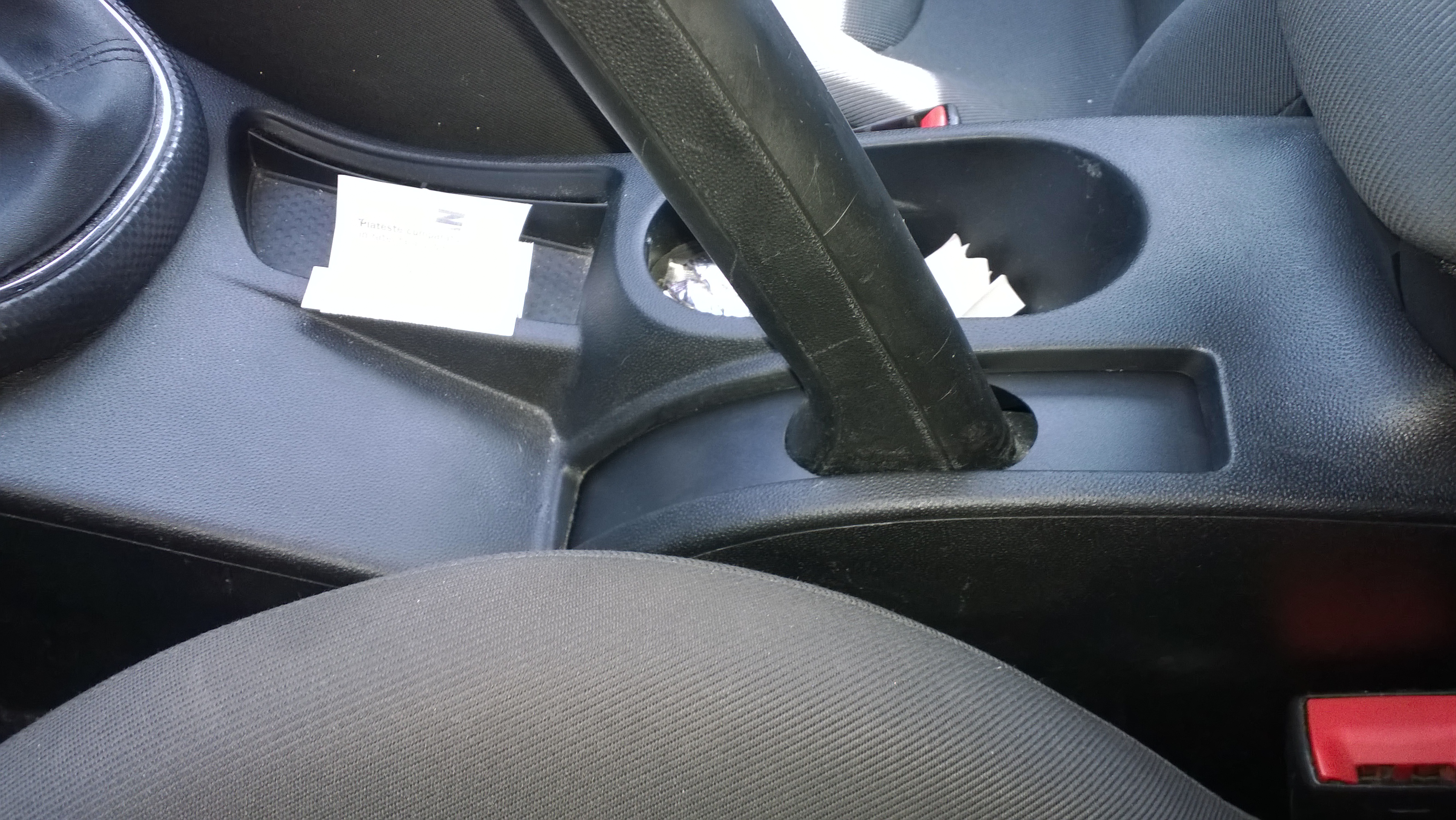

Mine busted and fiat want to charge me an arm & a leg over here to replace, if you were going to produce another one how much and would you post to Australia??
Even if you replace the plastic part it will break again because do you have to set the handbrake height to the right position otherwise it just breaks again at the same place.It costs 60€ in my country.The part with mechanics work included.I have to get it replaced it snapped on thursday and I arranged the meeting with the local Fiat mechanic for next week.
I knew mine had snapped when the wife got her finger in it as I pulled the hand break, she didn't half scream, what a mess it made of her finger :(
I would also like a carbon effect one :D
But thinking a strip of rubber for longevity . . .

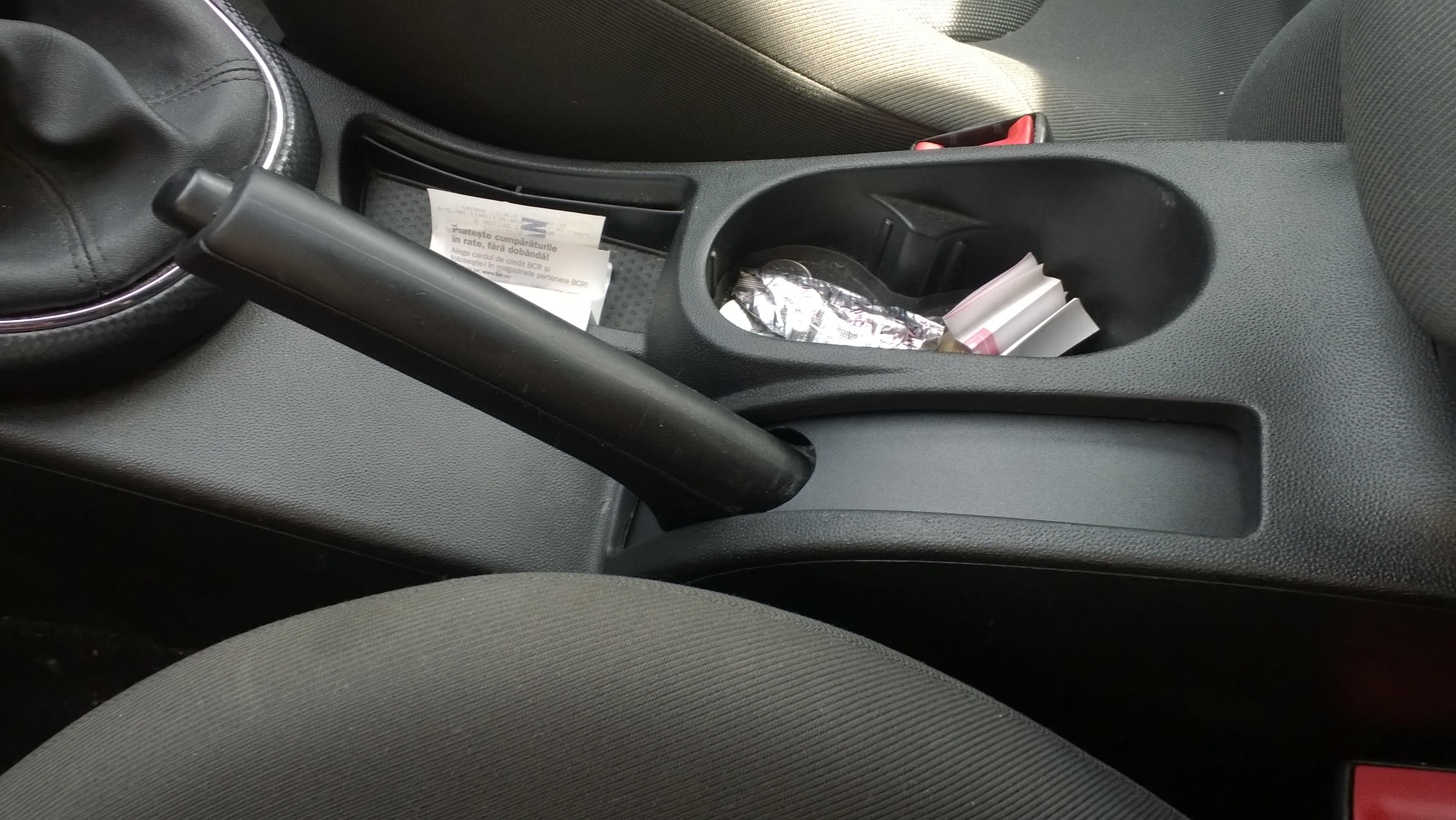

I finally had time to replace the broken plastic (It took me about 3 minutes for installation as the new part was flexible enough for easy assembly) with new and I have to admit that it turned out fantastic. It looks so good that I should produce it and sell it on eBay ... :)
What did you use to repair it? My 2008 Bravo has the same problem.

I used plastic folder for paper (because is flexible and hard) on which I stick carbon wrap and after year and a half still looks like new.

Well, I just asked fiat dealer to fix it as warranty claim and they replaced the complet console!!!! free of charge!!! This is why they have bad time...:bang:
Ițve replaced mine the other day with a piece of plastic i cut out from a folder.
I would genuinely buy that. I just noticed mine has broke.
How did you produce this mate?
I used plastic folder for paper (because is flexible and hard) on which I stick carbon wrap and it took me about 30 minutes to make it ...
I would like buy one to mine (broken) and replace it myself. Is this in eBay?
Simple pull out the broken plastic with little force and it will eventually pop up, then I used the old plastic as template for the new one. As material I've used thin flexible plastic on which I have glued carbon sticker too look more attractive.
