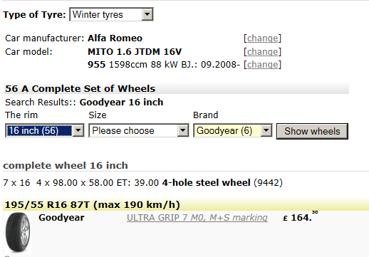

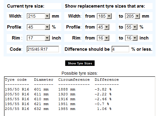

My OH's mito runs 215/45 x 17 the same as the GPA and the recommended winter tyre for it is 195/55 x 16. Assuming that the 16s will fit the GPA and you can get the insurance guys to accept this non standard tyre the 'saving' looking at lovetyres.co.uk is £138 (Conti) verus £92 (Ultragrip) per tyre (without rim) - these are on 'backorder'. So you will save nearly £200 with the 'smaller' tyre choice if you can get them.
http://lovetyres.com/tyre/Goodyear-UltraGrip-8/195-55-16
http://lovetyres.com/tyre/Continental-Winter-Contact-TS810/195-55-16
http://lovetyres.com/search/tyres/205-45-17/season/Winter
