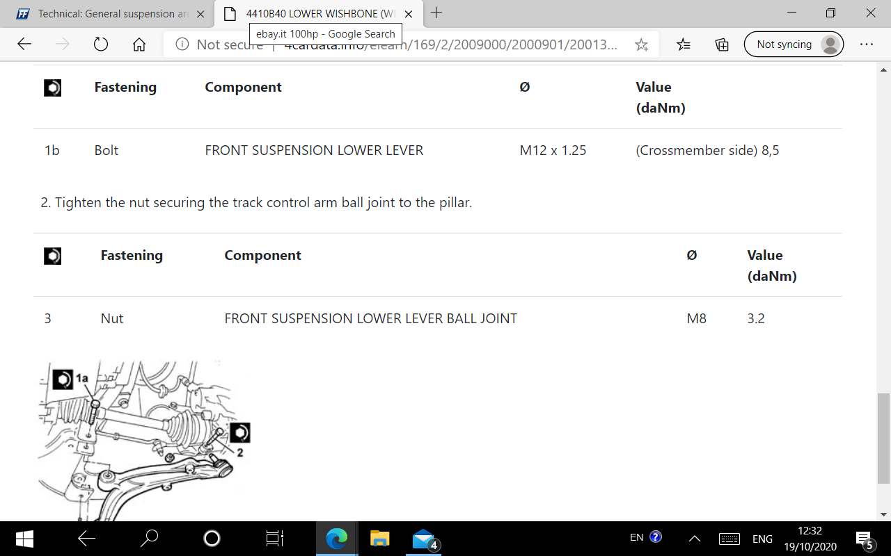

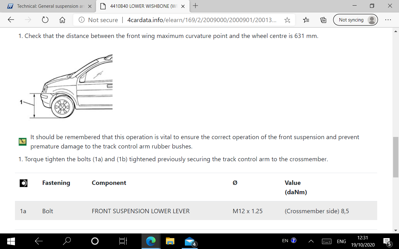

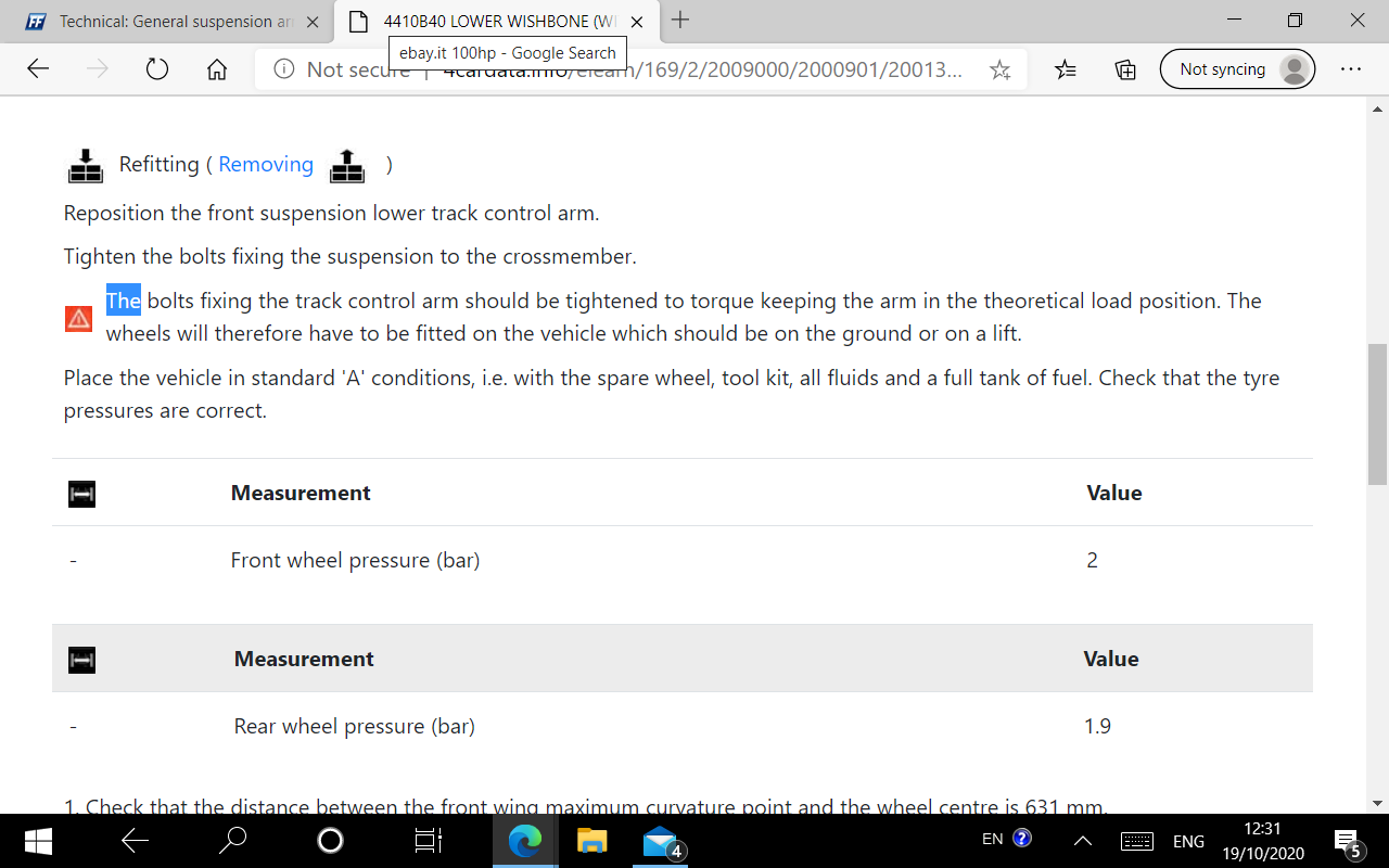

I always do the final tightening at normal ride height.

I fitted arms to both my panda and punto and they lasted well. But I didn’t buy them on eBay and tightened them at proper ride height.
"It should be remembered that this operation is vital to ensure the correct operation of the front suspension and prevent premature damage to the track control arm rubber bushes."
Would explain some of the failures.
