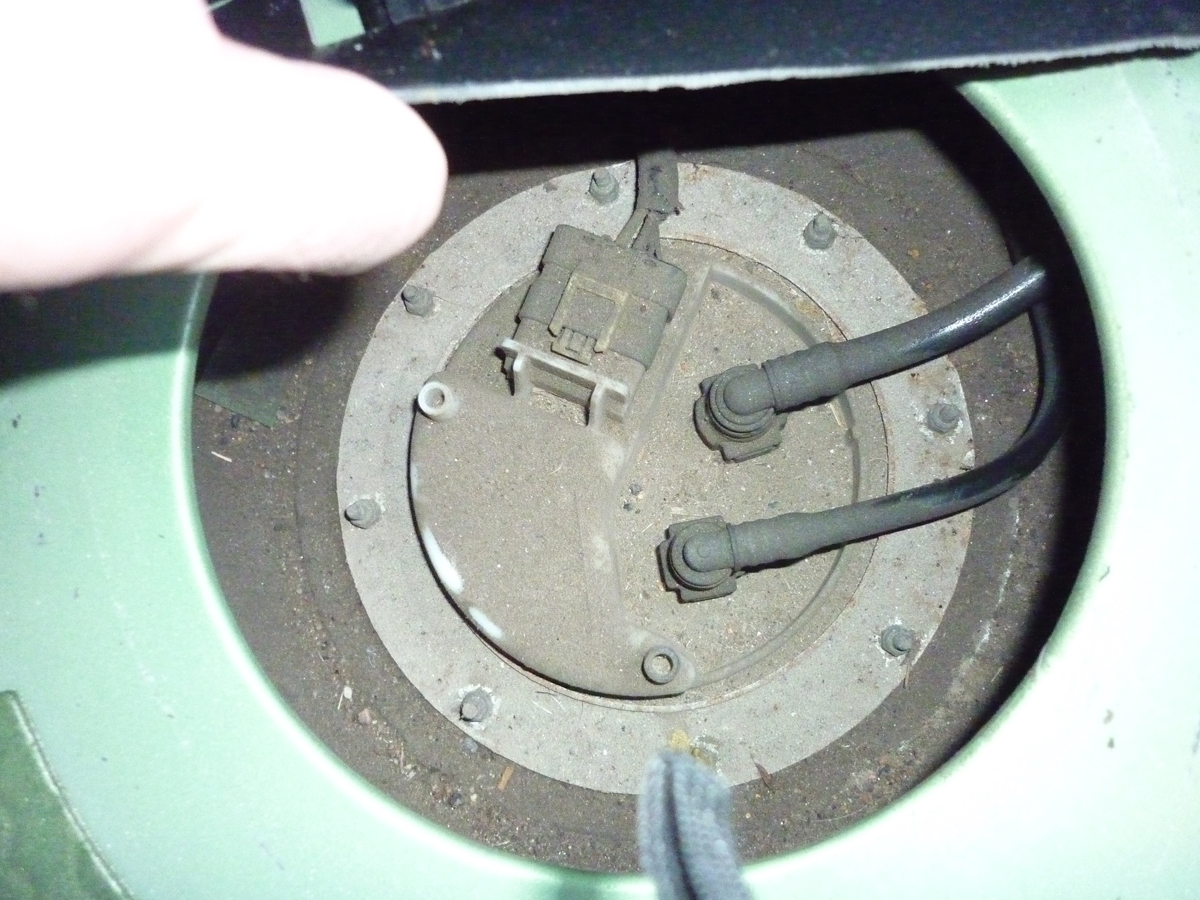

The LP fuel lift pump (under the seat) now sounds like a coffee grinder; actually this was evident before I turned the engine over - and hadn't been the case on Friday when I gave up trying to start. But then the rest of Friday and yesterday were well below 0c. - My 'guess' is the fuel is now badly gelled and it's not pumping 'liquid' (or possibly anything at all). And of course, despite the fact the engine now spins over like a mad thing, it still won't start!
I've tried gently warming the fuel filter and even the plate above the tank - but we're still in coffee grinder territory; and if the pump isn't dead (or fatally injured) already, carrying on like that will obviously do no good to anything...

So.... Opinions please. Do I cut to the chase now and just order up a new LP pump? Is it inevitably creme-crackered after this abuse? Or might it be OK once 'thawed'; anyone have any experience of this sort of situation?
Is there any sort of tutorial or instruction page out there on how to replace it (no I've not removed the cover plate yet to look); I have a pretty good set of car tools, but is there anything 'odd' needed to get it out and re-fit?
