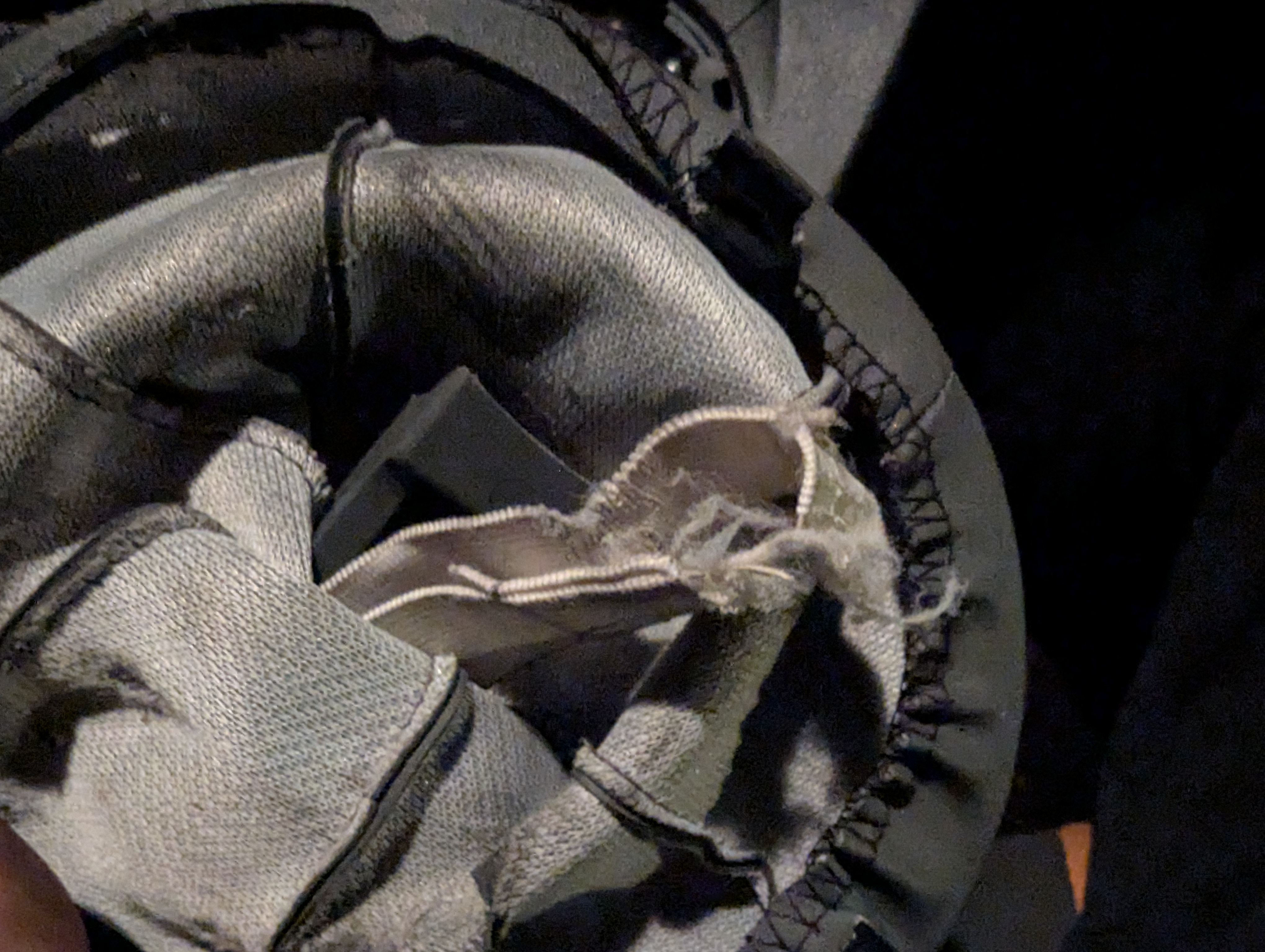

My elastic is torn (see photograph) should I try to sort that too? What should it attach to?View attachment 479754

The elastic does exactly the same job the spring does. Yours just had the elastic instead of spring, some are like that.
So no need to do anything about the elastic. Maybe cut it off, I'd say, so it wouldn't get caught there.

Mine has the cable tie and the clips (one of which is broken of course, grrr) but the elastic looks like it's supposed to do something...
