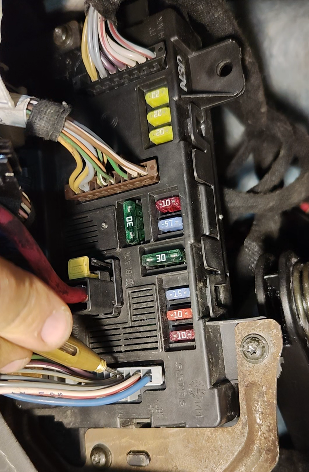

I guess the first check is a visual inspection on the body computer
See if I can find a photograph
Above the accelerator pedal
Hard to see

F31 supplies the reversing bulb, if it's gone I would expect a few other things not to be working

All go through F31
To the right of the steering column, behind a plastic cover
5th one down including any blank spaces
5A

Except for needing to change the resistor so the fan works on 1,2.3 Everything is working as it should. Honestly don’t know how we missed that one fuse. Thank you so much for your help!

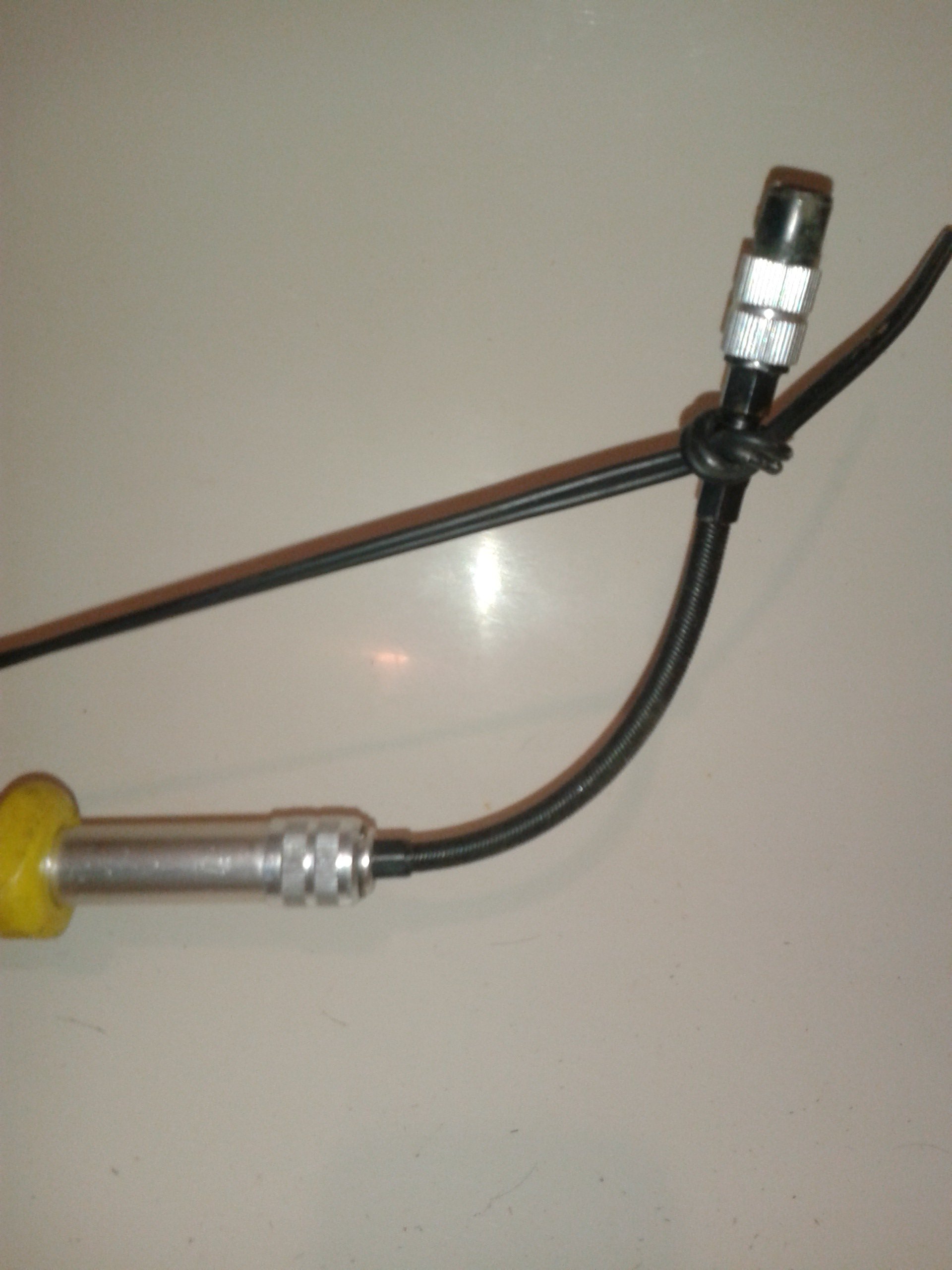

Look at my old posts, I will look it up when you come to do it, if you haven't found it
With a Flexi drive and a piece of string it's easy to change 5 minutes, nothing else needs to come out
Otherwise you have mess around upside down, swearing a lot
Found it, here's what I used
I believe it's 5.5 mm if I remember correctly
