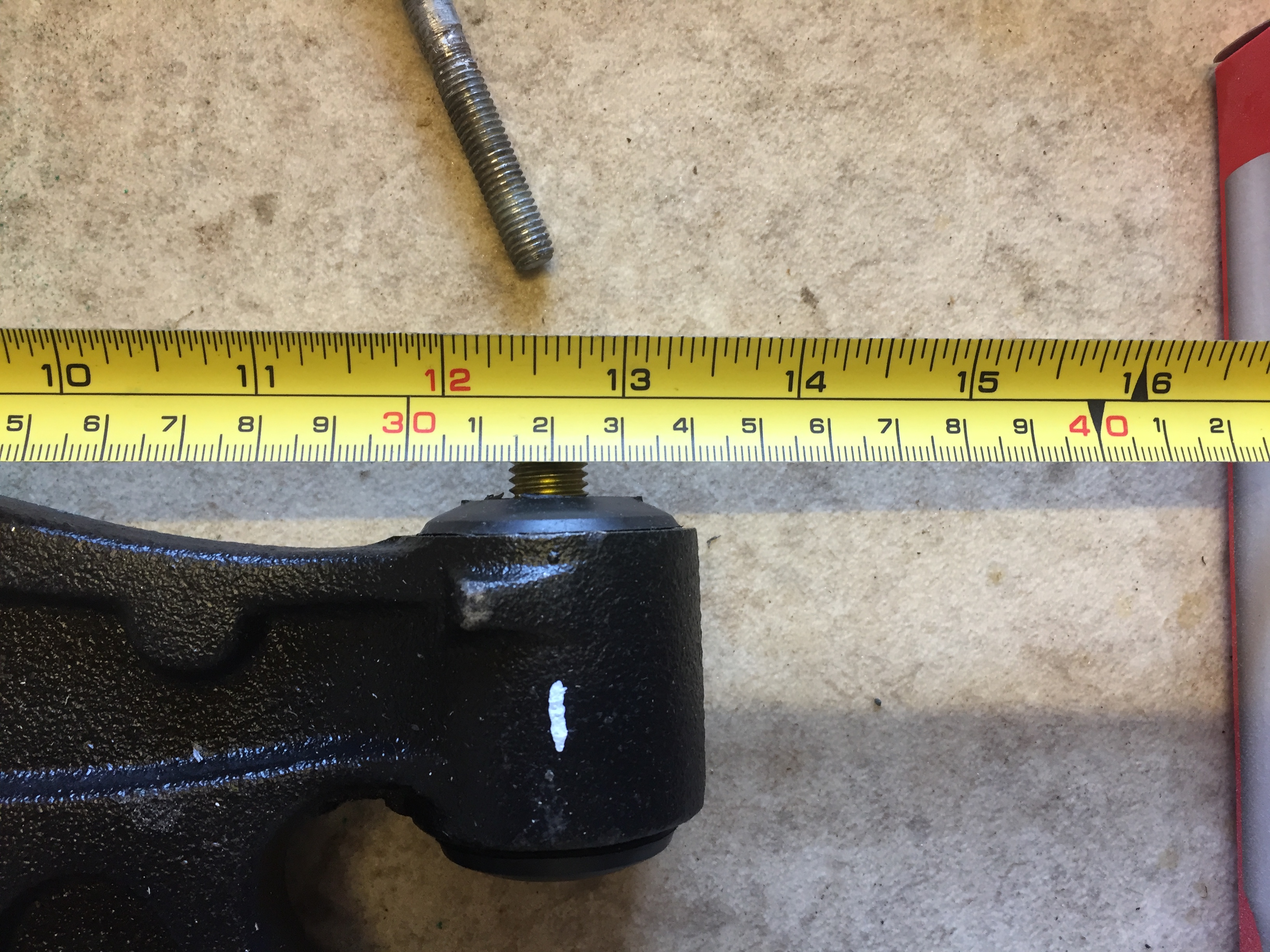

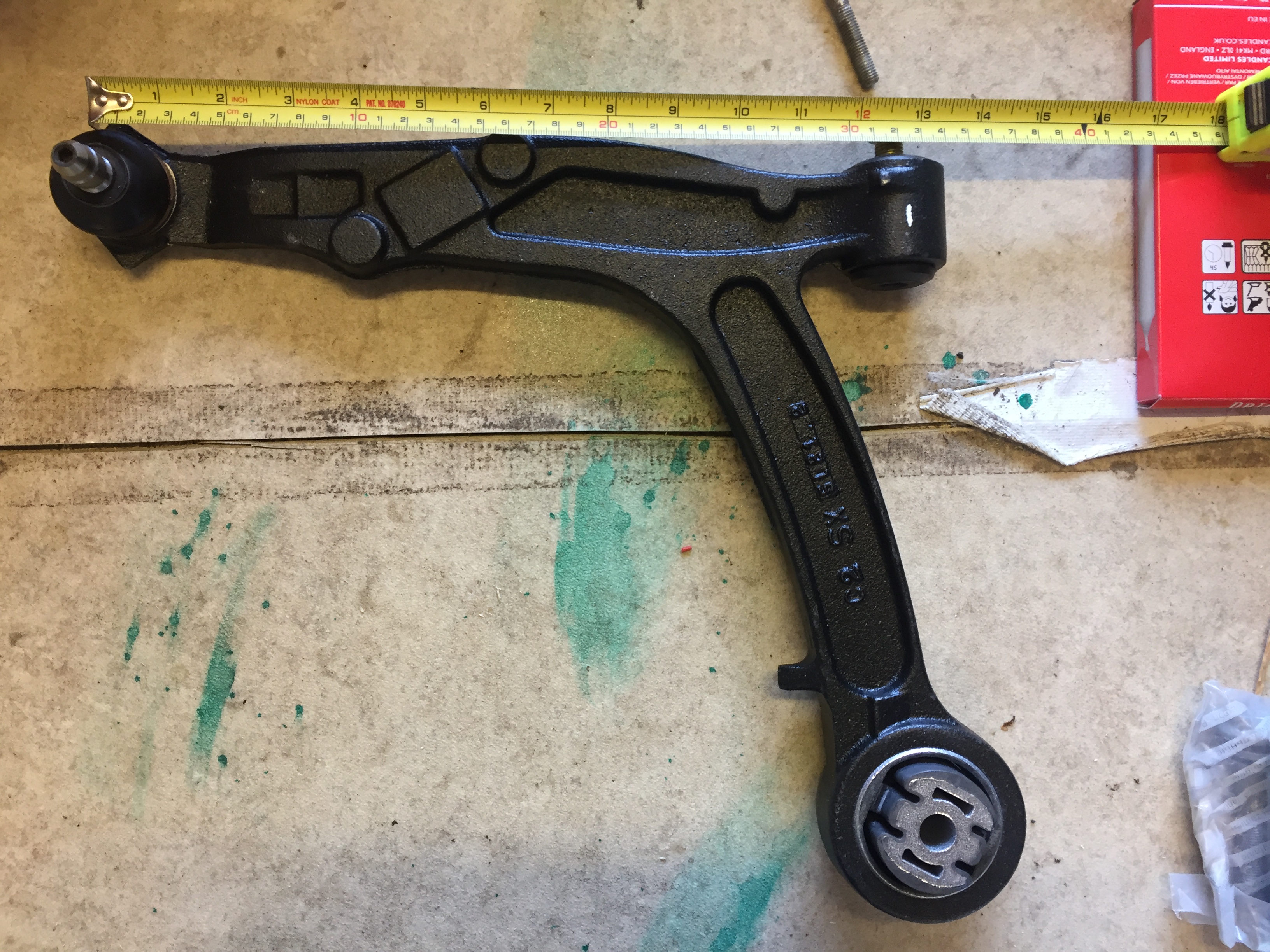

I think there’s quite a bit of assumption going on in this thread.
Picture of a Magneti Marelli front arm for a 100hp. Pin on the balljoint is set vertical for measurement.
If changing the bushes, make sure the balljoint is good - most aren’t.

Ok. Having checked with several people who have spare lower arms at hand, they are definitely not all the same. If you are changing for a different part number it’s essential you check both parts side by side for length between bush and balljoint and also confirm the balljoint pin is the same size.

How much difference are we talking? What are the part numbers of the magneti marelli 100hp arms to confirm these are definitely correct?
