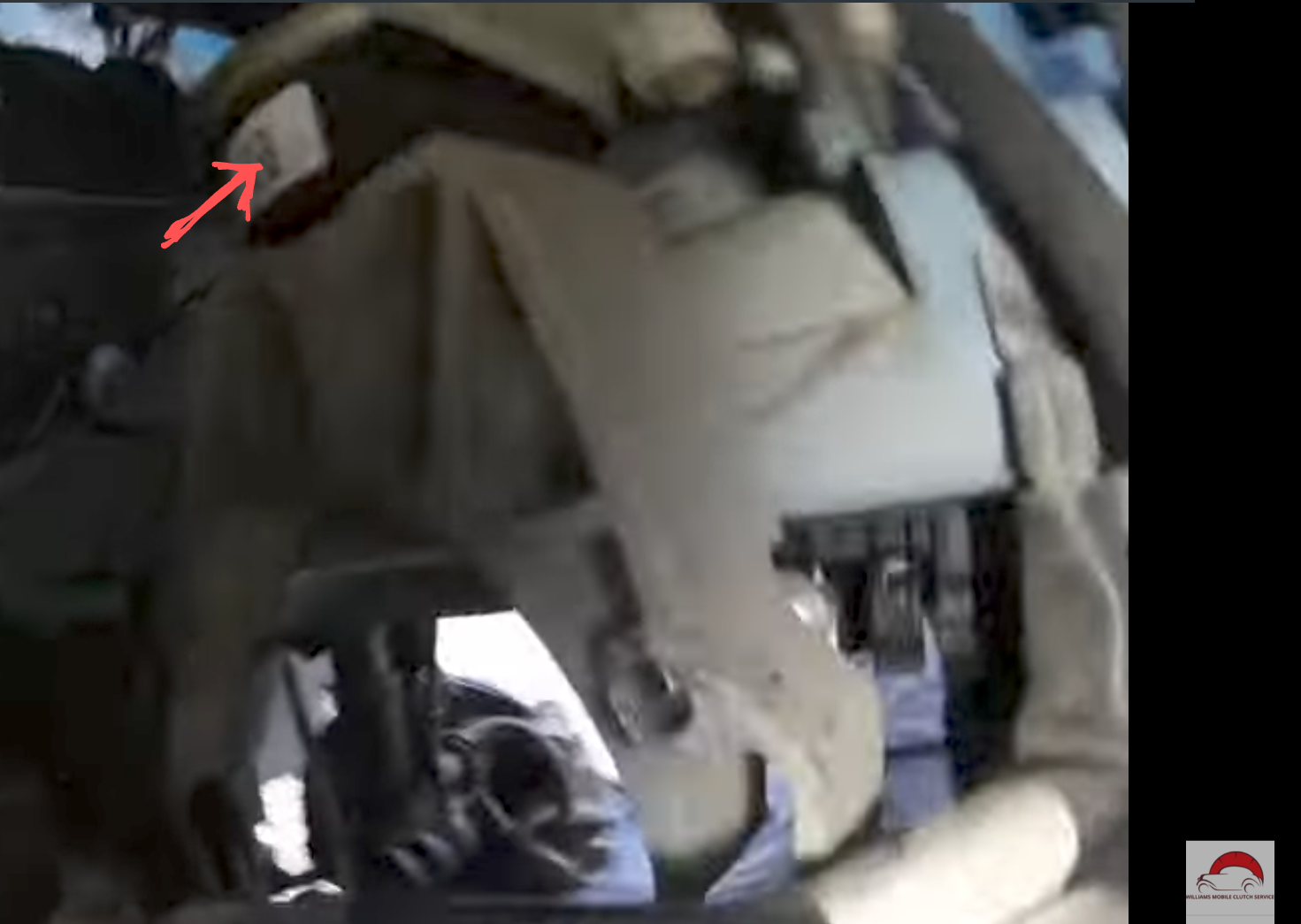

Ps is the gearbox mount underneath the gearbox
Its directly on top of the gearbox,
Picture is from a 500 but it near enough the same
