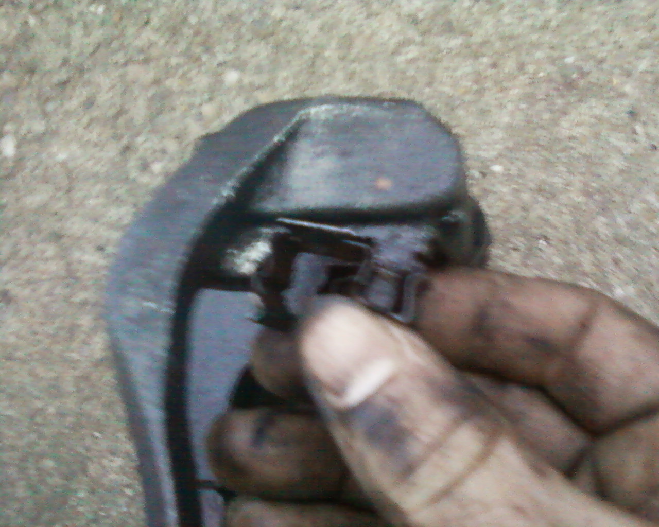

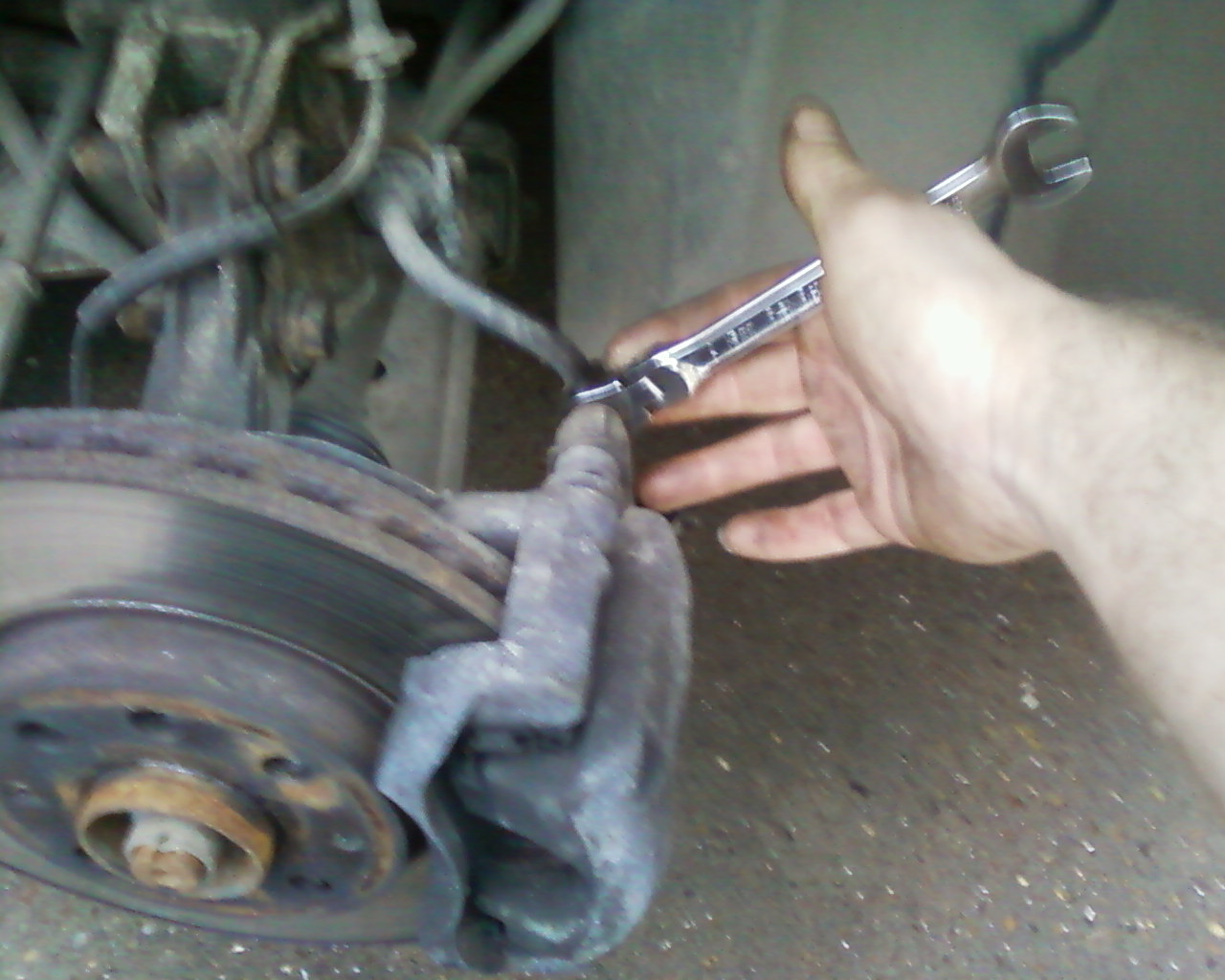

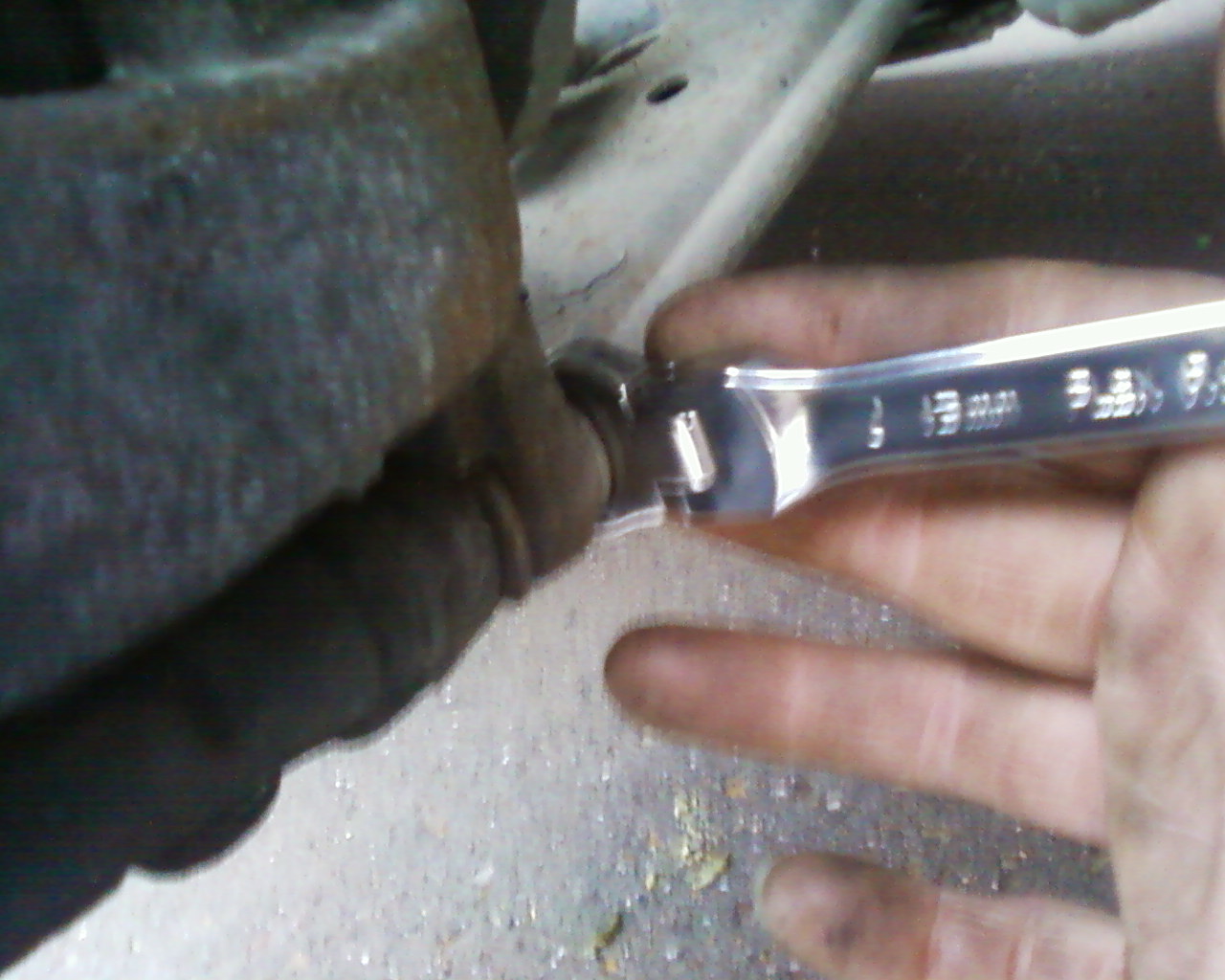

remove the caliper piston body using a 13mm spanner as in the above guide and the pads (if your new pads come with clips look how the old pad spring clips fit as they only fit on one way)

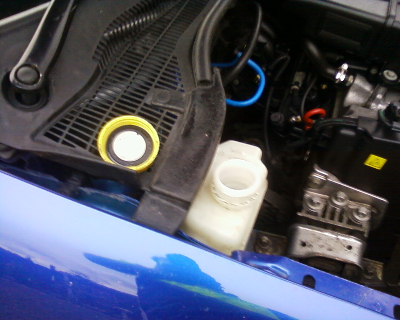

clean then remove the brake fluid cap off the header tank
((DO NOT SPILL ANY FLUID ON YOUR PAINTWORK OR IT WILL REMOVE IT))

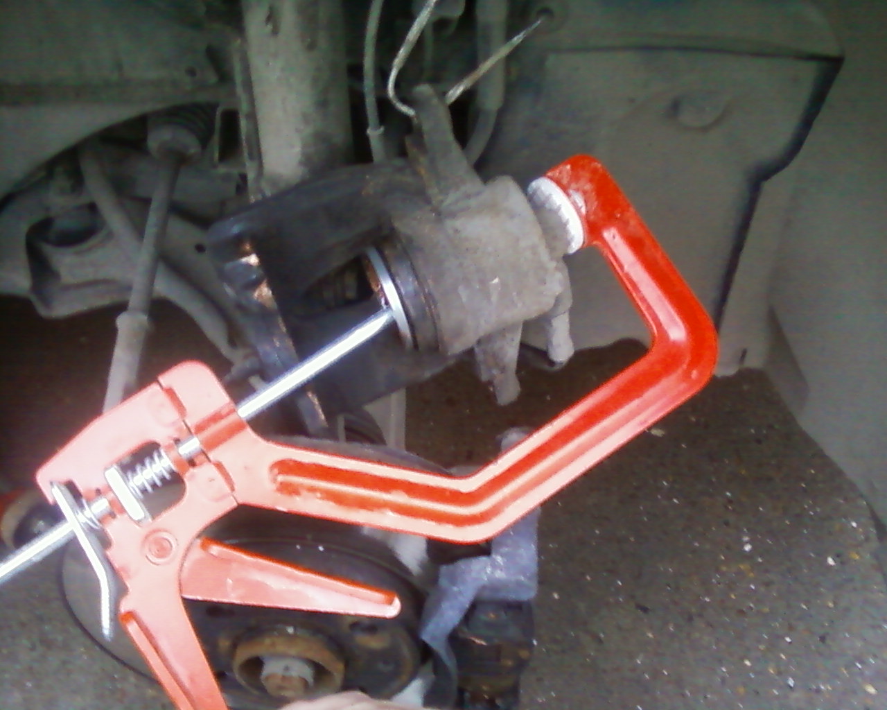

next reset the piston ensuring you do not damage the rubber piston seal boot

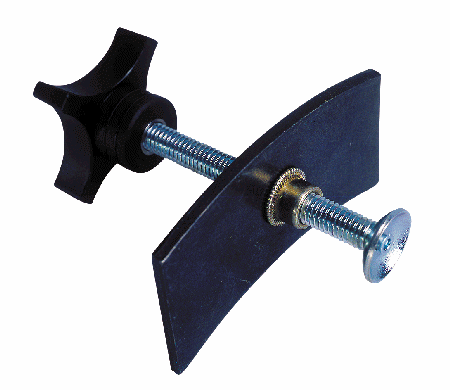

i used a g clamp but you can get a special tool to do this from most motor factors
do this slowly to give the fluid chance to move back without putting any undue pressure on the seals

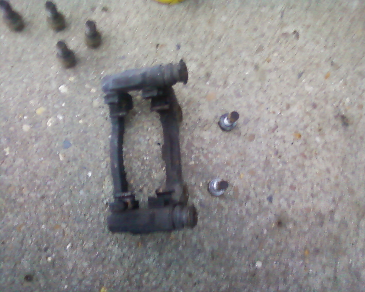

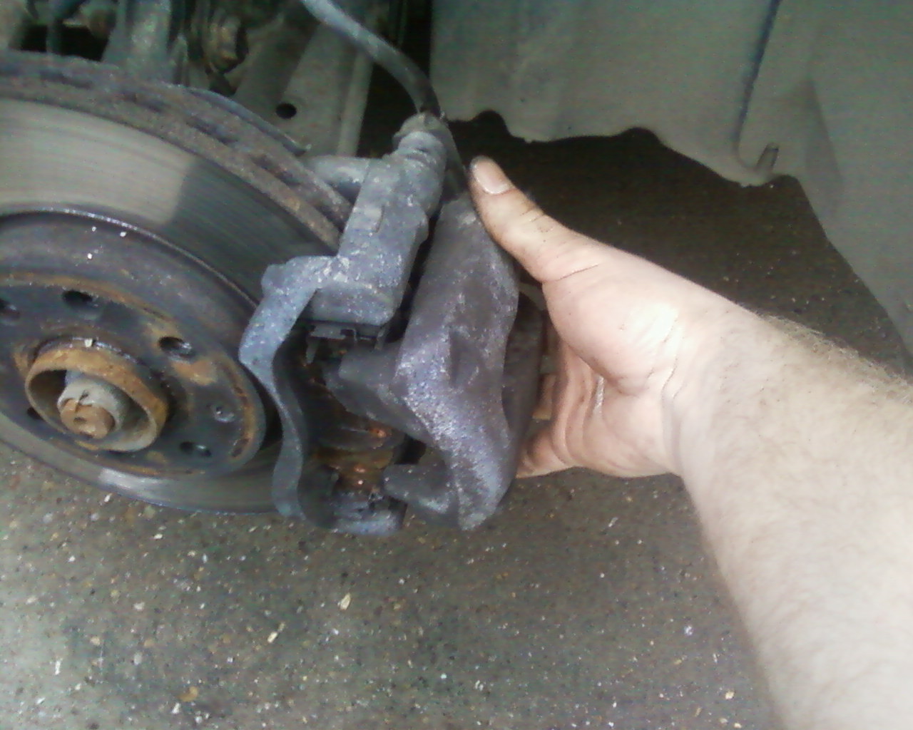

you need to undo the caliper carrier using a 19mm socket and remove the 2x bolts
so this bit comes off

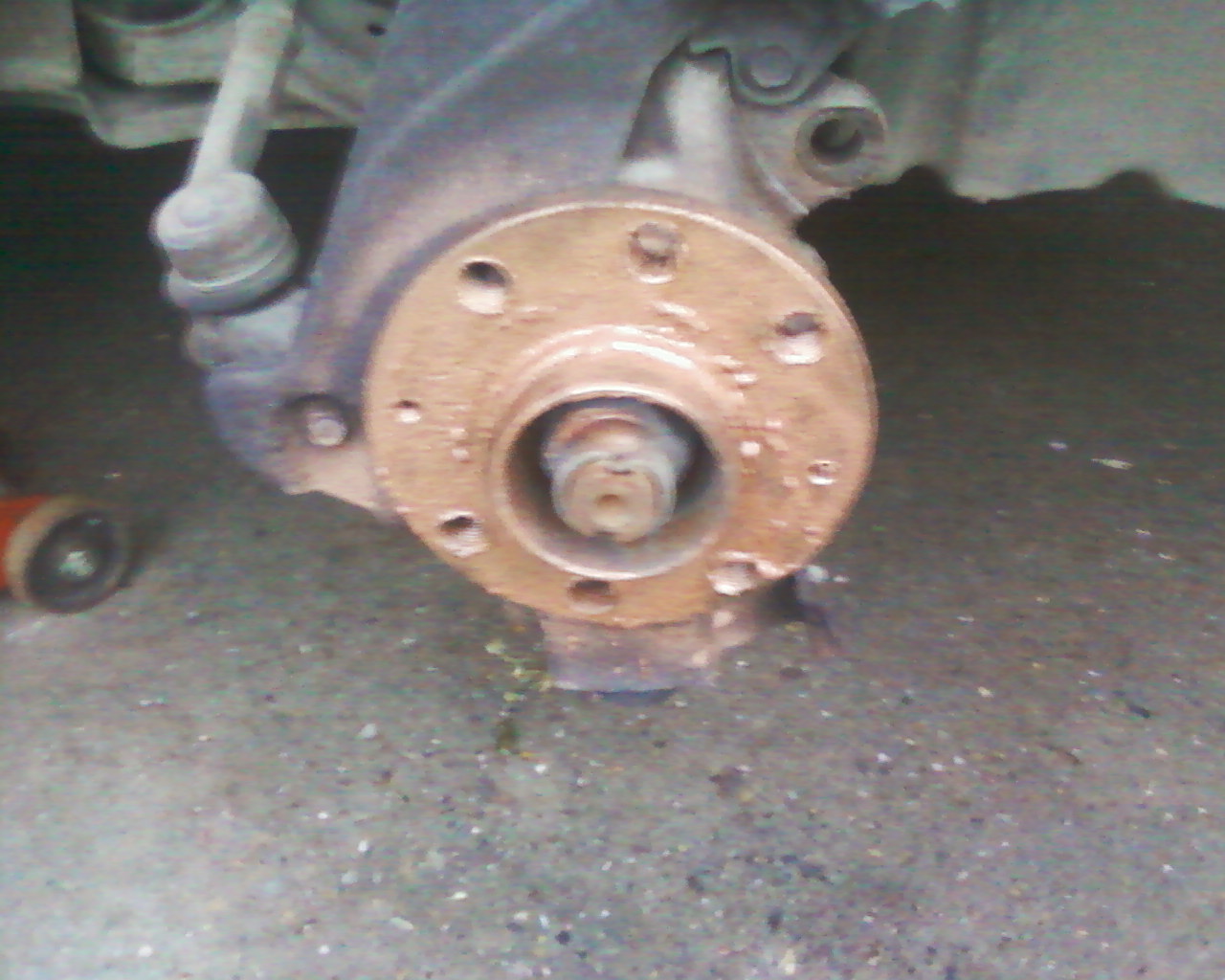

now you can get the disc off

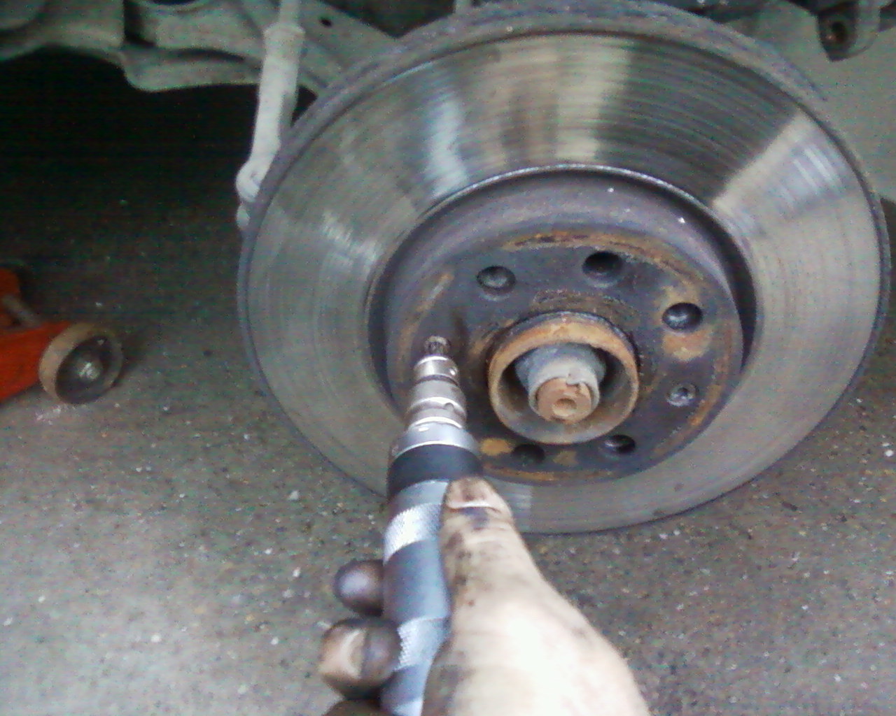

using a T30 Torx bit undo the 2 torx aligning bolts these are commonly seized in so a bit of release oil might help and in my case a hammer and impact driver
once both are removed either the disc will drop off with a slight pull or need braying round the edge with a hammer to crack any corrosion
clean the stub axle up and coat with copper grease (makes changing them next time easier)

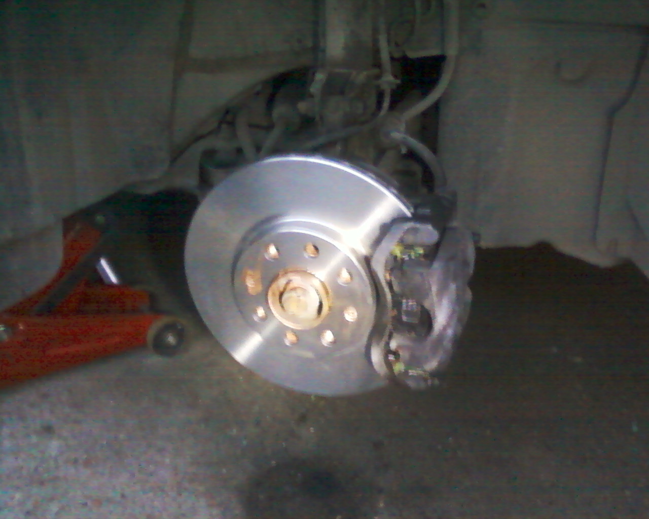

ultimately you will be left with this
19mm caliper across flat carrier bolts Torque 9.9 ÷ 11.0 (daNm)
13mm across flats caliper bolts torque to 2.7 ÷ 3.3 (daNm)
T30 torx bolts torque 0.9 ÷ 1.4 (daNm)
