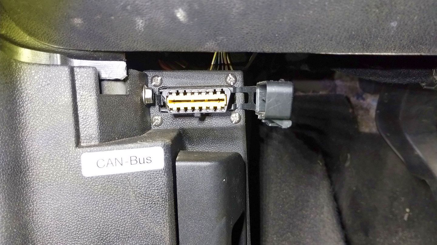

Get to the point "mate". New location is the front, driver's side pillar, "kick panel", just above the hood/bonnet handle. There is a perfect spot, rectangular.
Port needs some reinforcement, you can't just put it into the plastic panel. Use old bracket as a template to cut (drill, file) the new piece of steel sheet (picture).
Must be thinner than original (otherwise OBD port won't fit, will not "click" into place), about 0,5-1,0 mm thickness will be OK. This new mount must be secured to the plastic panel using 4 small bolts (M3 or M4 max.). Tap through the plastic+metal, nuts are just addition (there is not enough room to put all 4 nuts, only 2 or 3 will fit).
There is one small problem. Now, the OBD2 port will obstruct the way to the screw. Original is a phillips. Replace with allen or hex. And shorter one.
But the interface will fit, no problem (regardless of what type of screw is there - and how it was installed). Now you can Diagnose a car.
Screw swapped (now it's a hex head, easy to undo with a small spanner wrench, this one is 7 or 8 mm).
Tip: place the screw into the panel's hole first and then install the OBD port in the panel. Order of operations.
Obviously the length of the wires is sufficient, you can move the port around in that area, no worries.
Nice touch, final touch-up: add some sticker, tag ("OBD" or "CAN"), so maybe someone will spot the port before he rips the panel out (and it's second clip).
Easy mod., nothing to write home about. But makes a difference.
