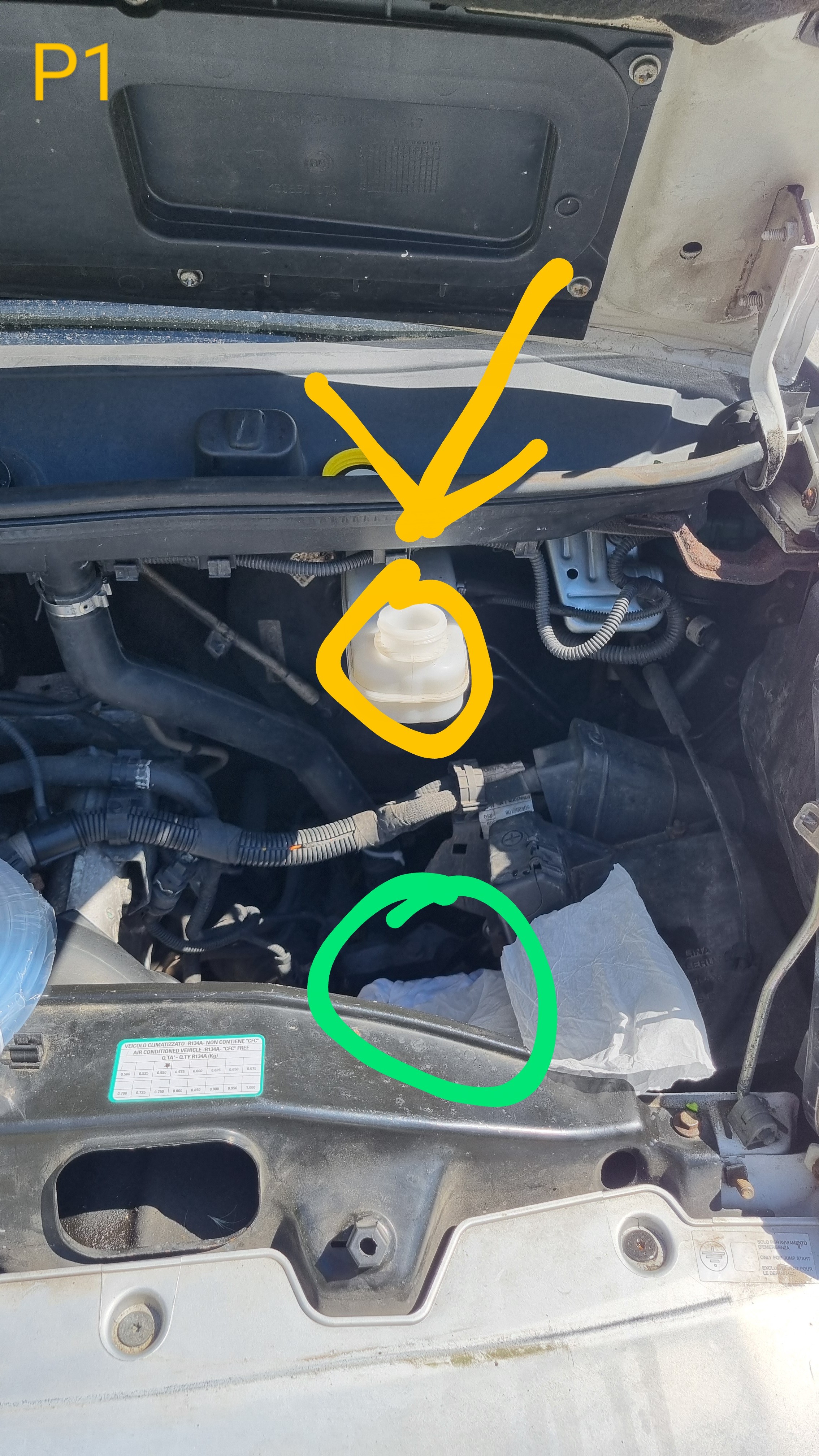

P1:
Yellow arrow. Brake fluid container(booth clutch and breaks on my model). Empty this container of any old fluid with a syrringe or a clean tube. Refill to max with new clean fluid.
Green circle. Remove air filter for better visibility. Cover with a clean rag to avoid dropping parts into the system.
