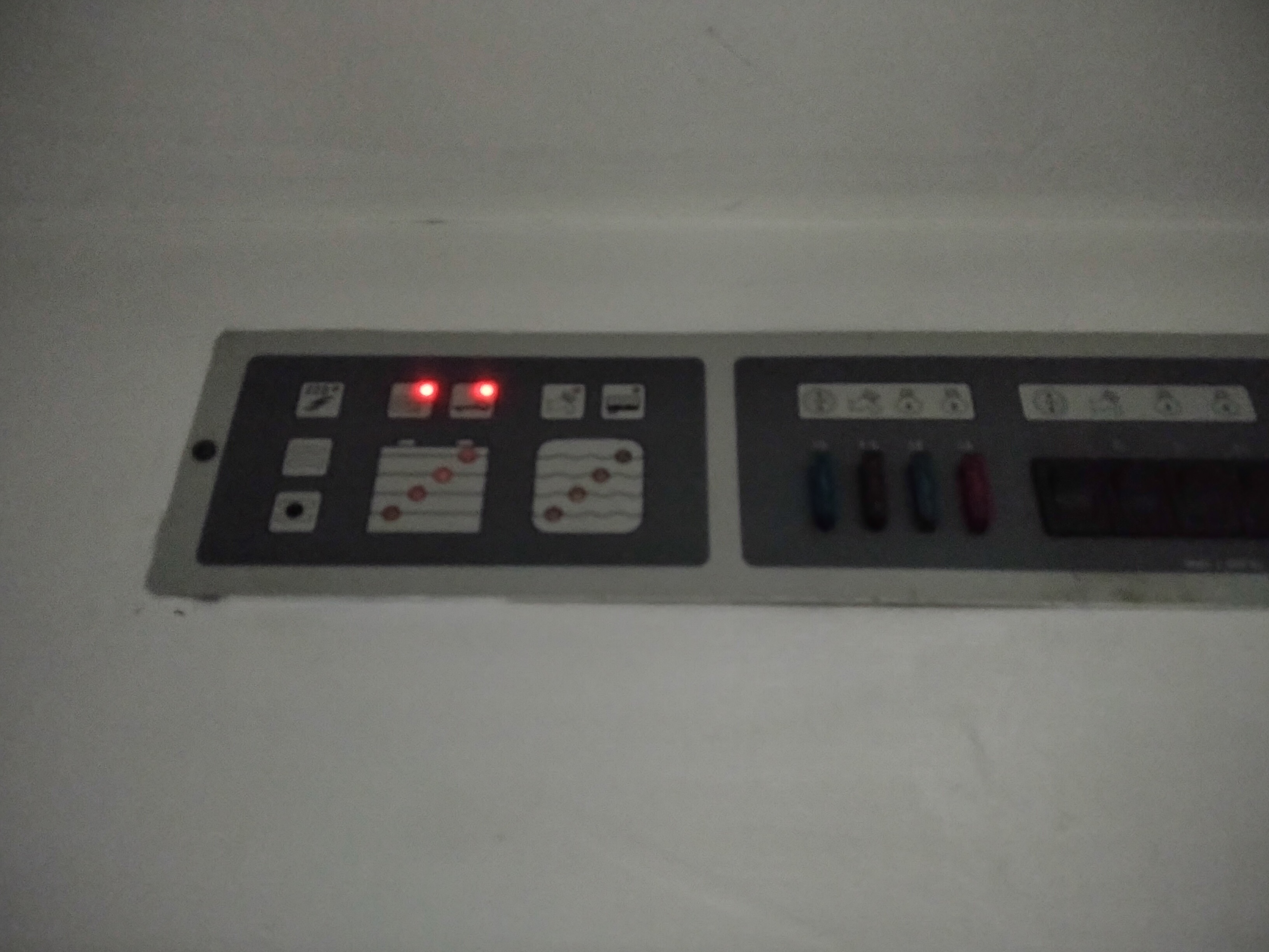

I am also getting an error on the board for my leisure battery, so does this suggest the issue is electrical after all? I was planning to shut down all the leisure battery connections on Friday too.

The habitation (leisure) battery is probably suffering from lack of charge, unless the vehicle has solar panels, or is on Electrical Hook Up (EHU).
When the engine is not running, there should be no connection between the two systems.
