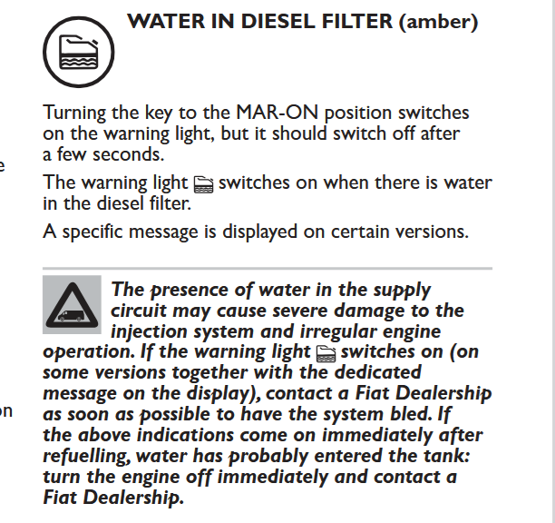

Is there something on the OBD2 that would show that water has entered where it shouldn't?
Not really, unless it can show inbalance between engine cylinders.
