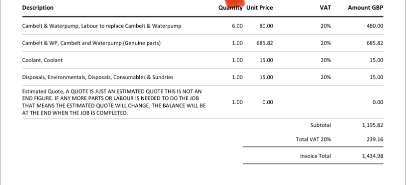

I’ve attached the breakdown. Total is £1434.98

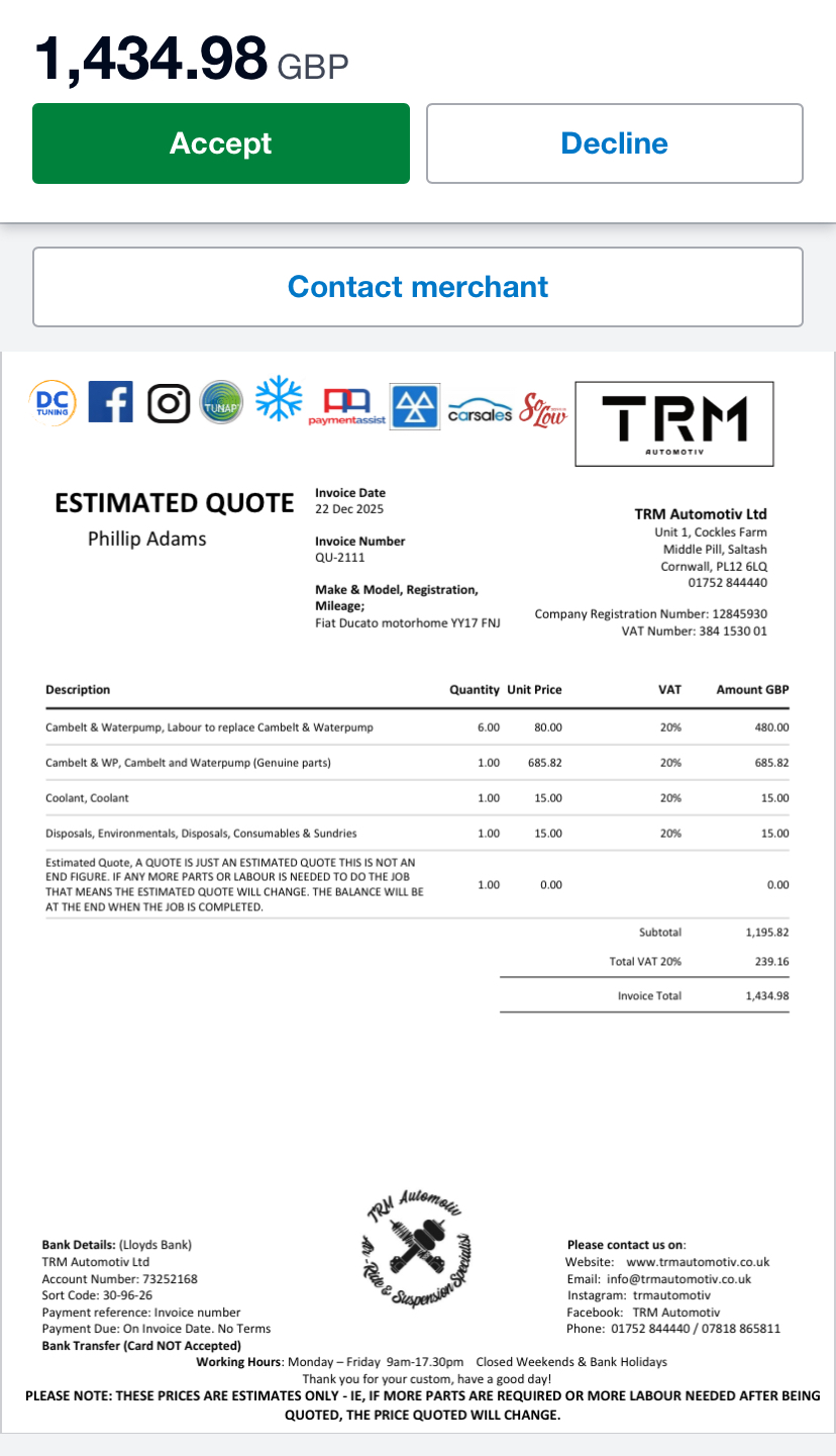

It’s a standard camper van rated at under 3.5 t. Anyway I’ve attached the complete quote form

£685 plus vat for belt and water pump (not even including tensioner) looks excessive.
You would get proper idea of actual cost by asking fiat dealer yourself or shop4parts.
I wouldn't get parts from fiat but would rather get a kit from the company who makes the parts for fiat or kit recommended by shop for parts

However I'd agree the parts are loaded even compared with retail prices and decent slack in labour hours.
The quote is clearly stated as such with the usual but if it's more.. No information on warranty or rebate for labour hours.
Canny Scotsman, but charging £18 for coolant 🤬 and twice for 'Disposals' and consumables🤬🤬.
Get another quote.
If there's a reason to use the garage so be it, but I think the "estimated quote" gives Indies a bad name.
