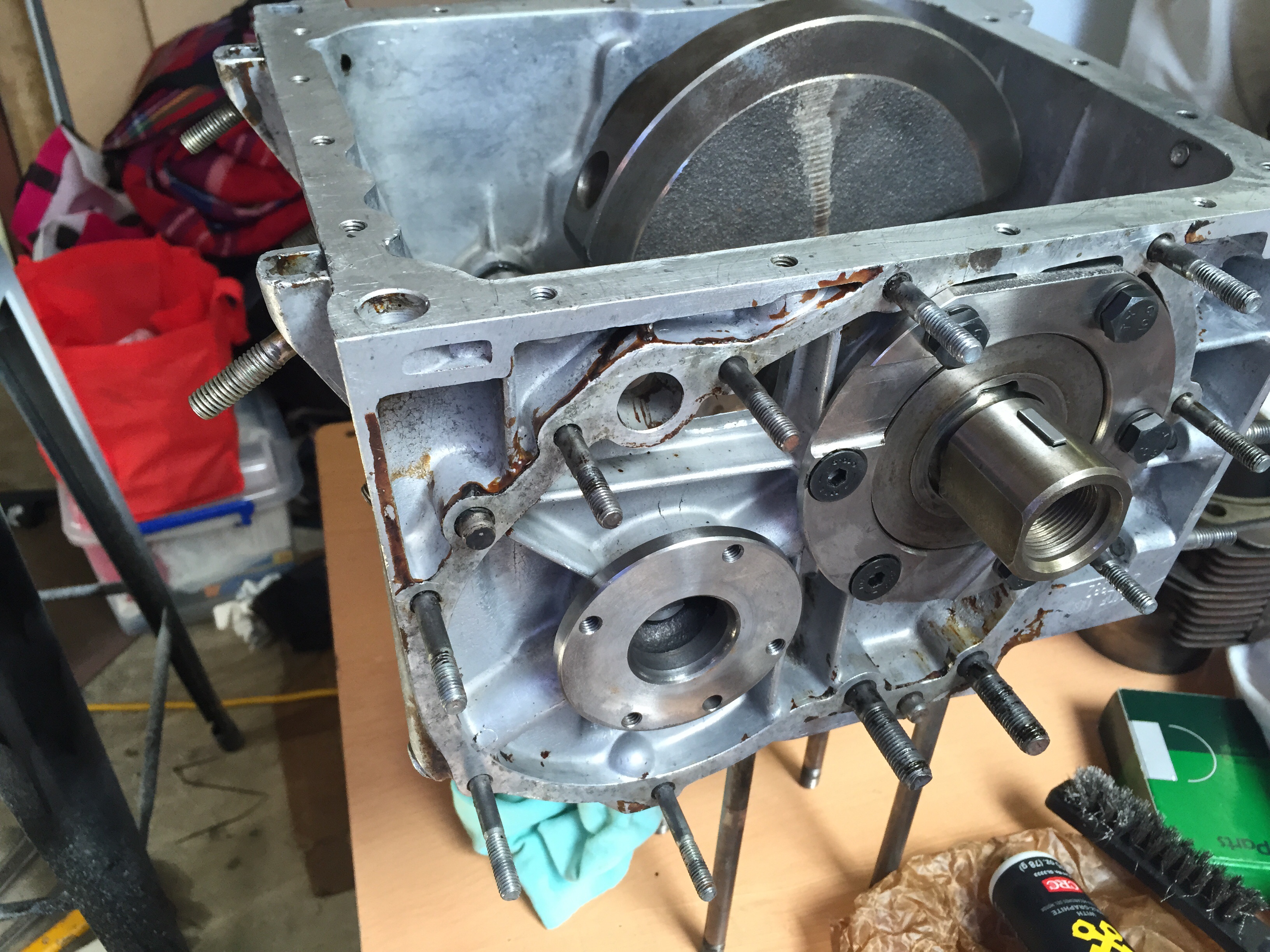

Messy oil way
Thanks, really good set of pictures---as you are using a 500 crankcase, don't forget, you must use a 500 oil-pump, not a 126 version, and don't forget to pack the oil-pump with Vaseline (you know, just like the rich girls use!) prior to installing it in the timing-case.
Thanks
Following your advice on other posts re oil pumps I have packed it with Vaseline , and am using the 500 pump with new gears. (I carefully chose the new gears from the options available at fdricambi, being the ones with shallower gear depth but large dog gear to fit the new 650 camshaft.)
I went to fit the timing cover and the gasket had shrunk, and I very carefully - tore it.:bang:
Need to order another.
I did however get the rocker gear on and tappets adjusted today, and thanks to telemike who had a box of engine bits stashed away I also got a couple of tab washers for the timing gear to camshaft so that is all good now.

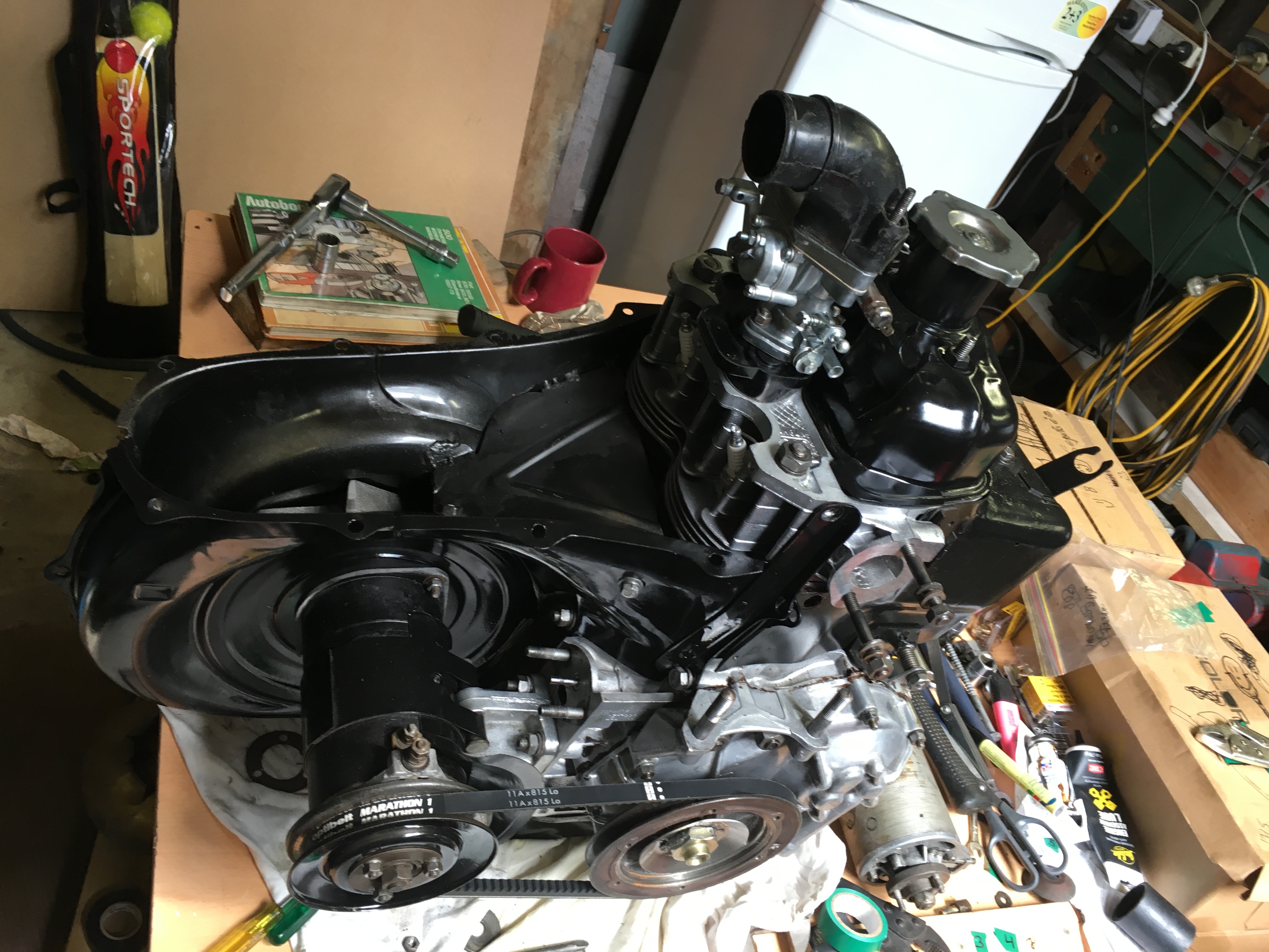

Have done a few bits and pieces on the engine. Getting closer now...
One of my daughters came out in her overalls to work on the car this afternoon so I got her to put the carburettor on

Good on you, getting them involved. The engine pics, which I only just saw, are outstanding.
Thanks re the pictures. I liked seeing other peoples rebuild threads with photos before I took this on. The workshop manuals are good but the clarity of some pics is not great so I went a bit overboard, but glad I did.
I am going to try and get the kids to bolt the rest of the small things on such as fuel pump and fan cowling etc.

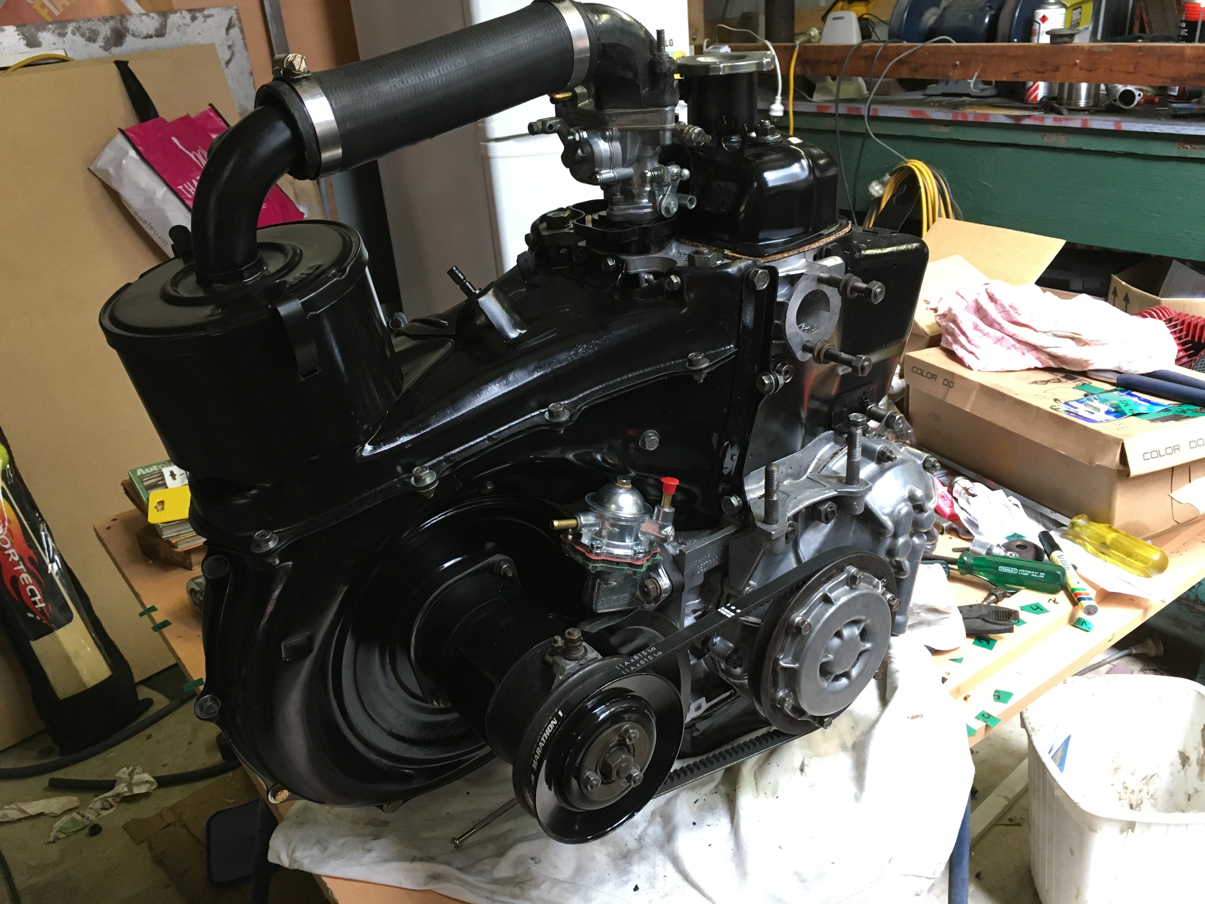

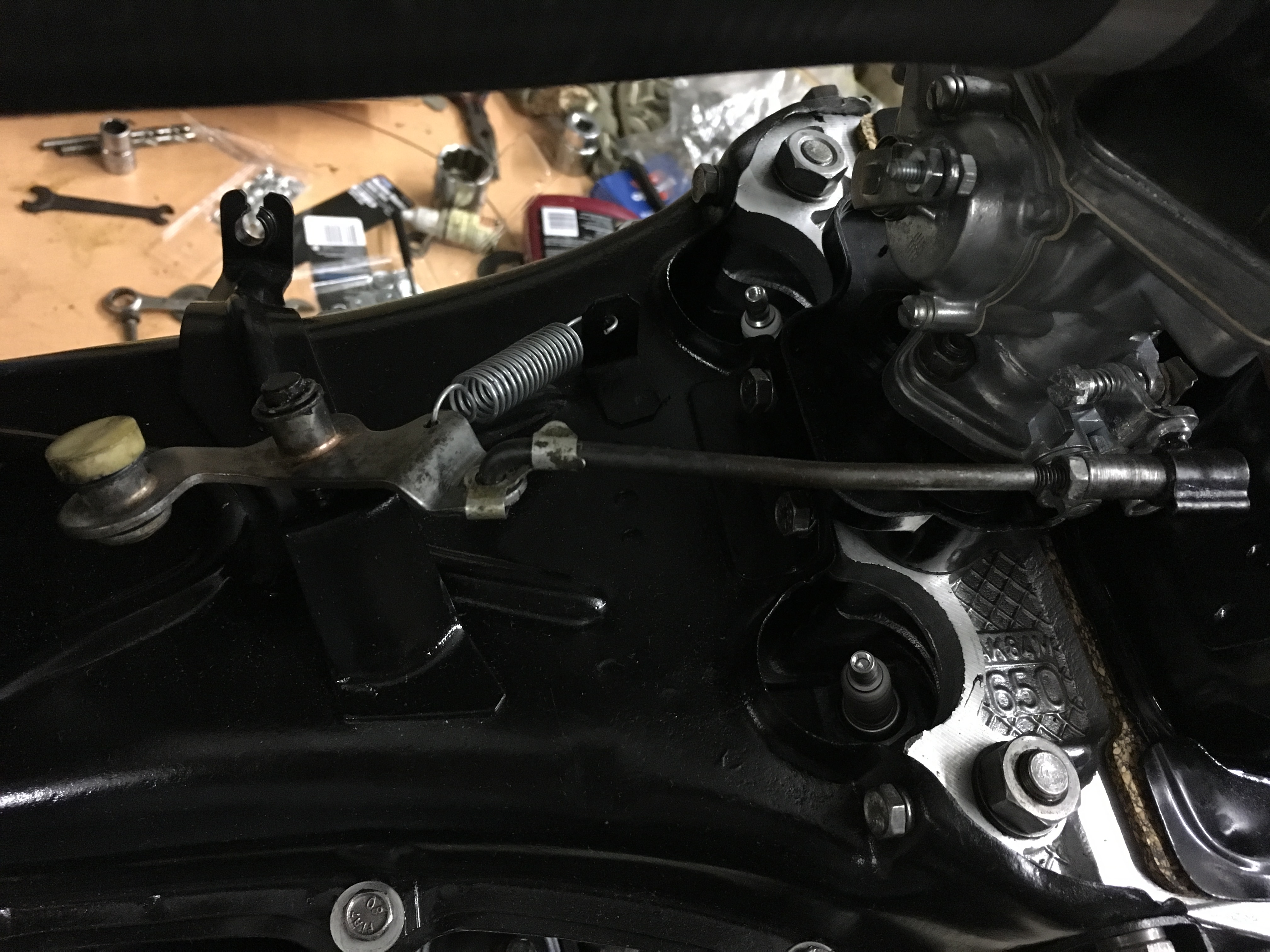

The rest of the tinware bolted on and carby linkage done. I had to modify a rod with the ball end attachment from my Fiat 1500 parts bin as the new 28 carb is different to the old 26.

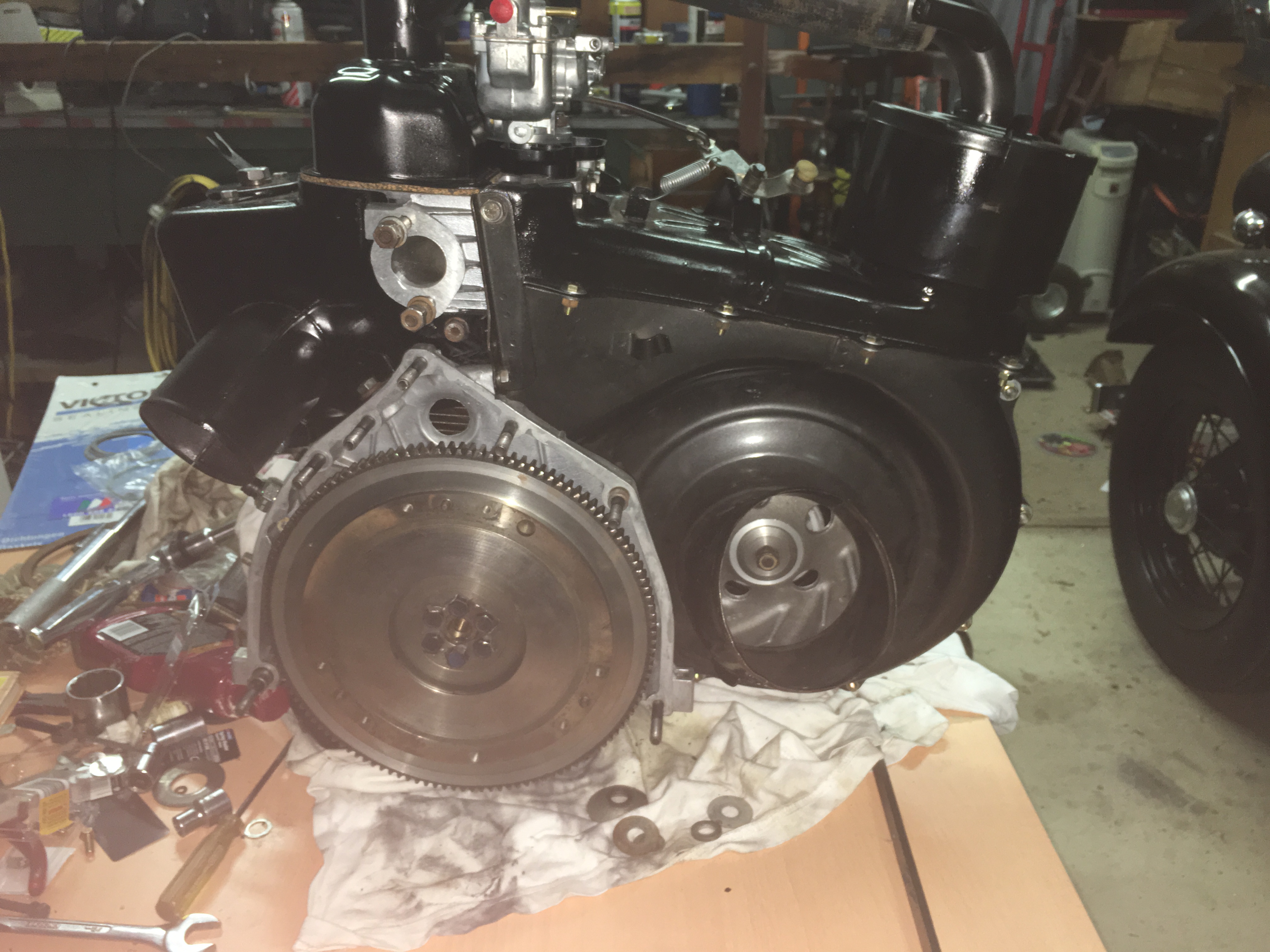

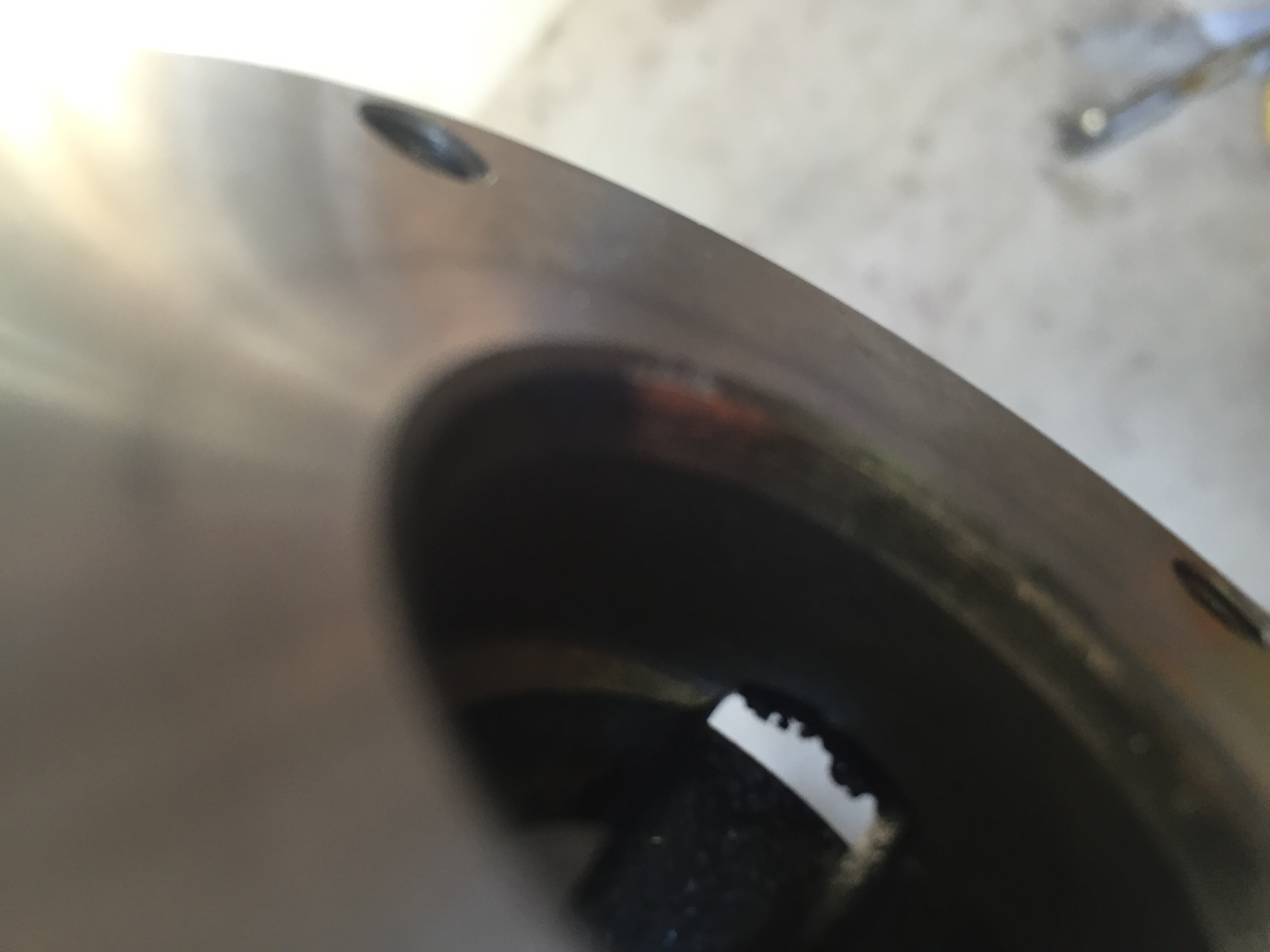

Flywheel on now. Can't recall how long ago I had it lightened (a couple of years maybe) so quite a milestone to finally bolt it on.

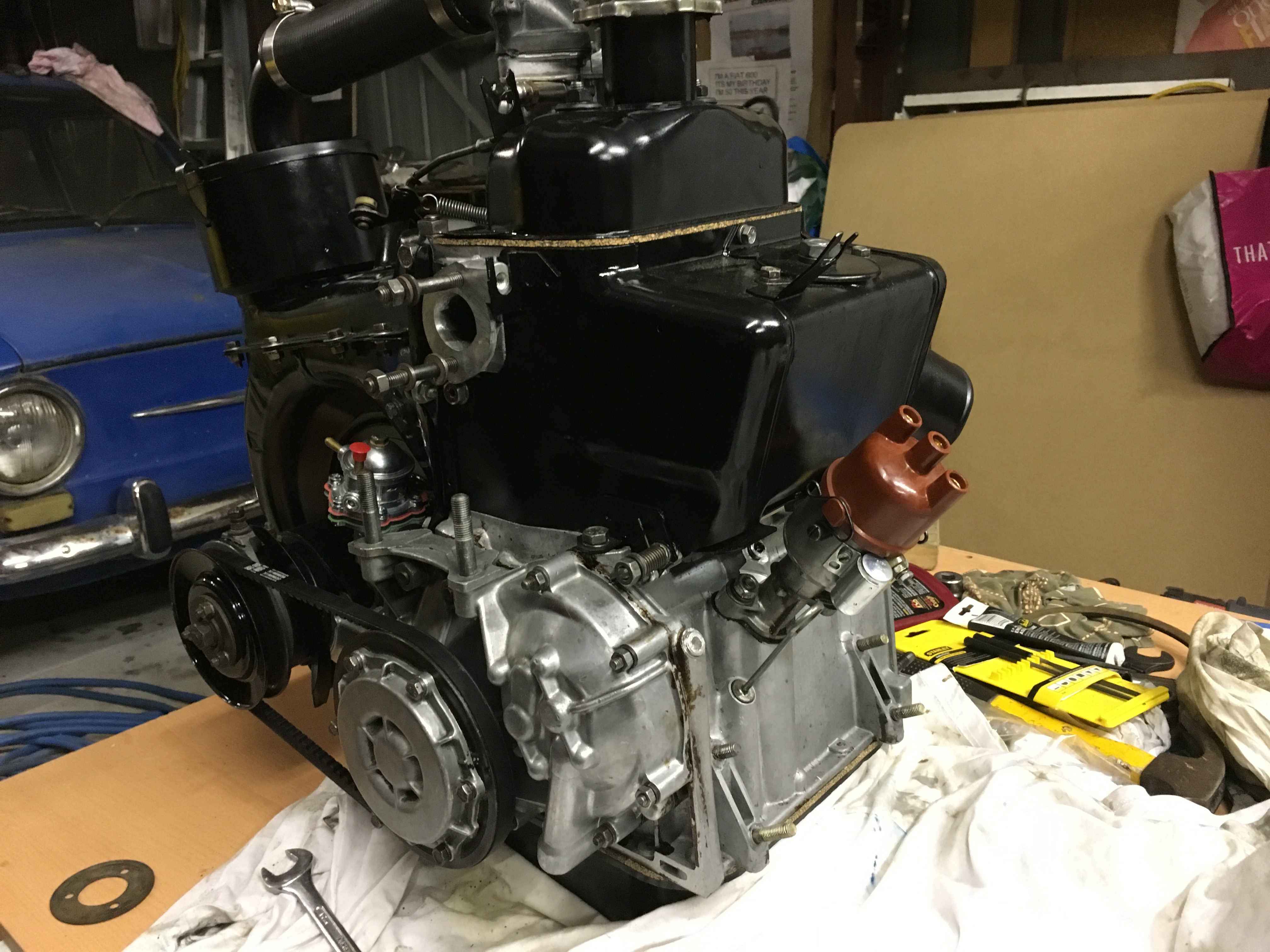

Popped out at 11pm to put the Distributor on last night
So now what to do... Exhaust, oil, leads and fire it up.... Should only take 6 months?
Well done! You seem to have the staff situation well sorted--and on a serious note, great to see youngsters helping on the car rather than--'I can't Dad, I'm in the middle of a game on my ?-?-?'
Is that a '850 saloon' that I see lurking in the background?---converted into an OT1000 they make for a great 'just going out for a blast dear' cars, and in some ways better than the 600 based variants. Abarth put a 1600 Twin-cam into the back of a 850, called it the OT1600. The idea was to challenge Lotus (with the Cortina), but Fiat didn't show any interest in the project so, sadly, very few 'pucka' ones were built.
