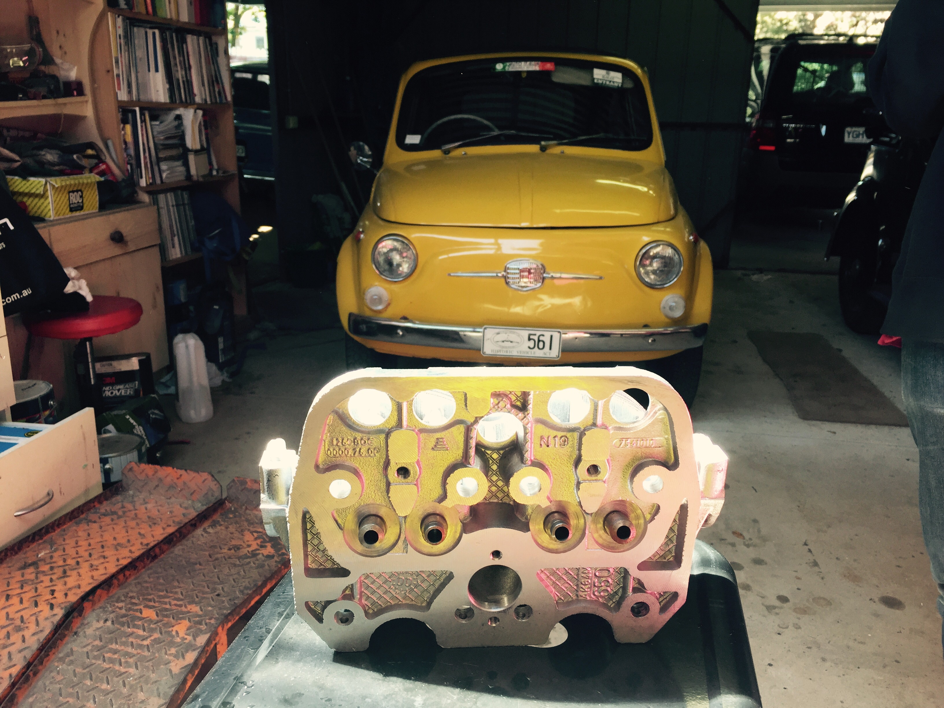

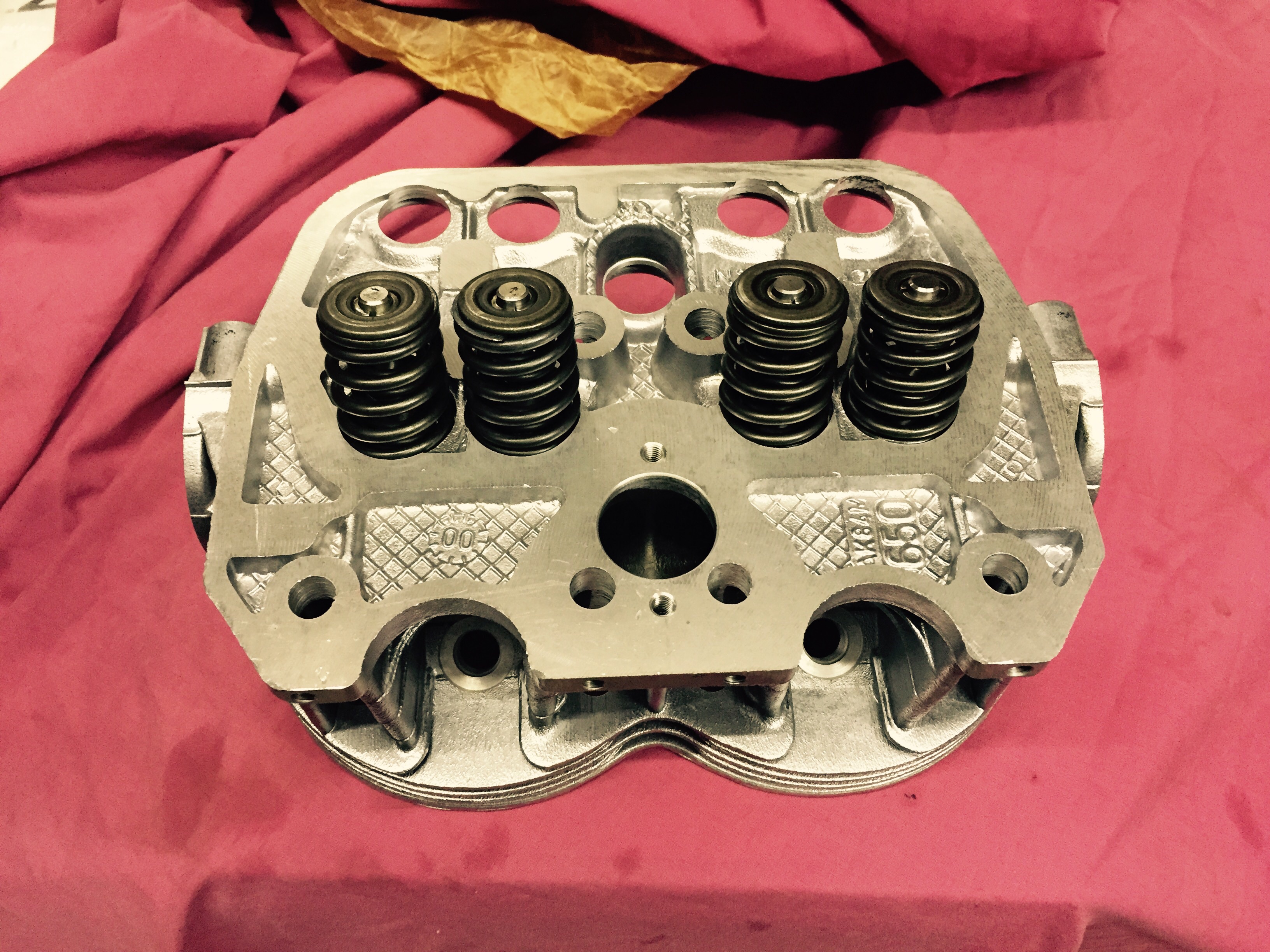

Valve grinding with my helpers (in the family room of course)

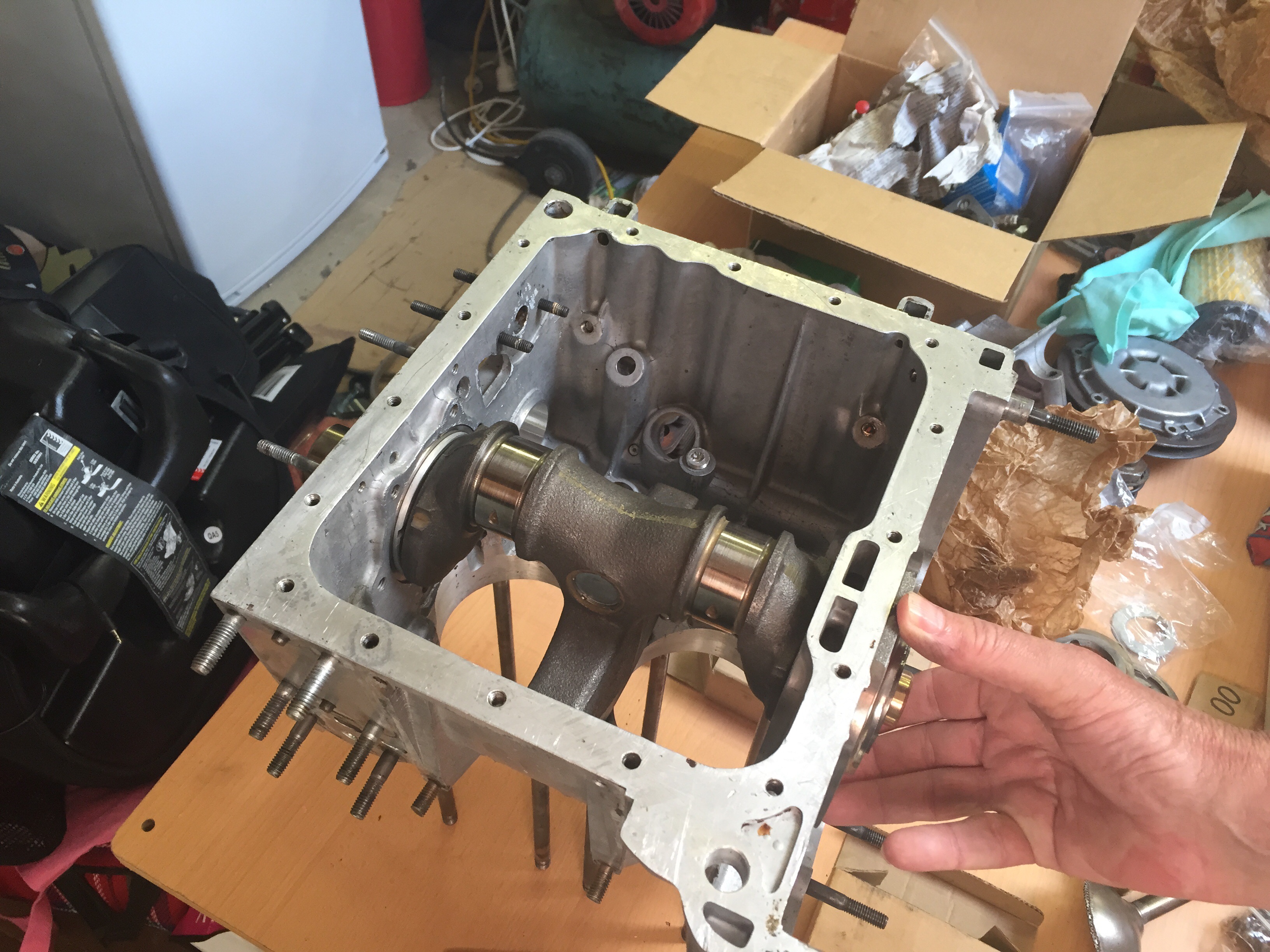

Installed the crankshaft today

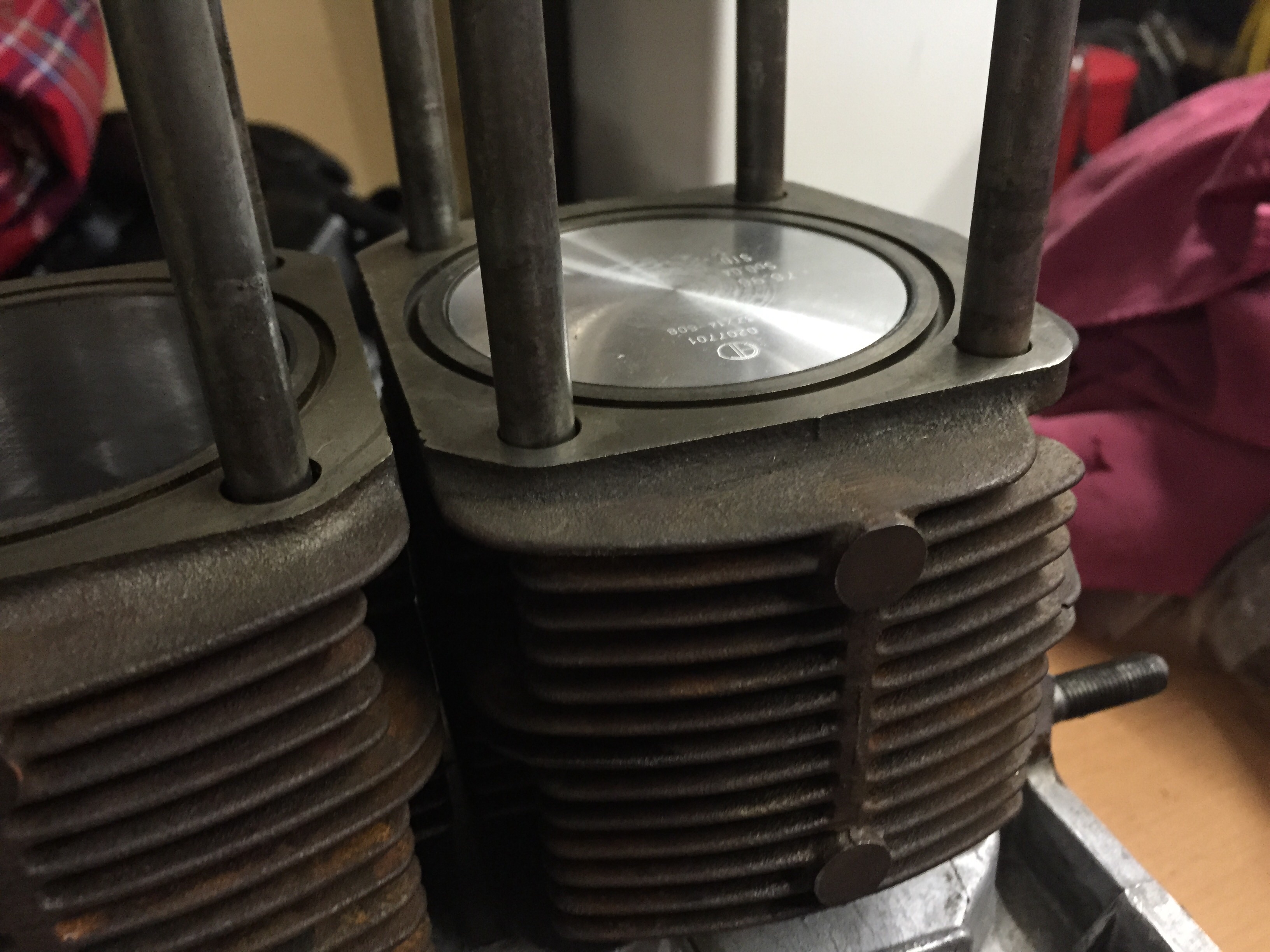

Went to put the new rods on new pistons and the gudgeon pins were able to be pressed on but not lined up in the centre
Are they supposed to be really tight? Do I just heat the ends of the rods to get them as central as possible and then assume the heat of the engine will make them just right when running??

No- the pins should be able to 'float' on the gudgeons- you might need to get the small end bushes reamed to allow some running clearance.
Also make sure you get the pistons the right way around- the gudgeon pin should be offset towards the camshaft.
When I was at Radbourne Racing, the trick was to put the piston on the workbench (top of piston sitting on bench), put a little bit of petrol into the piston, and light the petrol. This would heat the piston enough that the gudgeon-pin (wrist-pin for our American colleagues) could be easily slid into the piston. (A) make sure you have a fire extinguisher close to hand, (B) do it in an area clear of any combustibles, (C) have everything to hand (ie, con-rod, gudgeon-pin etc) and (D) make sure you have a heat-proof glove to hand--the piston will be HOT (an old oven glove will suffice--make sure 'er indoors is out of doors!). Damon is absolutely correct, when all has cooled down, the con-rod should be able to move easily on the Gudgeon-pin.
Thanks for the replies
As the rod was very tight on the gudgeon, even after warming the small end a bit, I took them to the machine shop today and they teamed a tiny bit off the bush
Now floating nicely
I also tested the piston height in the barrels and it sits just below the top of the barrel so no need for spacers

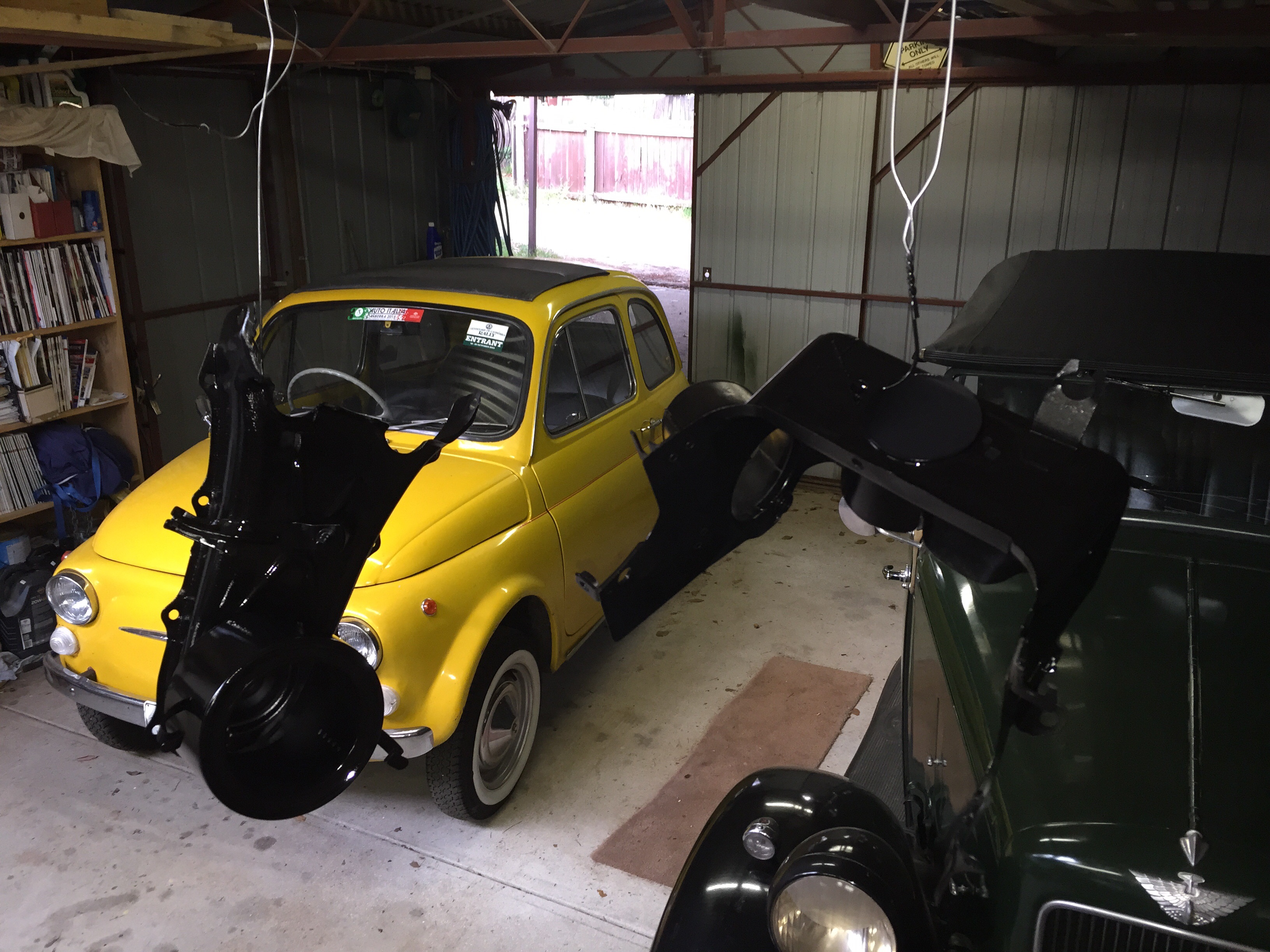

My dad is staying so he got the tinware sandblasted and it's now painted
Slowly getting things done
