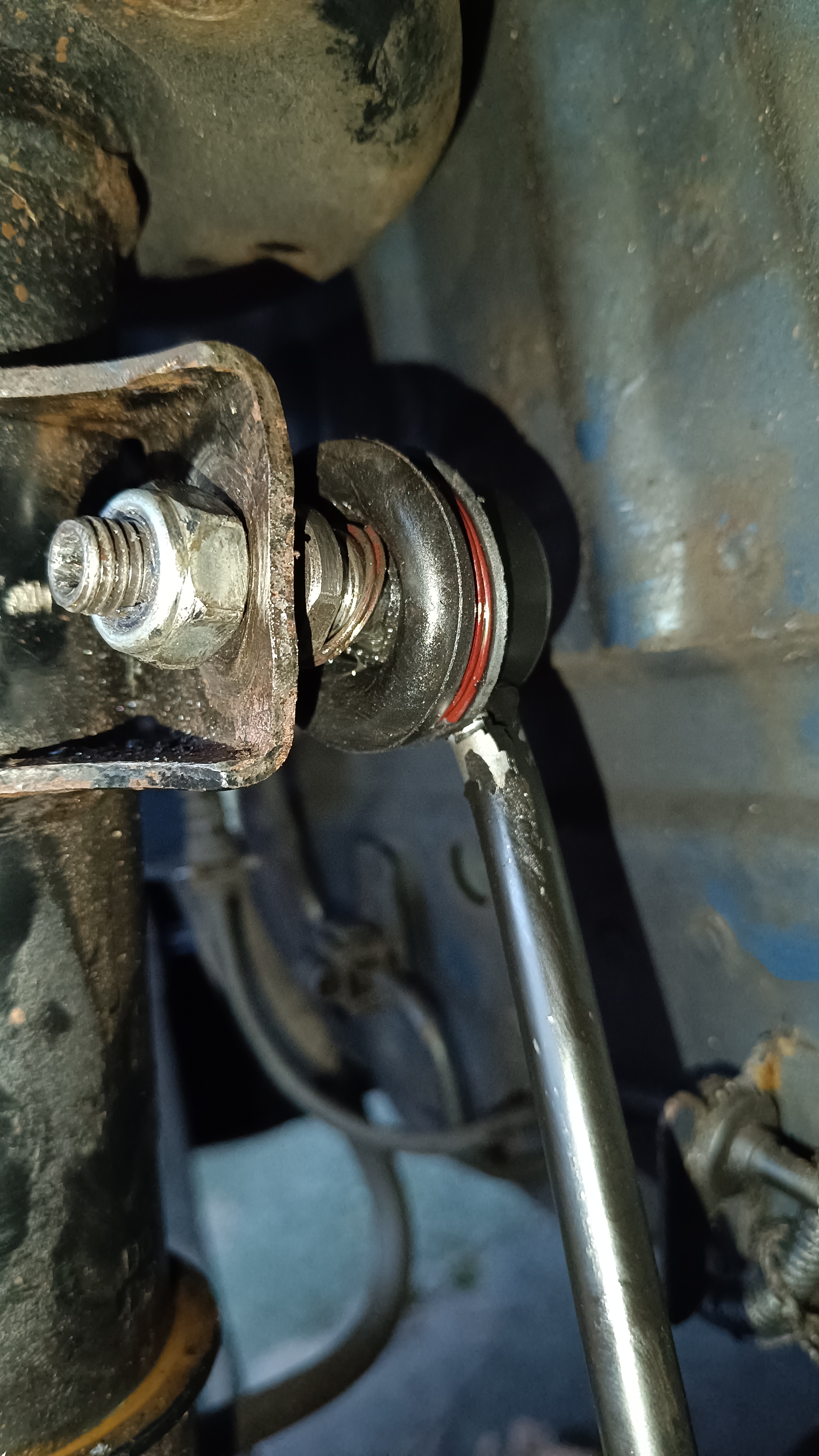

The new droplink came yesterday so when it stopped raining today i decided to get that on. However getting the old one off was quite a fight and then i cross threaded the new one, so it would neither fully tighten nor come off. I'll have to get an angle grinder on it tomorrow, and buy another one 🤕 I also managed to kill a droplink on my 500X a few months ago by cross threading it.
The bottom nut did go on properly without issue. The only difference i can think of between the top and bottom is that i used an impact gun on the top and hand tightened the bottom (because i didn't have access for an impact gun). And i put copper grease on the threads, that is OK isn't it?
So my question is...how do i not cross thread droplinks when tightening them?

A bit of oil or grease on the threads and start them by hand until they stop at the Nylock bit that self locks them from undoing, then if you must use impact gun a quick wizz shouldn't damage anything.
I notice the paint is off the link also so I assume a bit of force was used to encourage the thread into the hole in suspension strut. It is better to put a bar against the anti roll bar to help line it up, another thing is have both sides of car supported equally so the antiroll bar is not straining.

OK to undo with impact gun and a little oil so threads not torn, but always start the threads by hand when tightening.
It may be a case of practice re using a jack or bar, but if both wheels equally off the level ground then the chances are the rod will slide through the hole easily. Remember the job of the anti roll bar and it's links is to transmit load from one side of car to other to aid cornering so quite a lot of effort to load the bar may be needed to align if car sat unevenly.

I think not using the impact gun should work.
As a retired aircraft engineer, we were always taught to finger tight all nuts and bolts, because you can 'feel' if the threads are correctly lined up as the nut should be easy to put on the bolt, with little resistance. If there is any resistance when finger fitting, remove and start again, to stop the cross threading.
impact guns just apply the power with no 'feedback ' and usually too fast to stop any cross threading. Bit of copper grease does no harm.
Slow and steady, should be the motto here. We were always taught to use spanners/sockets, and then finally tighten with a torque wrench. Impact wrenches were only used for undoing anything that was stuck. (one inspector called them 'tools of the devil' because it was so easy to over tighten or cross thread bolts/nuts with them, as there wasn't any user 'feedback' with them, as there is with spanner/socket)
Impact wrenches are supposed to be time savers, but..... often cause more aggro than they save. It's ok saying then have torque settings, but they don't have the feedback that fingers slowly engaging the threads has.

Just a small point, looking at the threads in your photo you may not have crossed the threads, but damaged them further down the thread when you used the jack to align the arm /link with the hole in the suspension strut.
So in effect the nut wound down the thread until it jammed on the damaged part further down.
Also as I mentioned earlier the rod has paint chipped off as though it had been strained going into the strut mounting point when you used the jack. Take your time is best. Like the old bull and the young bull joke, "young bull say I am going to run down and have one of those cows, the old bull says I am going to walk down and have the lot".;););)

After struggling to get the old droplink off I did think getting the new one on will be easy so I was a bit gungho. So you're right. Slow and steady wins the race.
