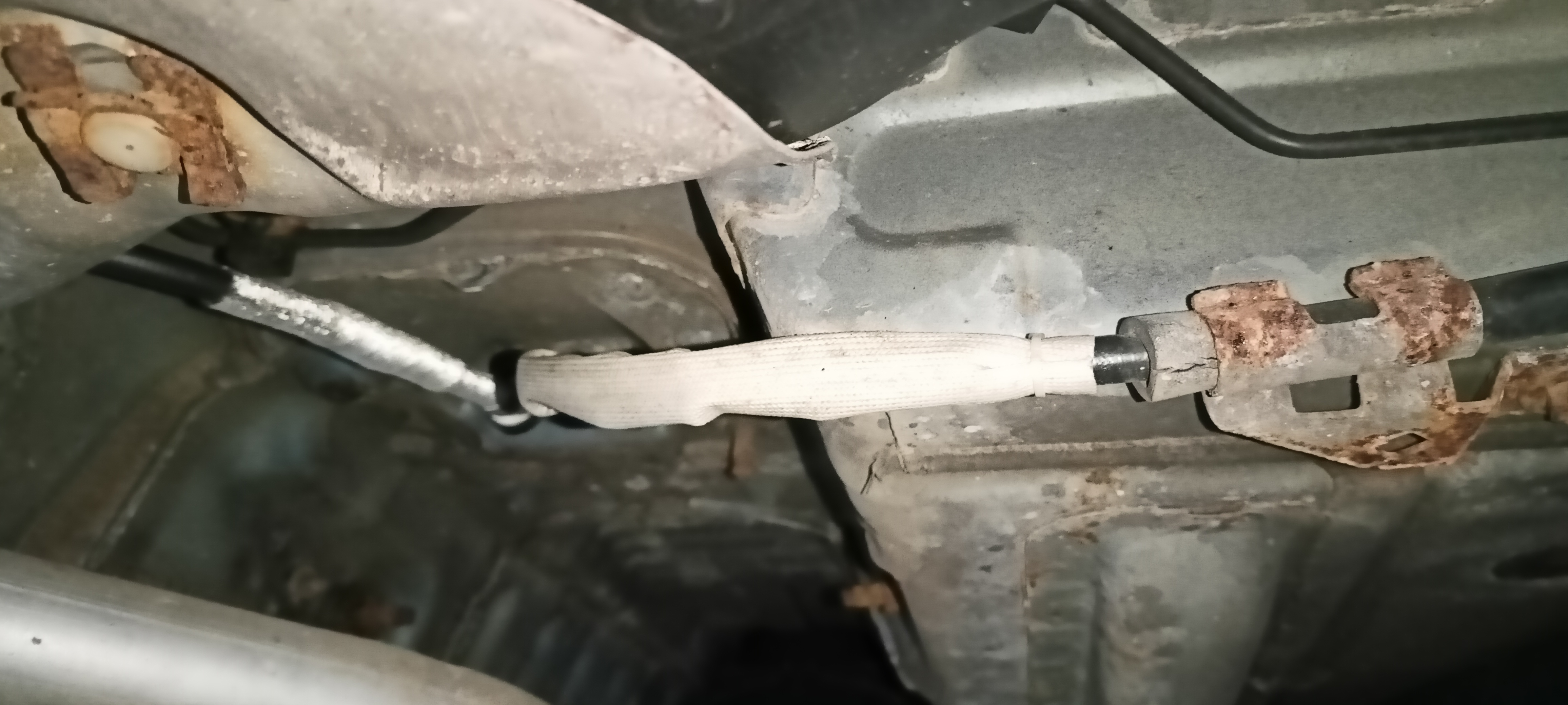

This is the patched up repair on the underside of the car, i wonder if the cable is sticking in there?

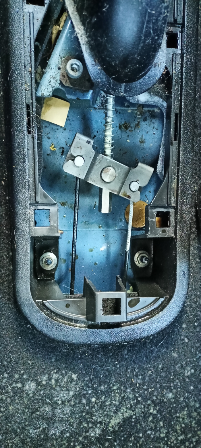

The other thing that comes to mind is that one cable is longer than the other. I'm really ragging the offside and it actually only moves a few mm but the nearside moves a few cm.

That handbrake cable "repair" may be only a heat shield as near the exhaust.
Re the cables, something is wrong when one is massively different in adjustment.

That handbrake cable "repair" may be only a heat sheild as near the exhaust.
Ahh that would make sense. And i prefer your explanation to mine :)

Either the left cable is partially ruptured and has lengthened, or the self-adjusting mecanism on the left side is broken (not adjusting any more) - the balancer should be strictly perpendicular to the cables. Third option: one cable is original, the other is aftermarket

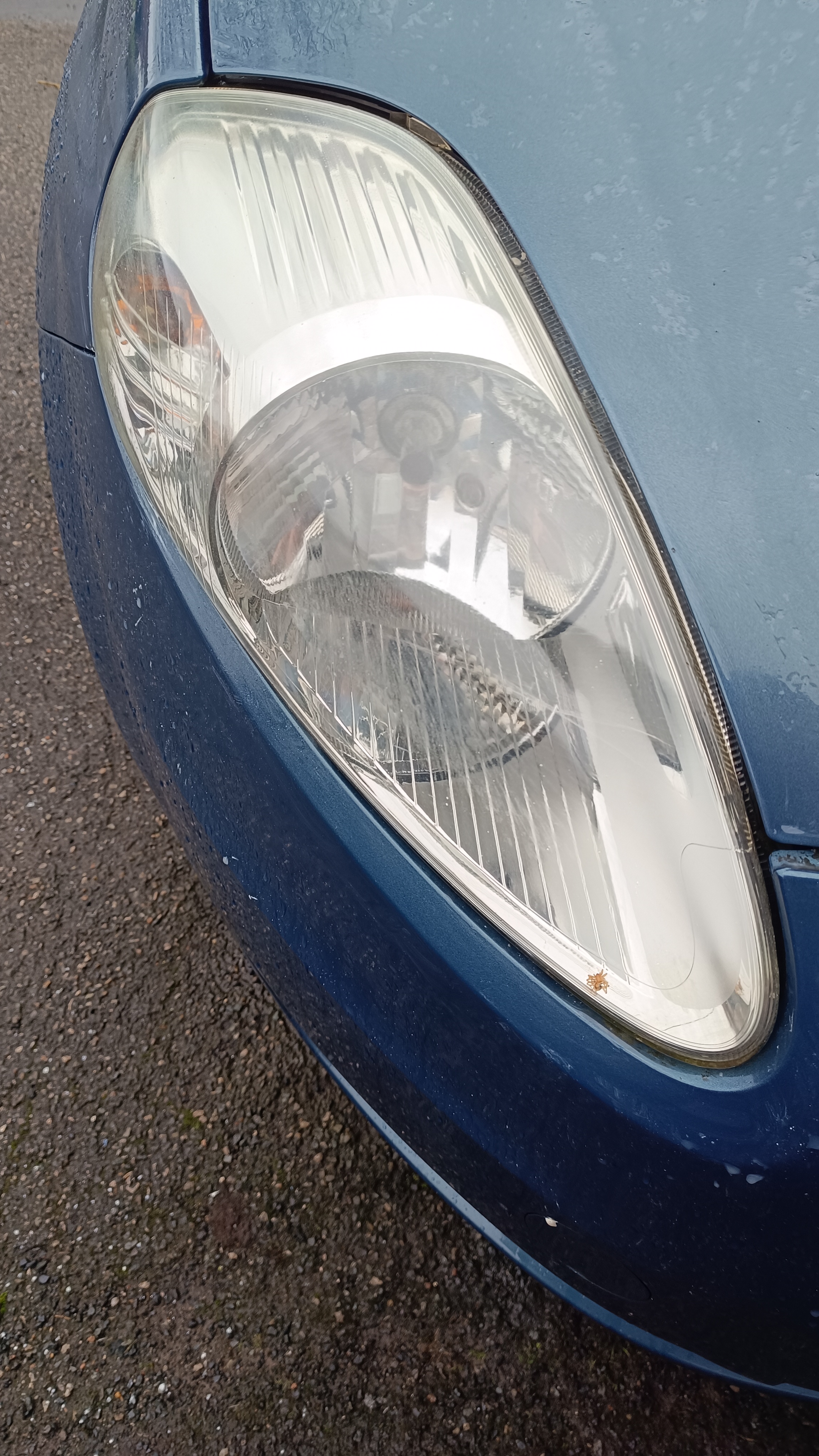

So i decided to polish one of the headlamps - and it worked! Happy days :) I could hardly forget to add water to the cutting compound with the rain lol, and didn't bother to mask it up. I can well imagine without you guys i'd have been sanding the headlamp with 40 grit sandpaper, scratching it to smithereens and generally tearing my hair out while i tried to fix it.
These are the current right headlamp which has been cleaned and the left which hasn't.

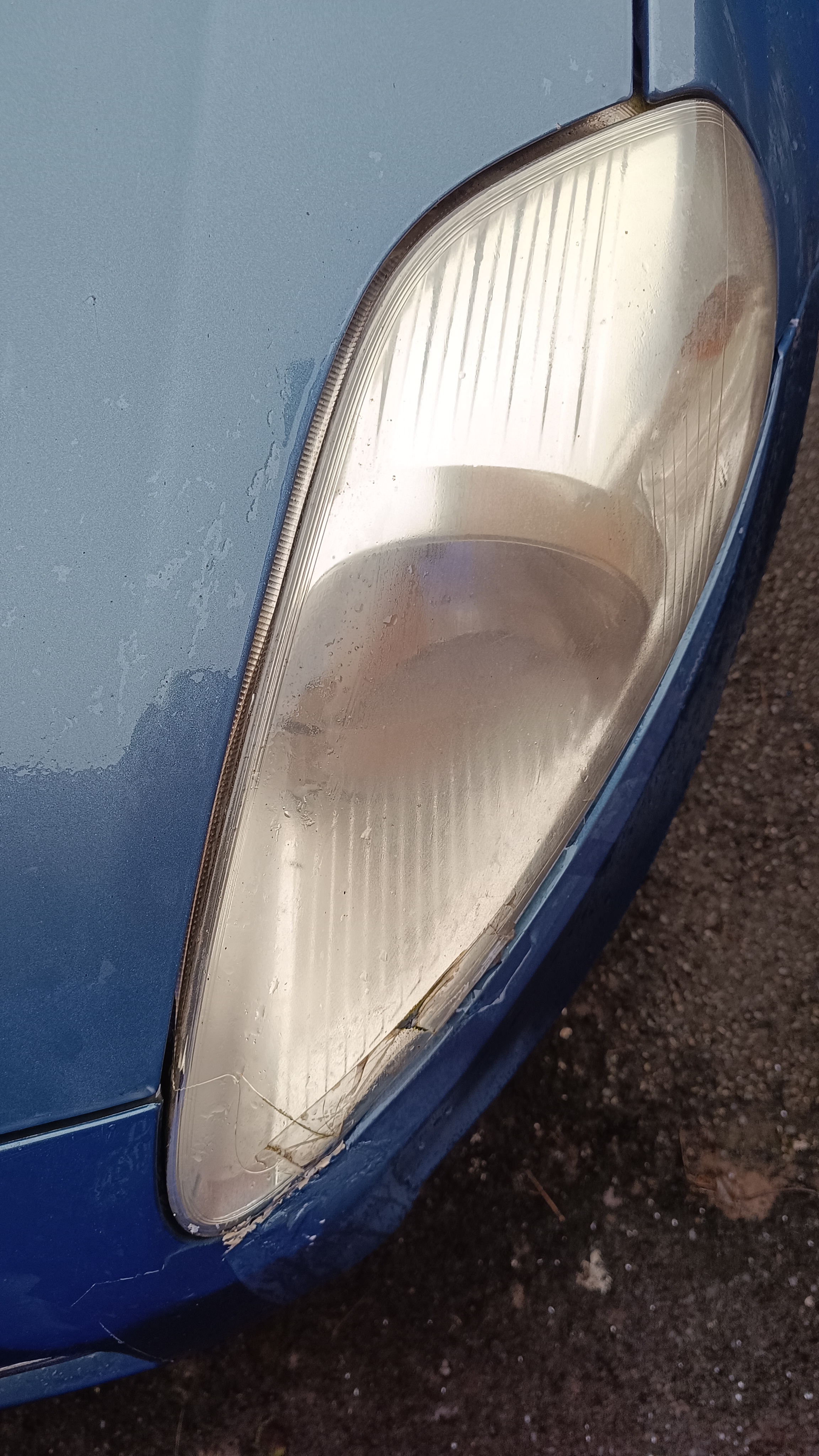

The left headlamp has a bit of damage, you can see a bit of clear tape. I bought it like this and it passes the MOT with an advisory only.
I could probably get a bit more off the one thats cleaned, i can still see some residue, but is it worth it? I presume it will pass the MOT like this?
I could probably get a bit more off the one thats cleaned, i can still see some residue, but is it worth it? I presume it will pass the MOT like this time?
I was sceptical about your clearcoat safe compound but.....huge well done and thanks for update.
I Think headlight def passable (-;
