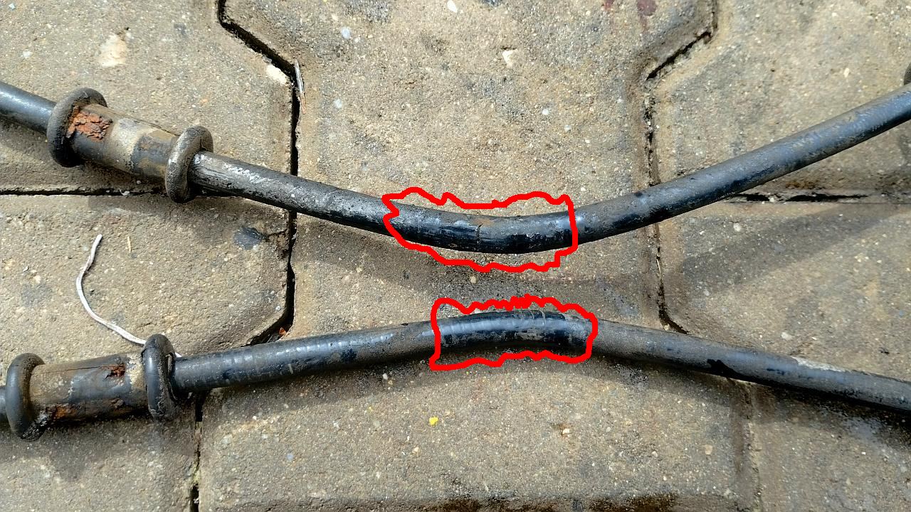

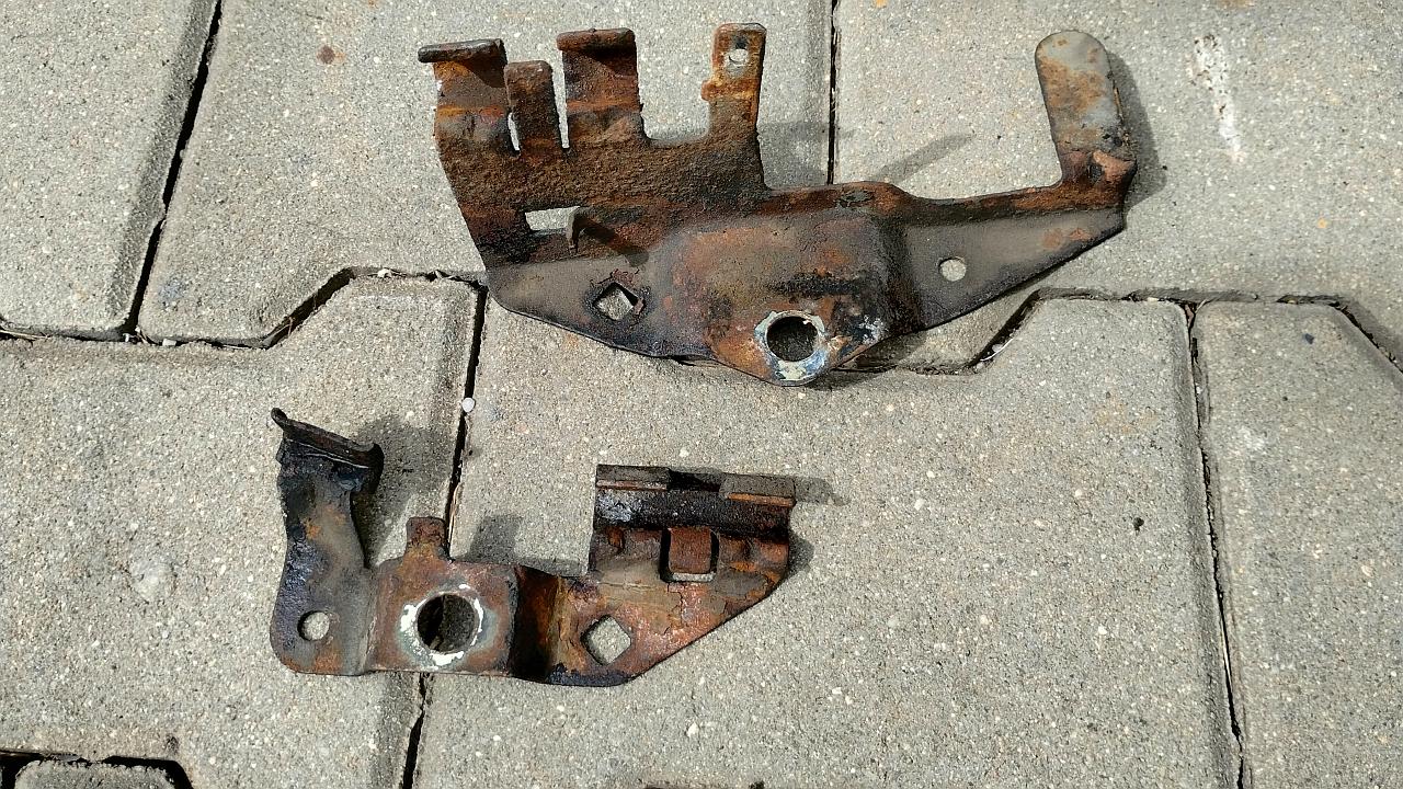

As for handbrake, check the Discussion (under this Guide): https://www.fiatforum.com/threads/rear-drum-strip-and-clean.235078/
You have a faulty self-adjusters (bimetal strip) and/or bad cables and/or bad cable mounts (rusted and flex too much, spoiling the handbrake).
