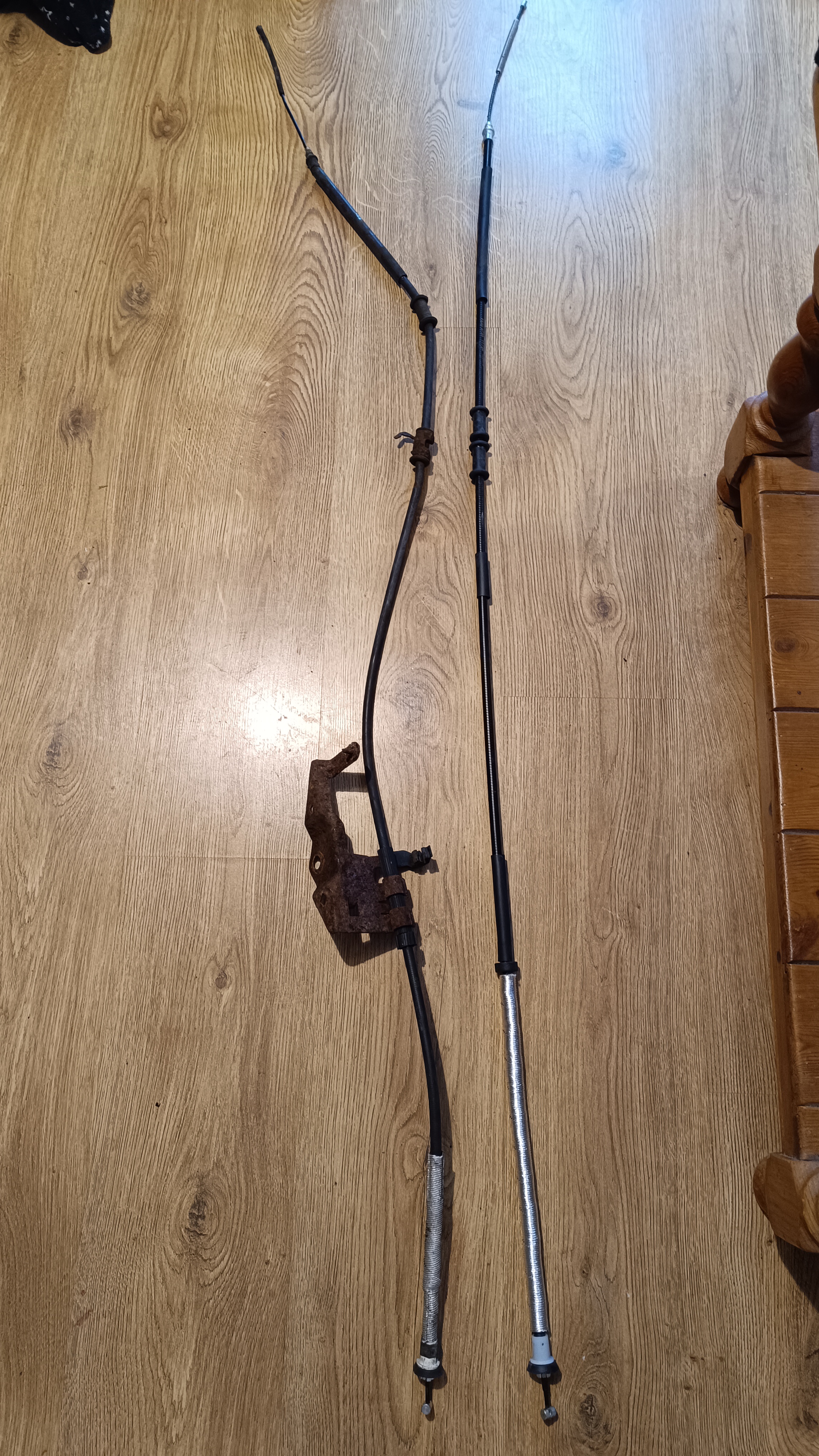

The old cable on the left is off, it does have a shortened heatshield so its a right hand cable. The new left going on is shorter than the old one but not enough to level up the equyalizer bar in the cabin most likely.
I wonder if the broken bracket shown nstill attached to the old cable has allowed the cable to have a shorter path, will that happen? It is still working but in poor condition. Its also not the same brand as the old right hand one i took off. I bought the car with this problem and it seems a previous mechanic has had a go at fixing it...
I wonder if the broken bracket shown still attached to the old cable has allowed the cable to have a shorter path, will that happen? It is still working but in poor condition. Its also not the same brand as the old right hand one i took off. I bought the car with this problem and it seems a previous mechanic has had a go at fixing it...![]()
I know, forgive me, i find it difficult to understand this, above all else!seriously I have written several times stating its not overall cable length that matters for balance but that each cable inner length minus its outer length is the same for both cables.
You could have a 1metre cable and a 8 metre cable but as long as inner minus out lengths the same it wouldn't matter
