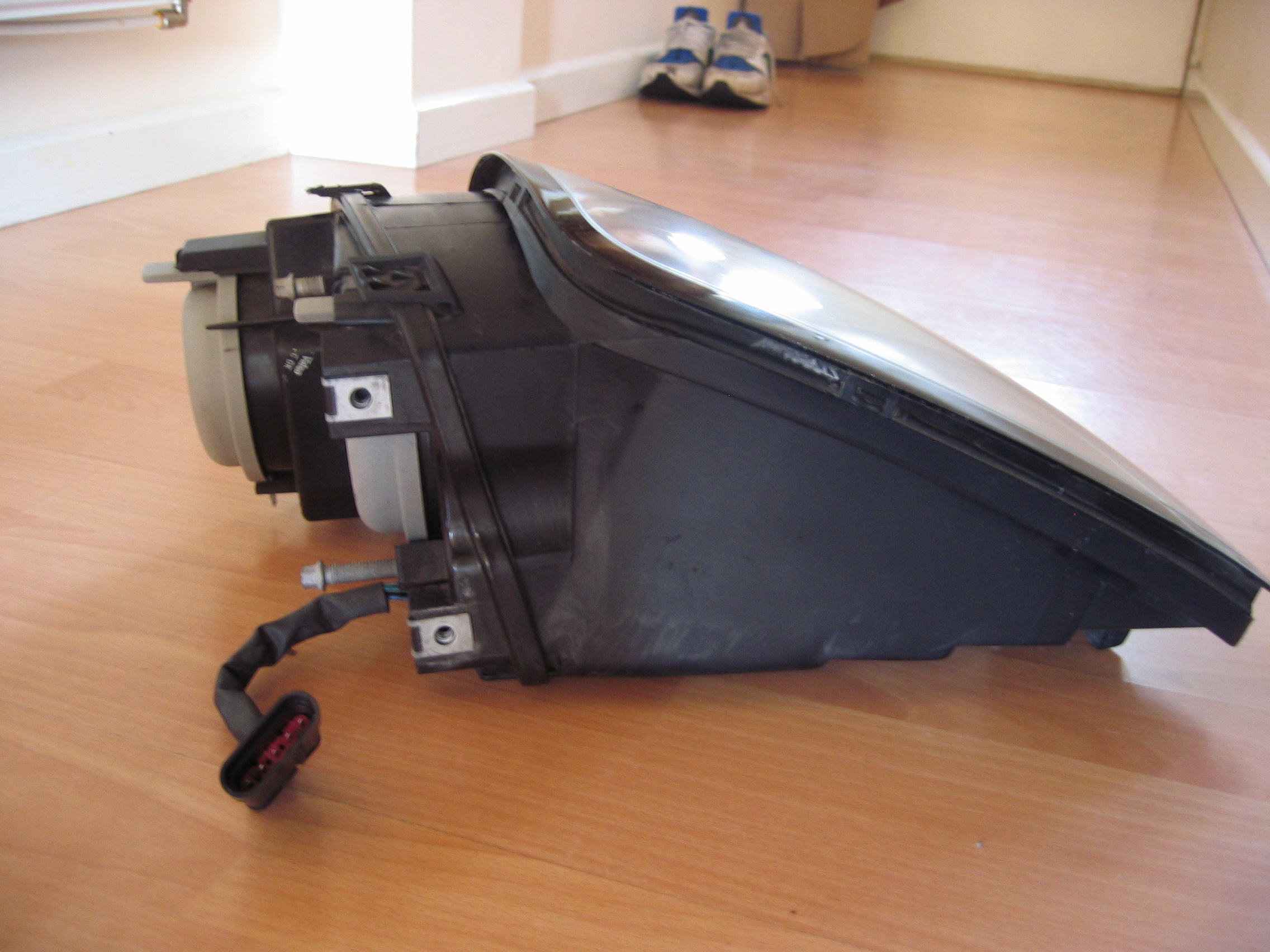

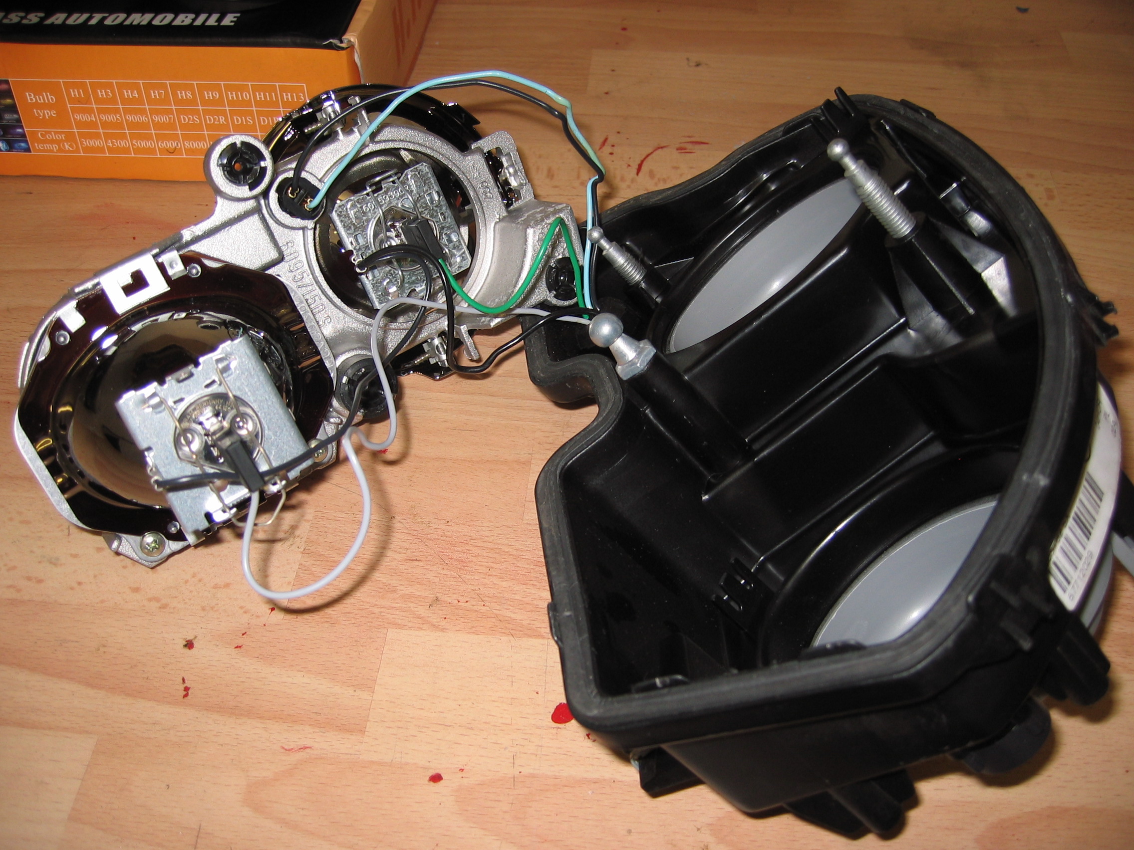

Yes you can get into the light while the light is in the car but only through the grey hatch to change both bulbs. If you need to get into the light to clean it you will need to take the front bumper off and undo the mounting points for the light. One mount is at the front under the light, the other is inside the wing behind the inner plastic wheel arch and the last one is inside the engine bay. If you want to change the lamps from LHD -RHD you must take the headlights out and change round the direction plate thats fitted inside the light.

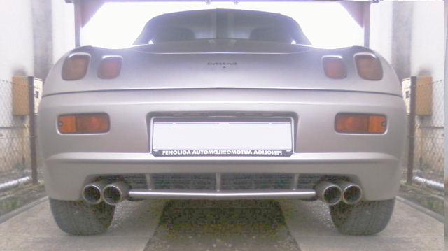

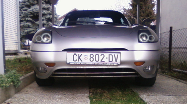

does anybody install those "angel eyes"? how will this looks on b? i try do draw something but it doesn't looks fine. :yuck: well... maybe it will not looks so ugly when fitted real ones....
and what about double dual exhaust? it look super i think.

this has been discussed before :)
double twin exhaust = (y)
"angel eyes" = :yuck:

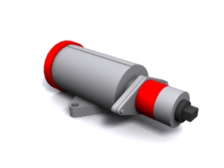

i had some time so i clean this part, i is some air flow controller or something, i open it and clean those air-in and air-out holes, there were a lot of oil inside. i don't have photos for now, so i draw how it looks now.
if you notice that engine is working unstable, you should clean this.
