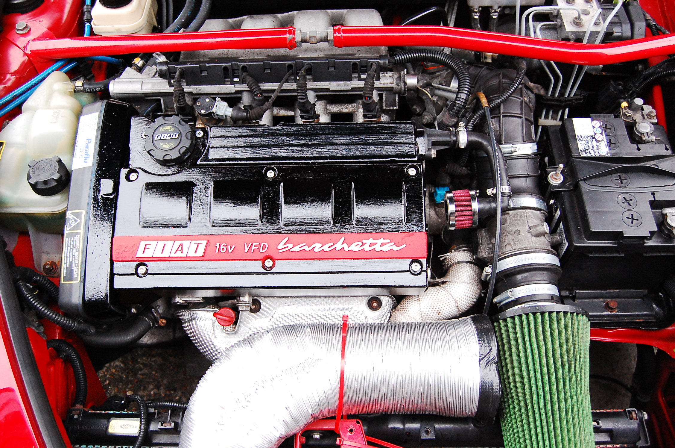

Engine cover (before and after)
btw: i noticed on a lot of covers that have black spot, you can see it on first picture above 16V text on this second spark "bumper"... :confused:
i polished it, but later i decided to paint it to silver. i need to paint words and numbers to red.

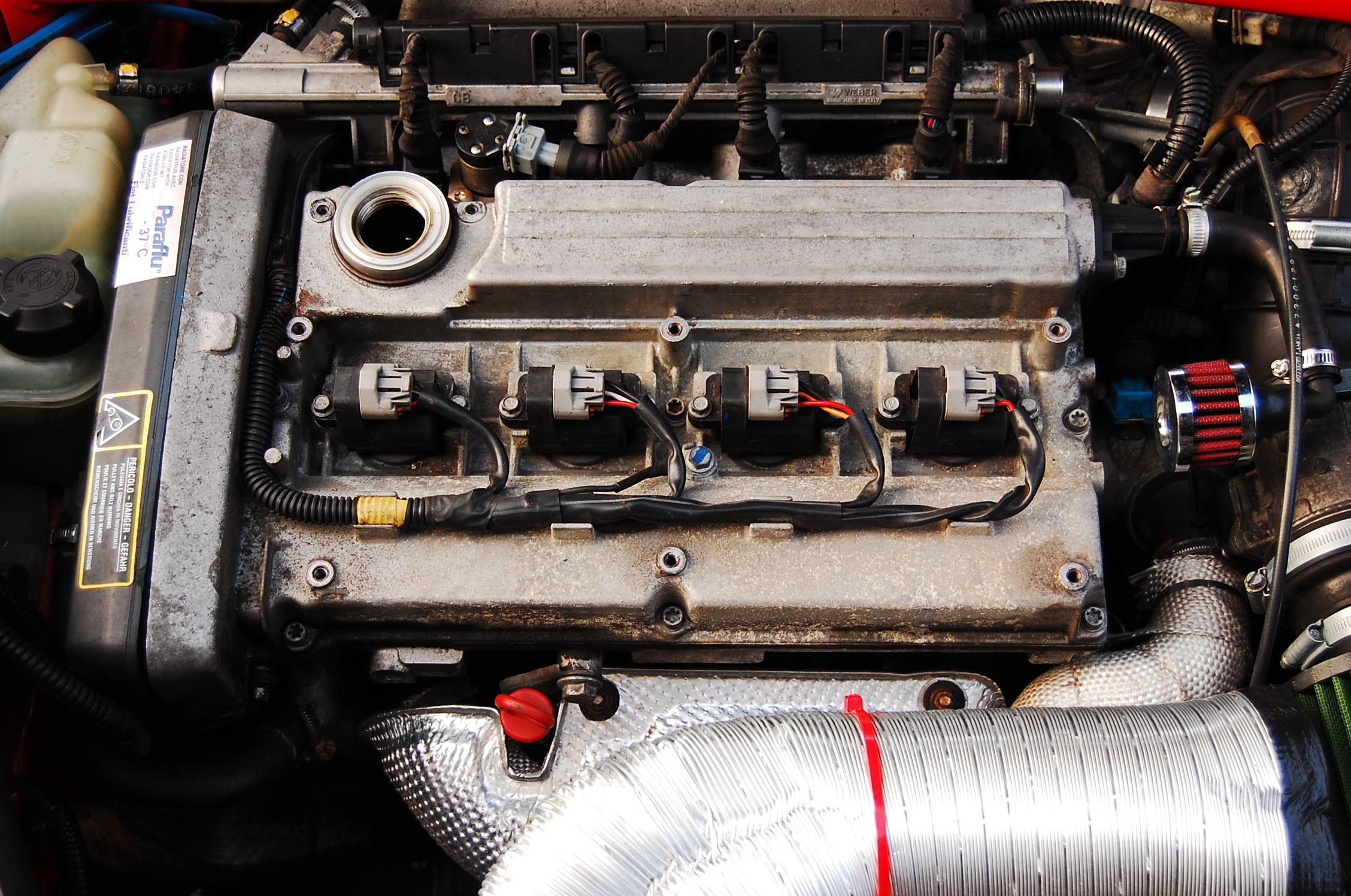

q: can i clean and paint directly this parts marked with green? i don't wont to remove whole engine apart. i will cover all other parts with newspaper and sticky tape.

Yup, its easy to clean/pain the parts that you have market in green, although its much easier to do it off the car. Tip, if you do remove it from the car take extreme care putting it back on again. When you re-fit it put the bolts in one at a time and work out from the centre in a circular motion, first of all do them finger tight, then tighten them until you feel a little resistance agains the head, then nick them up and finally tighten them. It takes a while but I have seem a few cracked cam covers where someone has been a bit gun-ho about re-fitting them - take your time and apply the pressure evenly and you will be ok!

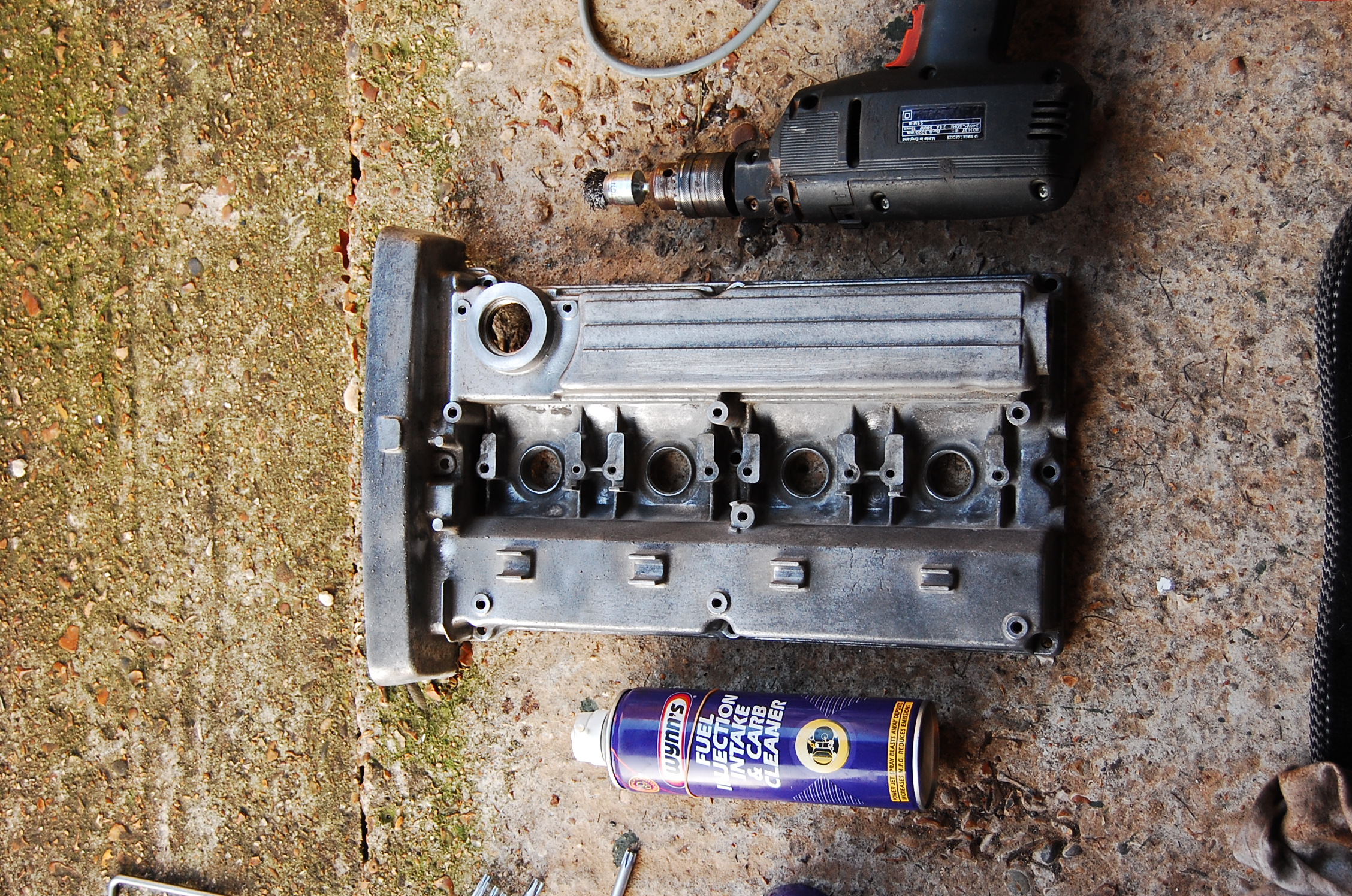

@beacon - well, first i clean whole cover with some de-rust fluid, after that i take some sand paper and shake it until your fingers fall out and of course until rust is removed. for tiny parts (holes in numbers and letter) use dremel tool. after that clean it again. i use some silver spray for painting. it have to be heat resisted (mine was up to +600°C). btw: you may search other threads about this.

thanks LRB for tips. so i can easy remove this (under-cover) cam cover and no worries about anything? somebody told me that there is some sealing rubber, should I buy new one or this existing will be ok when putting back? it will be much easier to clean and paint if i remove this. what else should i be carefull of? sparks? oil?
thanks.
Yup, sorry I guess I only gave you 1/2 the advice there!

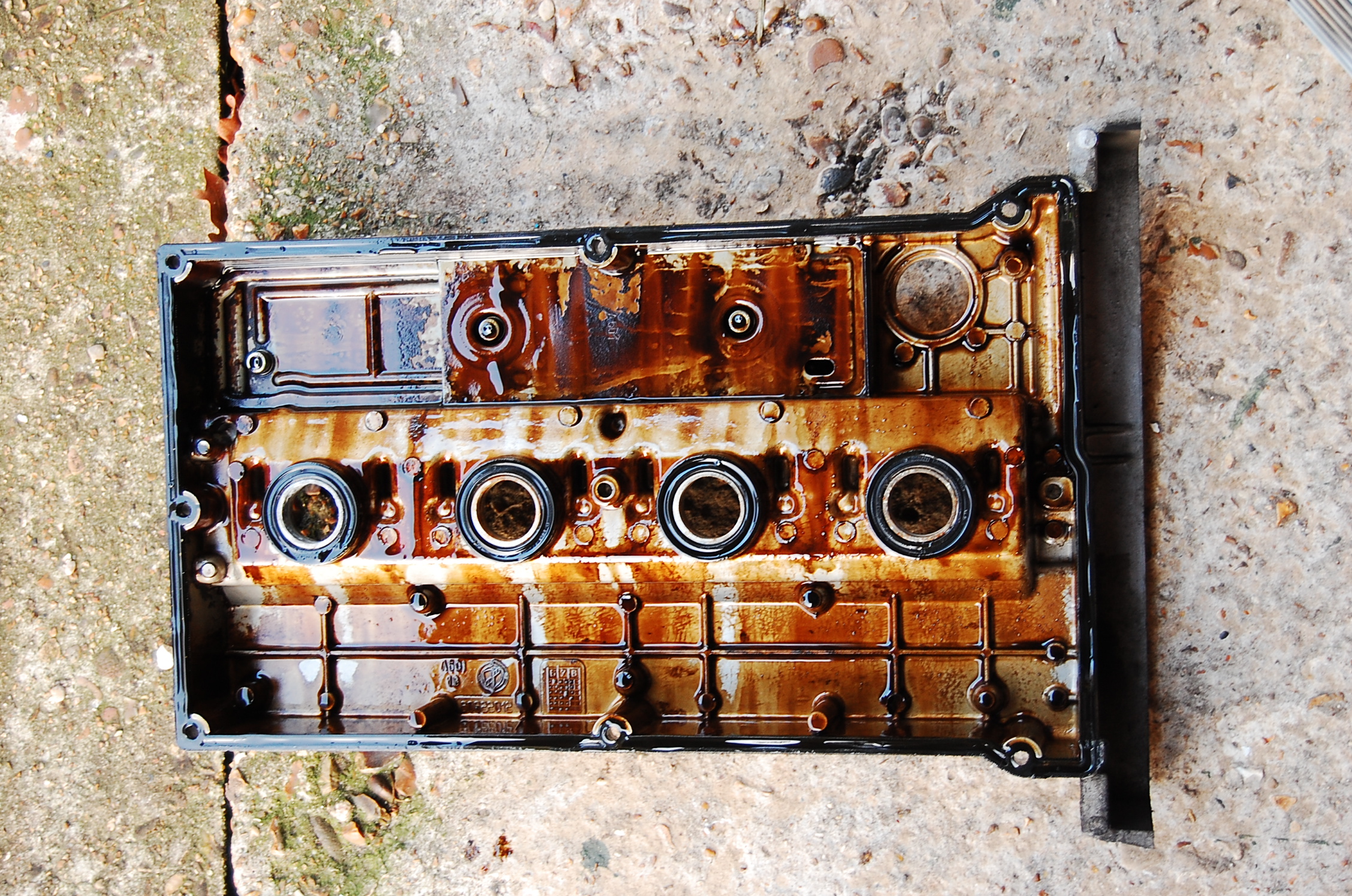

You should replace the rubber seal, it does not cost much and if its been on there for more than a couple of years has probably gone hard so would benefit from being renewed. The seals often fail on the bottom left hand corner and dribble down the front of the block under the manifold, gave me a hell of a scare when I first saw it as I thought I had a crack in the block! When re-fitting the seal I would also suggest using some oil resistant instant gasket, just to make sure!
No need to remove the plugs, just the leads!

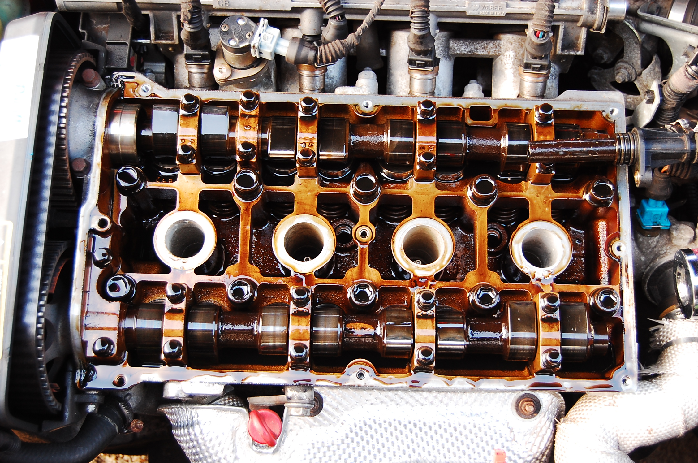

Here are a couple of piccies, really is an easy job!
HTH, if you need anything else let me know ;)
