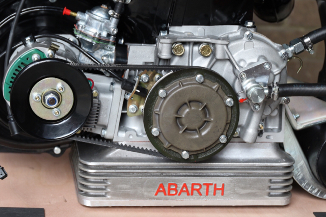

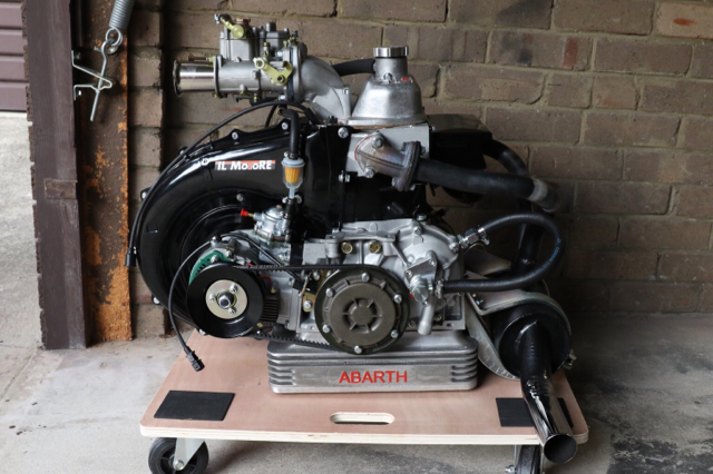

The engine looks fantastic. Any chance the car will be heading to AutoItalia Canberra or the Fiat Nationals next year?
Yes, I hope for both. My goal is to have the car finished by this December for use on my wedding day, and then afterwards just enjoy the car and attend club events and shows etc, to meet other owners and learn more about these great little cars.

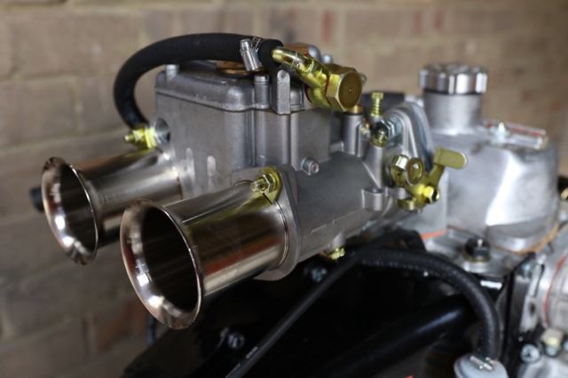

Really good looking engine---but I noticed that there is no 'under-carb' support?
Yes, he builds very solid engines. Both he and I don't feel the need for the support. With the 5-bolt manifold, it's very strong and there's no evident deflection. This is nearly his 200th competition FIAT motor, so if he's happy to run without it, I'll take his recommendation; but I do see a lot of people putting support brackets on between the cooling tins and the lower side of the Weber body.
If I have concerns, I will look at laying up some carbon-Kevlar that mounts to the lower screw for the trumpet, and the tin. As a lot of the aluminum ones I've seen look very bulky and quite over-engineered.
Did the motor builder run the engine up before sending it out to you?
What power output his he stating for the build spec. you have ?

Yes, dyno and bench test was done at his workshop. 55hp at 7,000 as a safe tune, based on normal 98RON bowser/pump Premium unleaded petrol. It will be good for over 60 no problem, but I have no need to push beyond 7,000rpm; it's been built to have plenty of head-room so that I have a motor that will last.

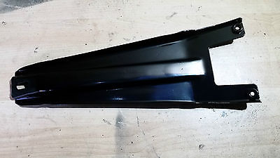

I have kept with the 500L rear panel but with an 18mm lowering block and uprated Spring. I have fitted the 126 gearbox support which bolts through the gearbox support cradle and a new fixing through the floor in the internally mounted removable panel. It prevents the box twisting...but it's not connected directly to the gearbox casing.
I don't think I've seen that mount. If you get a chance to get a basic pic of the part, or of it installed, I'd like to see how it looks.

Sure thing - have you any images of the damper you have in mind?
