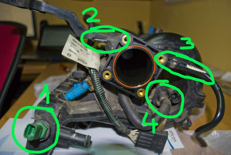

Well, that's the problem, the throttle body is electrically, instead of cable, operated. What do i do? Is there a way to make megasquirt run this TB? Is there a way to mod it to use a cable instead?

Can someone help me identify the connections on this intake? Never seen one on a car, so it's gonna be a bit hard to match them all without your help.
1 is i guess a water temp sensor?
2 ???
3 ???
4 idle air solenoid?
There's an another connector on the other side of the intake, gonna take a pic after i resolve this part of the problem

As for what it's off, my guess is bravo/a as well (see one post above).
Can i safely block 3 and 4 and use 2 as the megasquirt's vacuum gauge line then?
