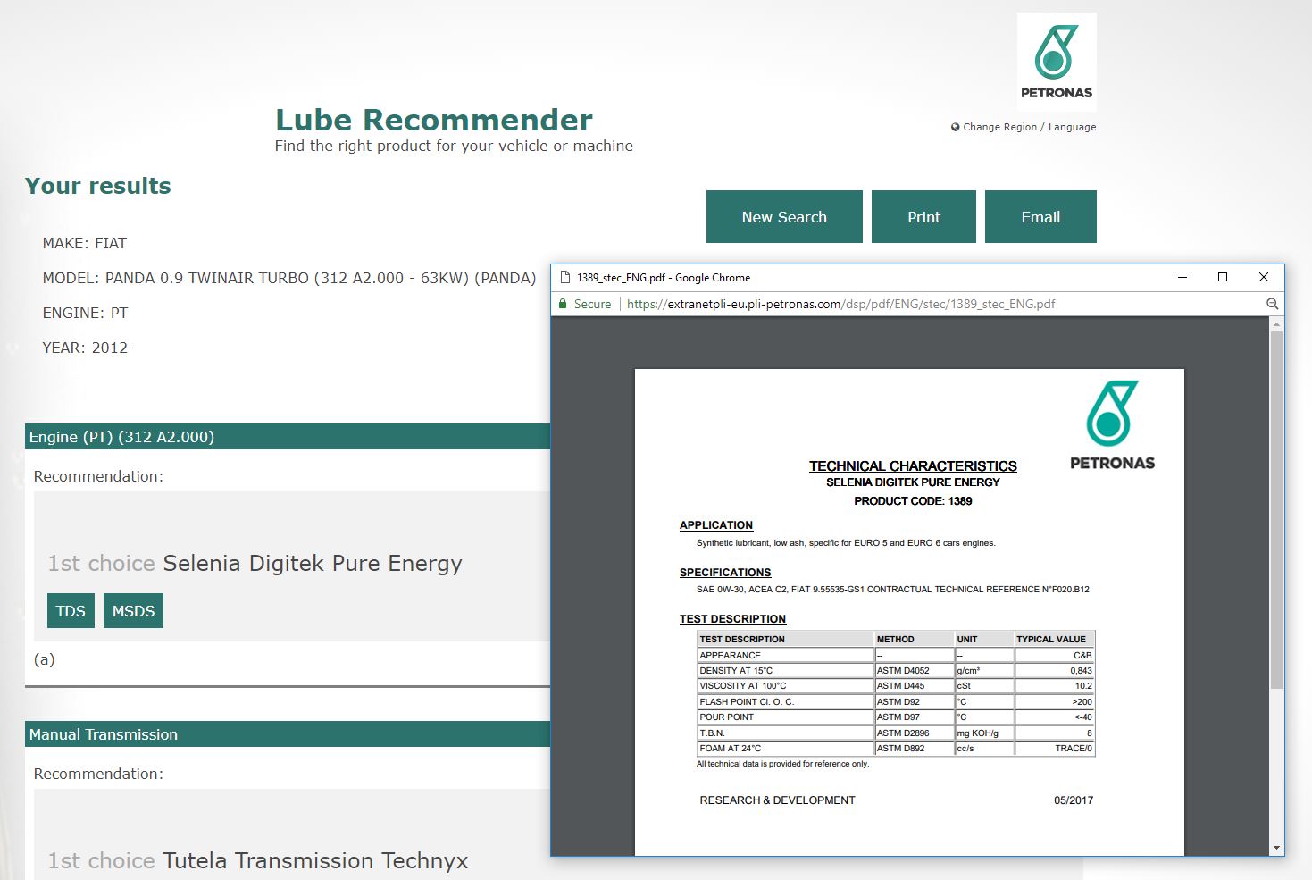

I just returned a 19k miles, 3 yo TA Panda 4x4 to the dealership, after it didn't run properly when warmed up and I had found that the wrong oil was on the receipt for the last service. Workshop manager confirmed that the vehicle information system says to use 5W40 instead of 0W30 and they used a standard Ultra S instead of Selenia.
