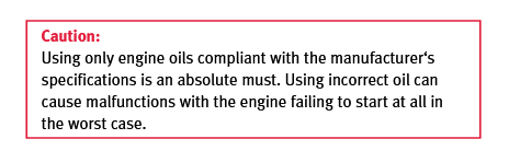

Based on the fact that the part number for a uniair module for a 2016+ Panda is exactly the same as for a 2012 model, I reckon that's going to be pretty safe.
Things aren't that simple. Even if the hardware is the same, the software controlling the operation of the uniair module may be different.
Read this post for a more detailed explanation.
Based on everything we know so far and in particular the INA Schaeffler technical document linked here, my recommendation is to use only the specific grade and specification (though not brand, provided it's the correct grade and spec) of oil recommended by Fiat for the particular year and model of your car. Experimentation could lead to engine damage, including uniair module failure, and is not recommended.
I'll leave the final words to the technical guys at the company which designed the uniair system.
