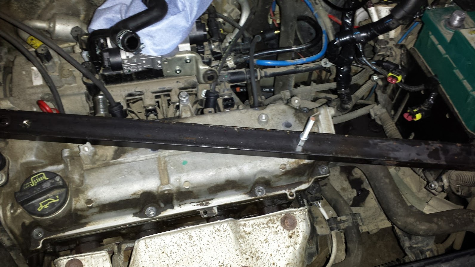

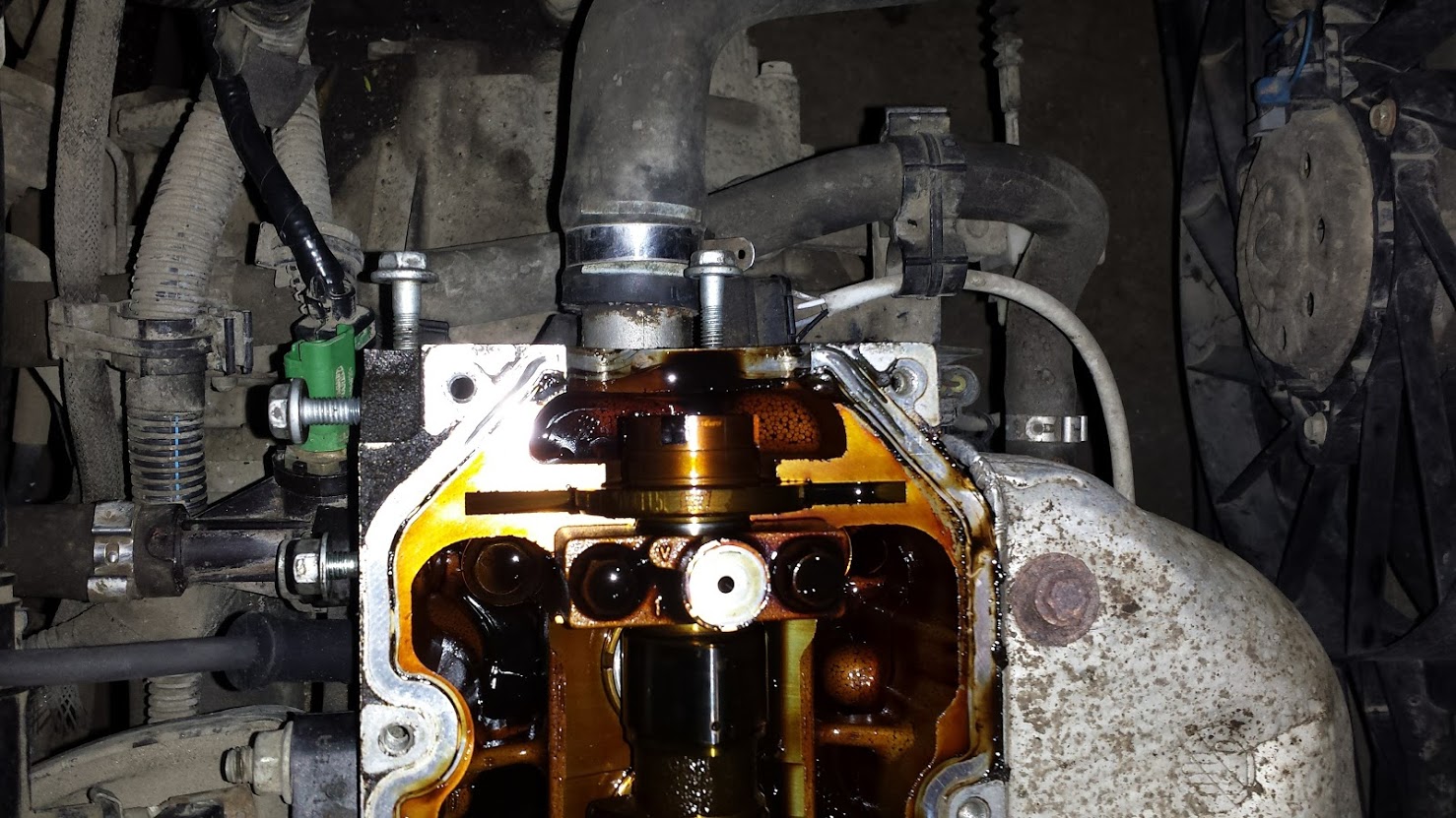

I managed to remove the stuck cover, gently, using an improvised lever as in picture. It came up nice; it was really stuck, first 1-2 mm pretty hard to move.
Replaced the gasket; torqued the screws to 8Nm - is it the correct torque?
I opted not to put the corner silicon points; the plan is to watch it, and replace it again after a while.
I also replaced the coolant sensor; this one was tricky to remove too; quite a narrow space.

I'm not sure how to answer the question, as I don't know how it should look like.
The light came only from flash, hence a possible higher contrast.
The oil changes were regular, even more frequent in the last time.
