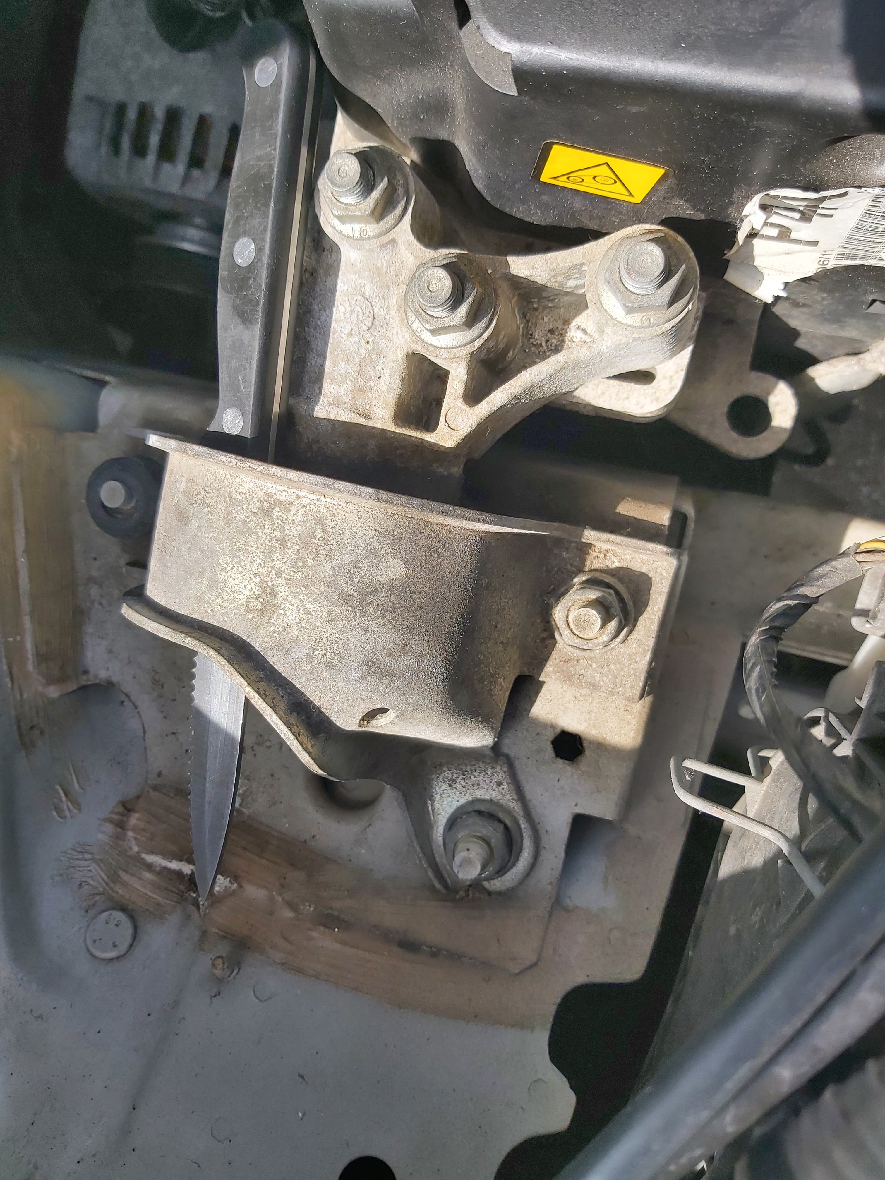

Cheers koaler I have another question if you don't mind I've noticed the offside upper engine mount the inner rubber has a gap which I think shouldn't be there the top of it is arched but on closer inspection you can get a knife blade to pass through it what are your thoughts please
Photo would probably help

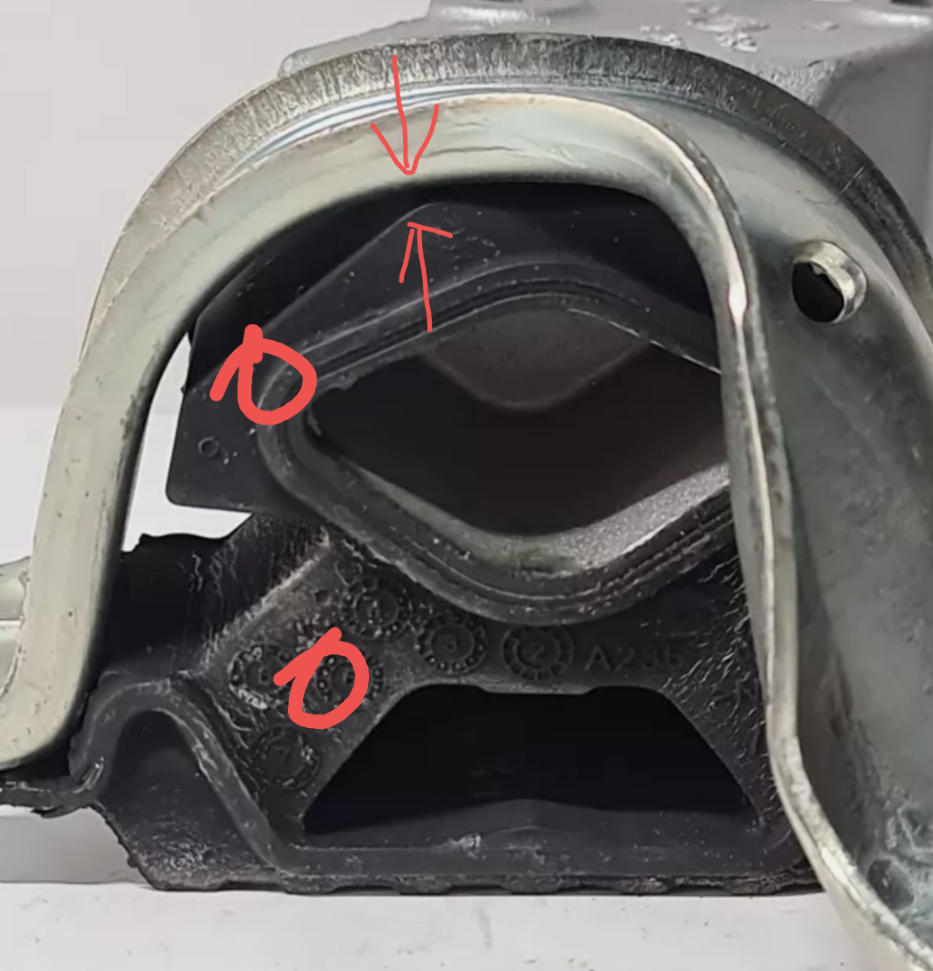

If you mean the right hand engine mount over the engine
And here
It's normal
While your looking at it
Look for cracks lower circle
Delamination of the rubber to the centre metal diamond shape normally near the upper circle
Don't normally go unless the engine been running bad and shacking a lot
