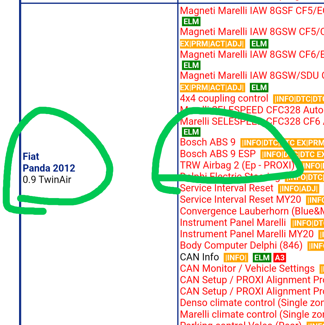

2012+ twinairABS is listed as free on the page for this car.
Says no
What am I doing wrong
Red is not free, and so green/orange is free? I'm not sure. Looks like I may have misread it.
Alfaobd doesn't appear to support ABS over KKL cable, looks like needs to be ELM?Only ones in black is free
Cable should work with alfaobd free to read the ABS code

Possible let me checkAlfaobd doesn't appear to support ABS over KKL cable, looks like needs to be ELM?
Correct the later post 2012 use Bosch 9 (CAN)Alfaobd doesn't appear to support ABS over KKL cable, looks like needs to be ELM?
