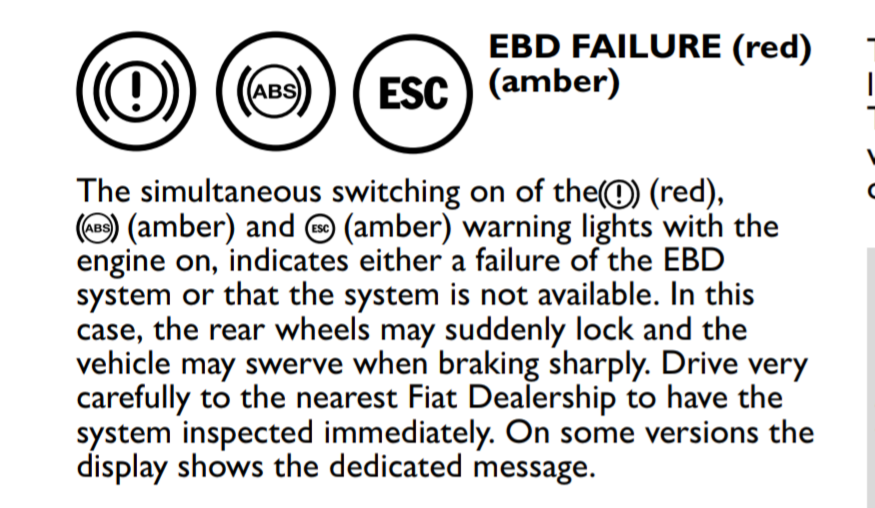

Well I'm out at this point; all my experience with a '63 plate 4x4 TA points to low volts (and indeed with other marques - specifically an alternator failure on a VW where each of the equivalent warnings came up as I trudged across Europe - bar the alternator warning which came last!!).
