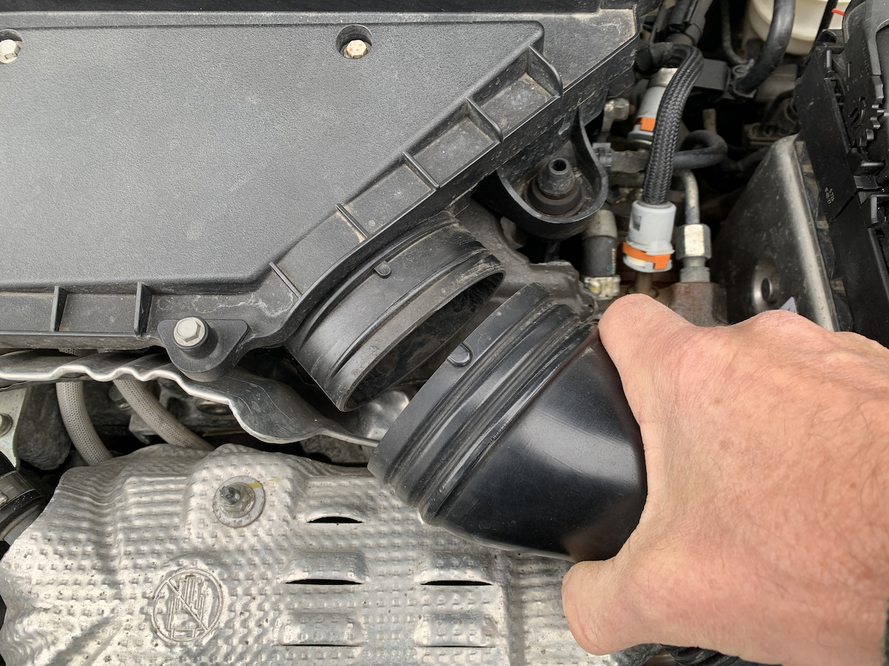

Above: Start by removing the bolt securing the air intake to the bodywork, then remove the intake by pulling and twisting at the same time – this just detaches from the air filter housing.

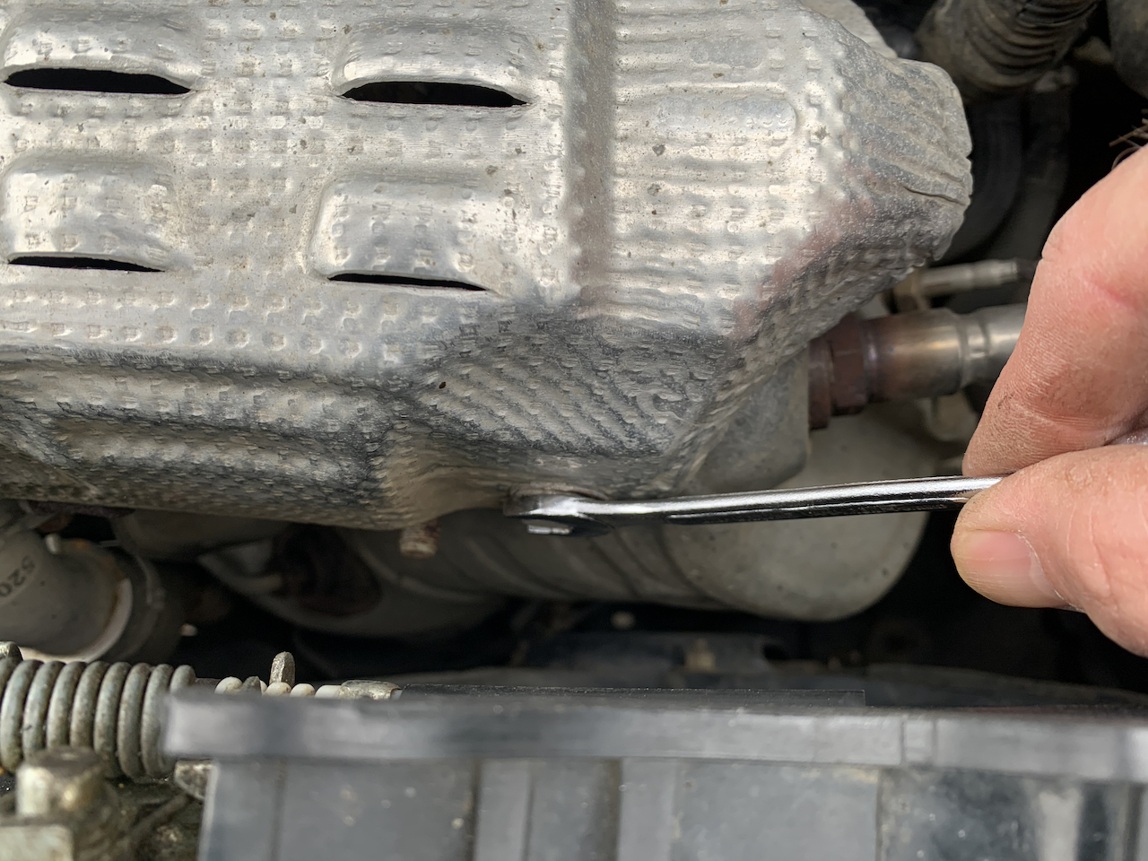

Remove the heat shield from over the turbo (if the engine is warm, wait as it will be very hot here) - there are two nuts and two bolts, all 10mm heads. Take care not to drop the short bolt on the front, as it then falls onto the sump guard (on the 4x4) -- I did that when testing them, and it took longer to remove the sump tray to recover the bolt that any other part of this!

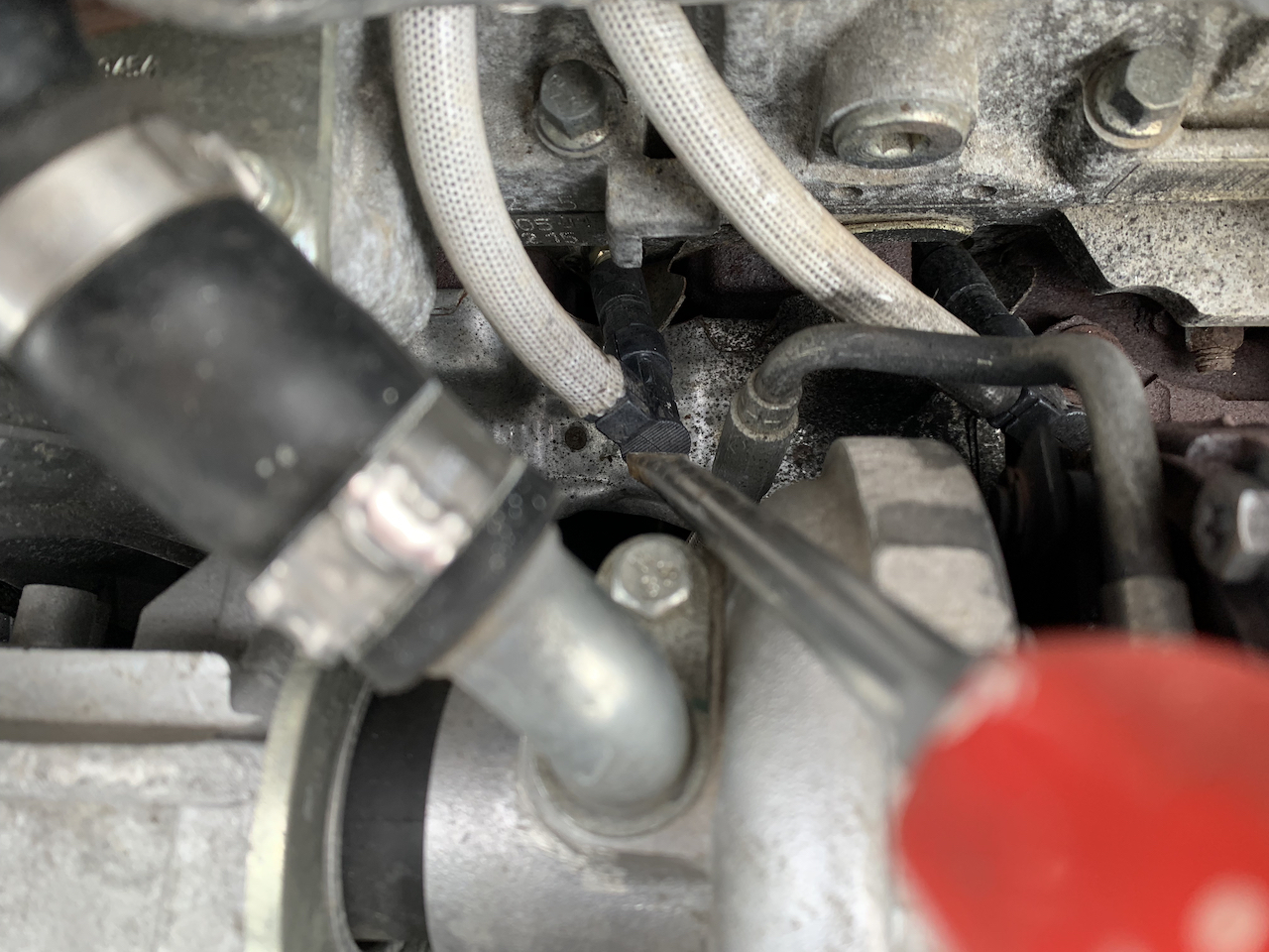

- Using a 'pick' tool, I was able to unclip the glow plug lead by pulling it straight towards me and move it to one side. (At this point, you can test each plug with a multimeter to find the faulty one. In the photo with the magnetic tool on the plug, it's attached itself to the metal pin you need to be testing) )

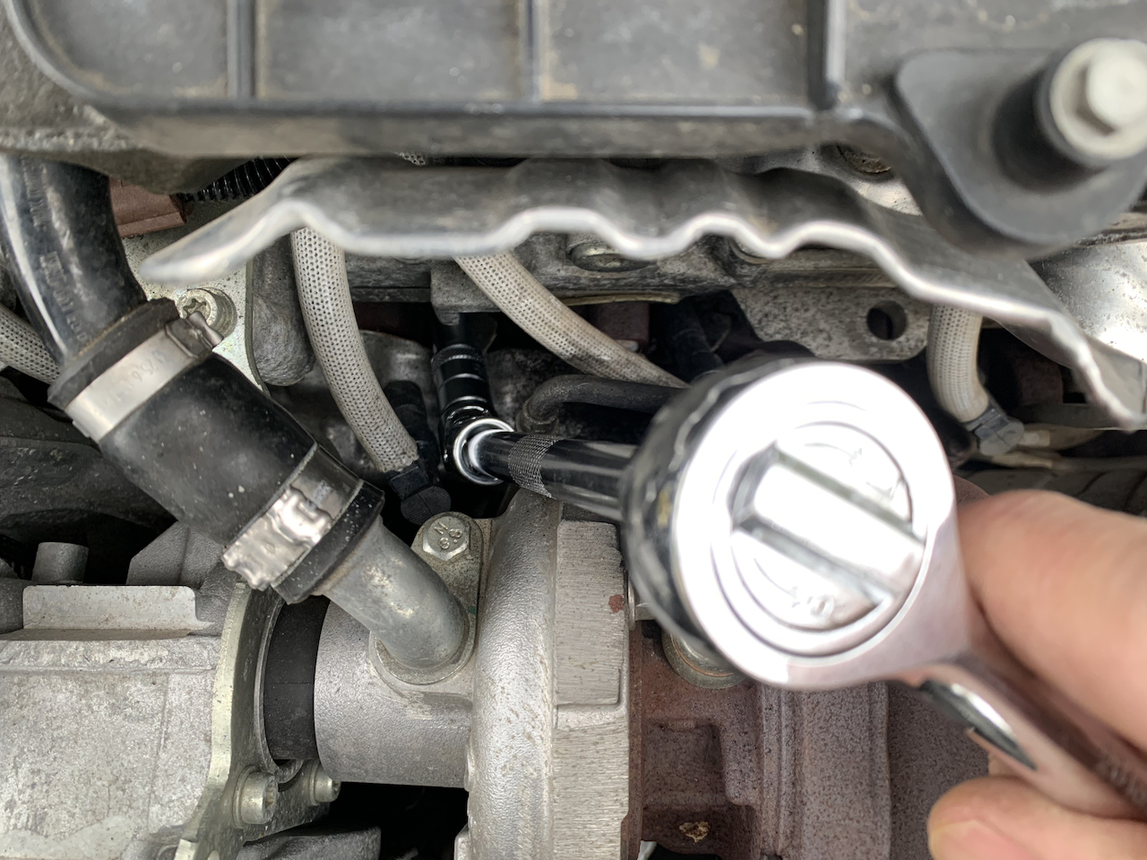

- The glow plugs need an unusual, 9mm socket. I used a 6-sided (high torque) deep socket (much less likely to round anything off than a 12-cornered one), coupled with a universal joint and the long extension of my 3/8" drive socket set. The plug was 'tight-ish' but not hard to initially loosen, and then unscrewed easily. Note it's a long and fine thread so needs lot of turns to fully remove.

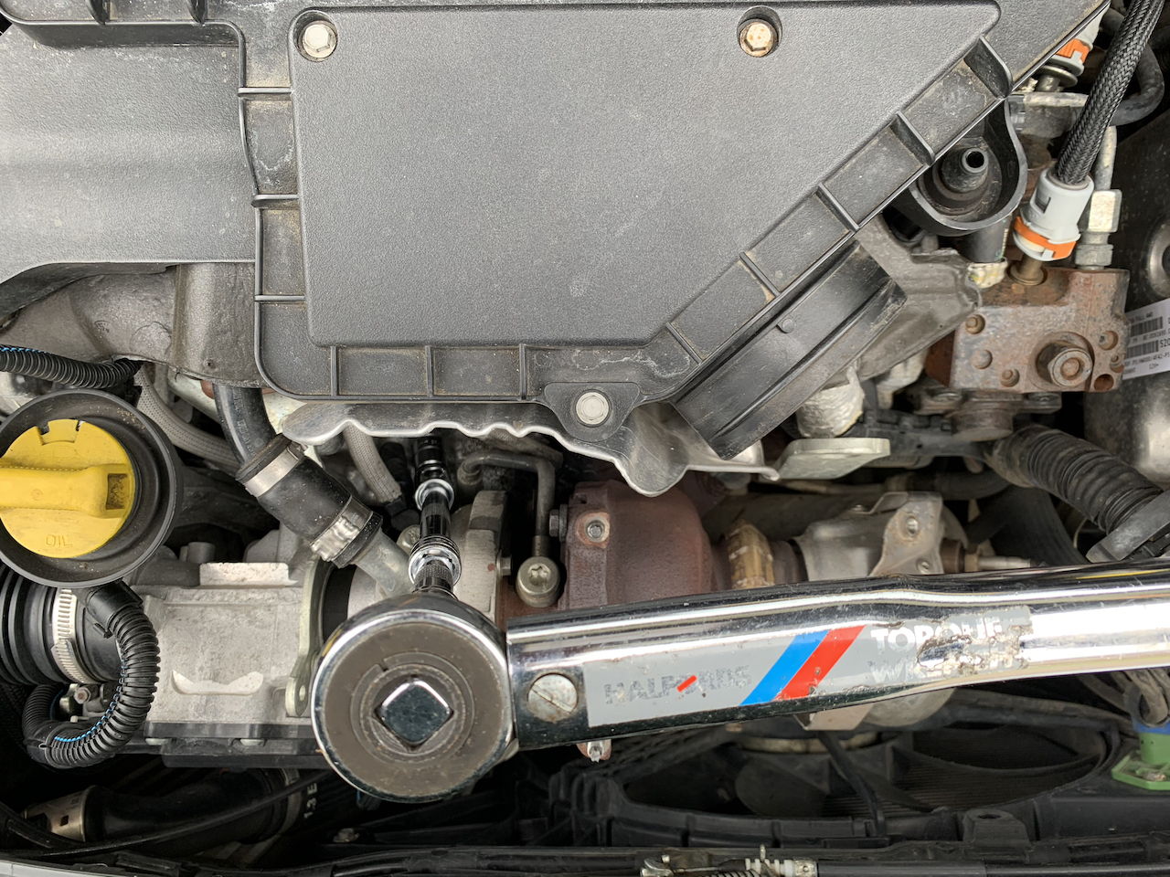

- The torque wrench setting for the plug is just 12Nm - that really is just finger tight and the tiniest tweak further...

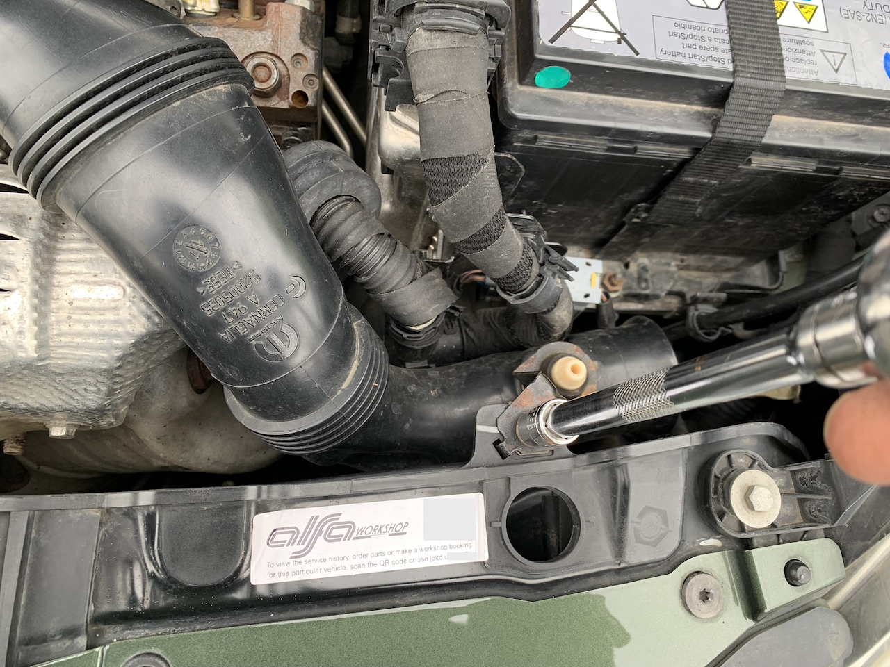

- Reiterating the point that (unlike mentioned in some other posts) it is a 9mm socket that's needed, with a universal joint too. This is a 3/8 drive that worked well in the fairly confined space.
