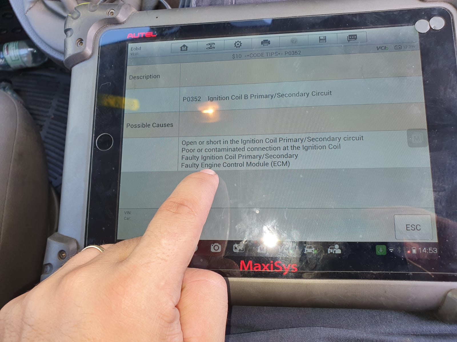

Hello. I have a Fiat Panda since 2008, 1.1 engine, in the UK if for a while the LED was on, check the engine and I haven't given importance but for some time it is only lit, and the car does not accelerate normally and when it is on the spot trembling from all joints plus increased gasoline consumption. I was at the service I changed everything on it, injectors, electric coils, cables but the problem persists. I tried to reset the ECU but nothing, it works ok for 30-40 minutes then it goes crazy. What do you think it could be? I do not mind them at all and as if I would not throw away to change ECU only as the last option. I also attach the picture from the tester as it can help and thanks in advance for the help.

Try going up a little further, to post #51 . The connectors at the engine ECU can cause issues, this has been reported before on other threads.
Carefully remove the connectors and check them all for signs of burning. Prod each pin gently to check they are firm. If any are loose, this may mean opening up the ECU and soldering them, others have reported success at this, but care and skill with a soldering iron is needed.
The female connectors in the plugs may beed a bit of a squeeze to ensure they are tight.

There have been many threads in the past, mainly Punto 2/2A, with loose pins at the engine ECU. These have given symptoms similar to the ones experienced above. I seem to remember an occasional Panda with similar issues.
I agree that these pins are unlikely to become loose unless disturbed, but with an older vehicle it may have succumbed to clumsy handling.
Solder joints to the circuit board can test out ok, but any crystallised solder (dry joints) will eventually crack leading to these problems. The issue is manufacturing defects not faulty connectors.
Cracked wiring conductors are also manufacturing or design defects as the wires should not fitted where vibration can fracture the metal.
