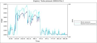

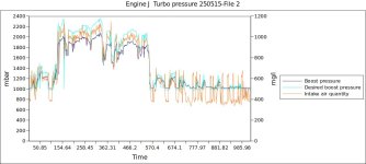

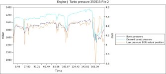

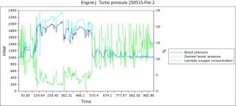

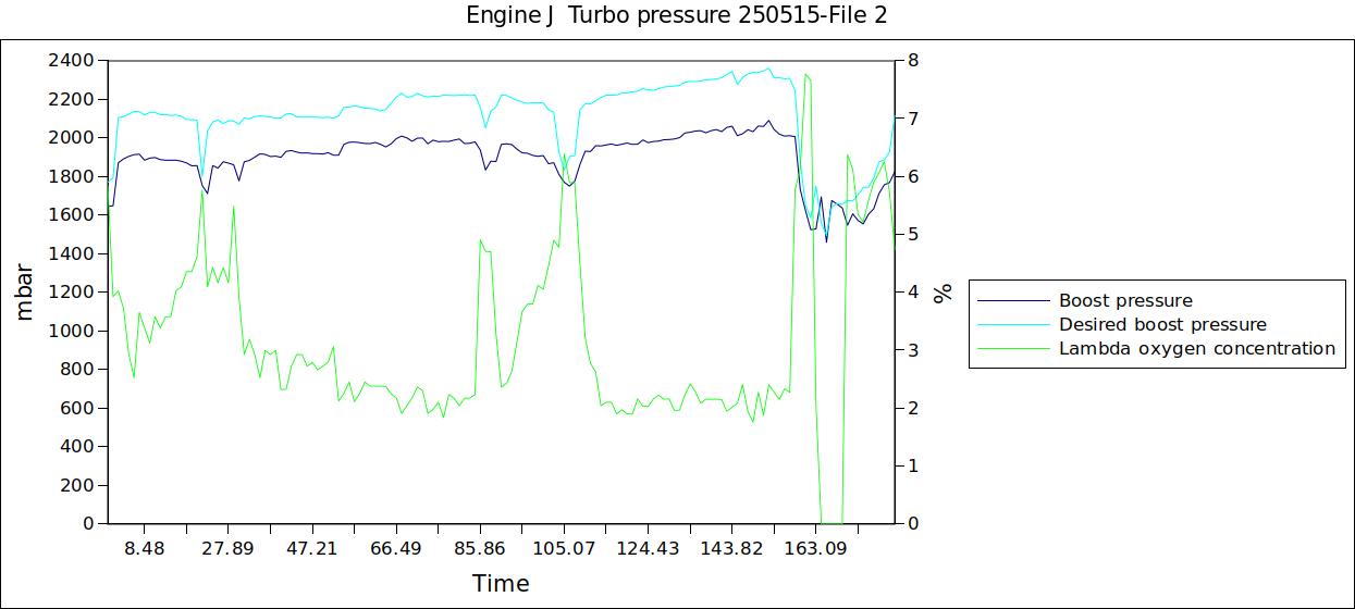

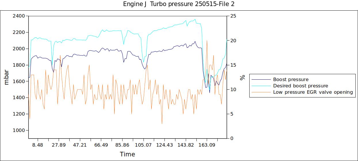

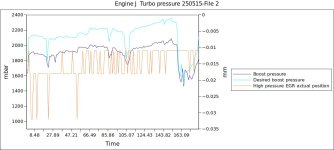

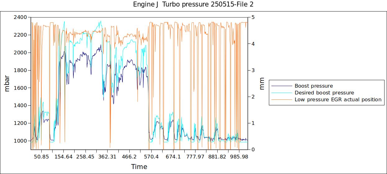

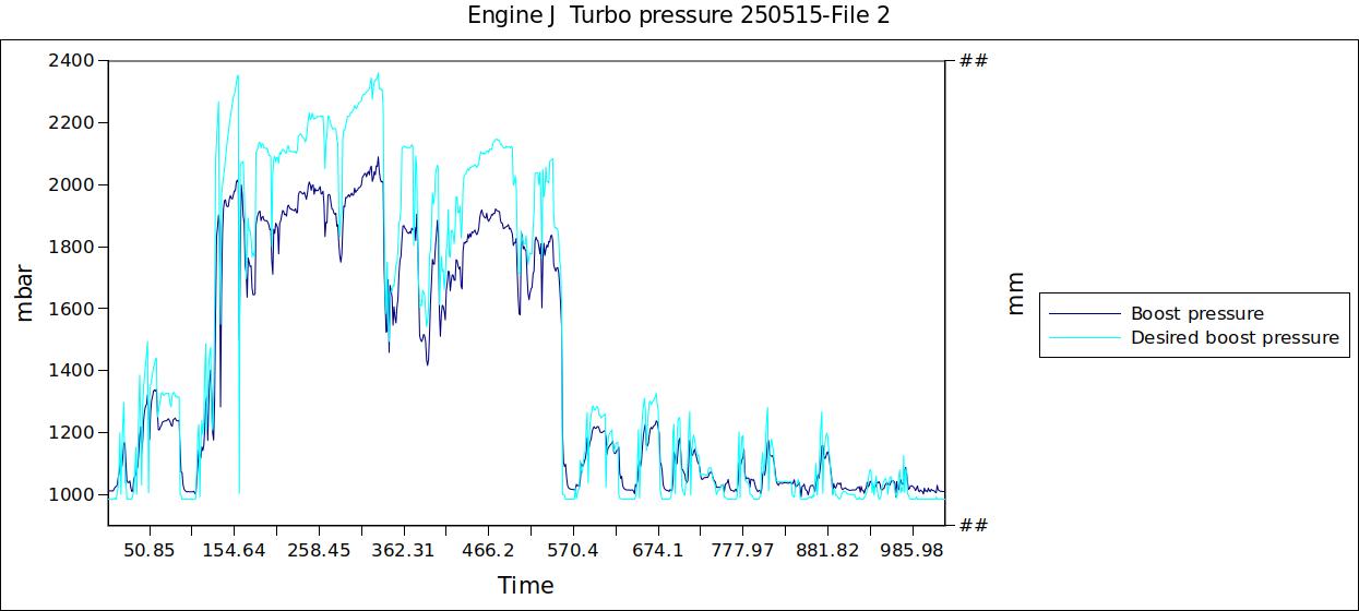

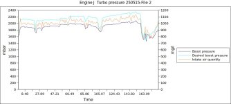

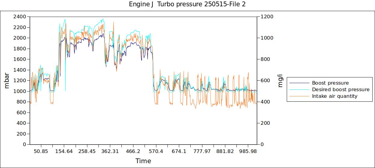

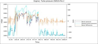

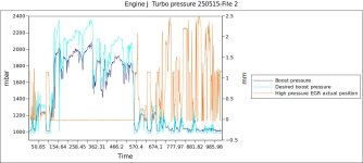

@jansla a slightly different tack with tonight graphs only looking at the Turbo but with other values superimposed. AS yet i have not done this with my engine results yet so no results to compare with. Its soon time for bed so I will leave it for others to comment. @deejays I think this was what you were suggesting in a previous post.

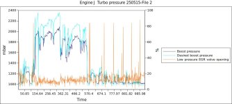

Just added the LPEGR graph
Engine J  Turbo pressure 250515-File 2-1.jpgEngine J  Turbo pressure 250515-File 2-2.jpgEngine J  Turbo pressure 250515-File 2-3.jpgEngine J  Turbo pressure 250515-File 2-4.jpgEngine J  Turbo pressure 250515-File 2-5.jpgEngine J  Turbo pressure 250515-File 2-6.jpgEngine J  Turbo pressure 250515-File 2-7.jpgEngine J  Turbo pressure 250515-File 2-8.jpgEngine J  Turbo pressure 250515-File 2-9.jpgEngine J  Turbo pressure 250515-File 2-11.jpgEngine J  Turbo pressure 250515-File 2-12.jpg

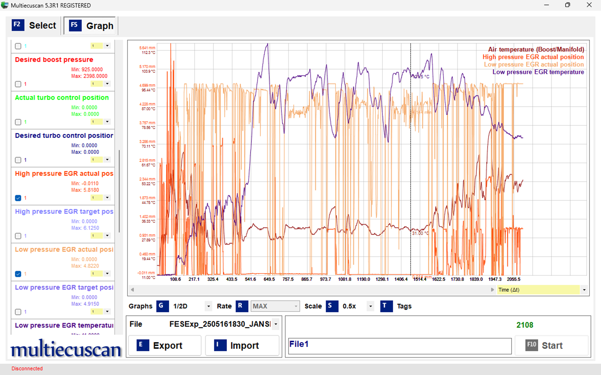

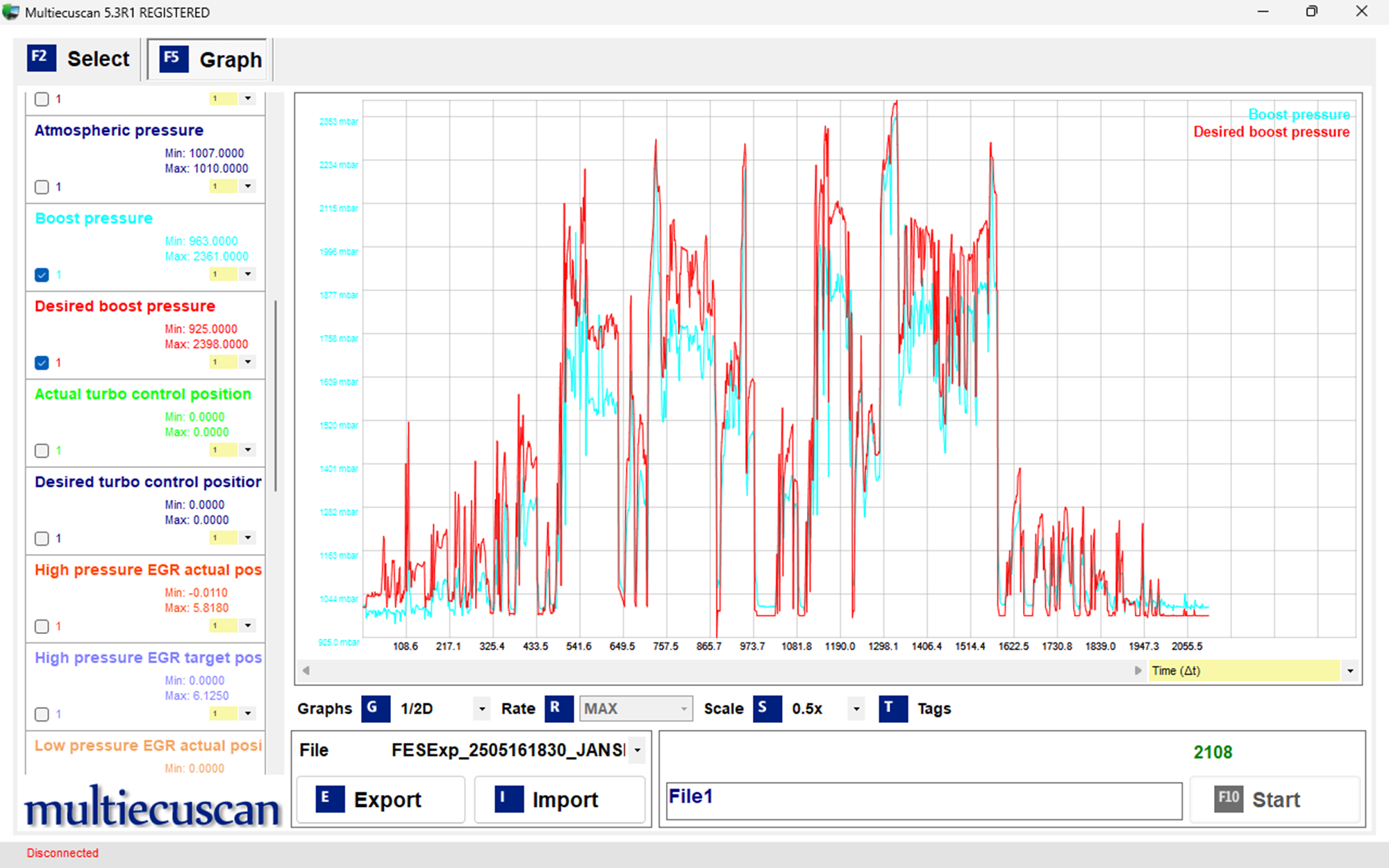

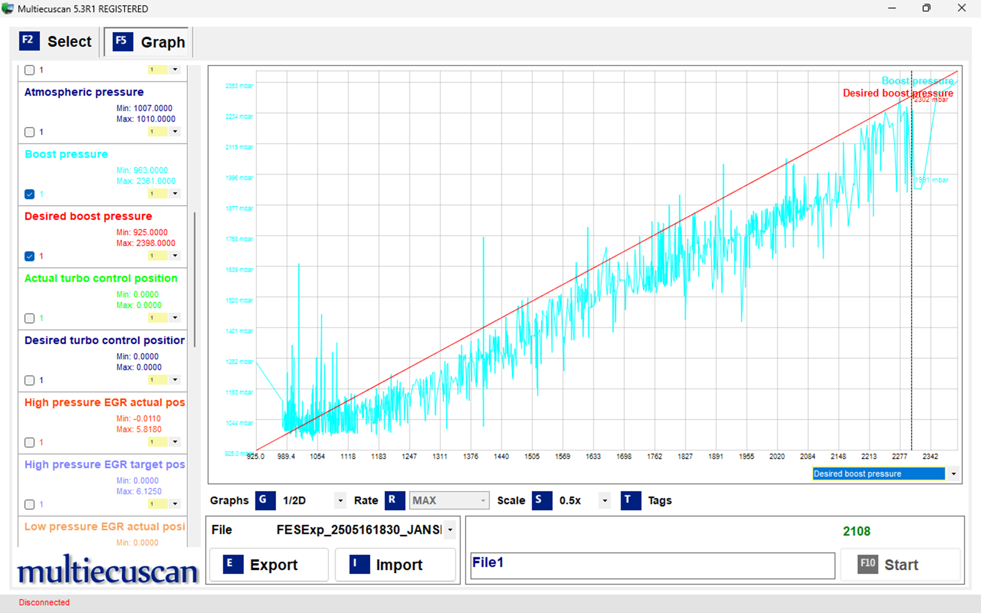

  • FESExp_2505161830_Fiat Ducato (type 290) 2_3 Multijet_File1.csv
it was 34km, exactly the same route as previously recorded on files FESExp_250515..., the temperature gauge reached usual position after about 3km. The csv file shows that the engine got to 80C at the row 414, and the time stamp 556s, so why 33C?

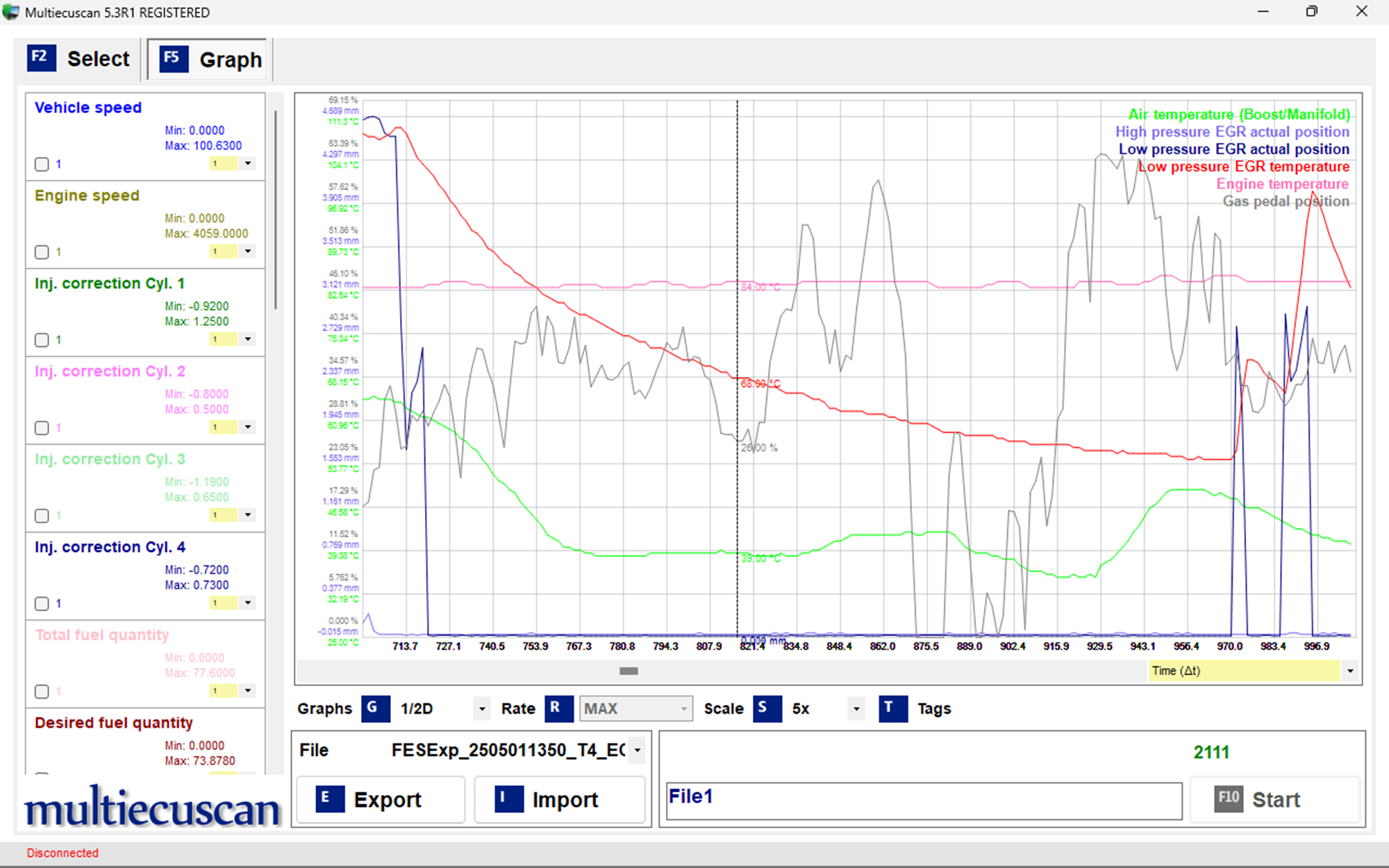

@jansla I think that perhaps MAP temp was mistakenly read as Engine temp by @theoneandonly . The Engine temp is fine, but I have my doubts about the MAP temp. Report about to be uploaded.

Having said all that that, let’s move on and have a look at the data.
Fuel Quantity, Air Quantity, HPEGR and LPEGR all seem to line up as to Actual Position achieving the Desired/Target position, so those actuators at least can be confirmed to be following the directions of the ECU commands. I won’t display the graphs here – I encourage you to have a look yourself to confirm.
The Atmospheric Pressure and MAF Air Temperature would also appear to be reporting correctly, although you can confirm that precisely yourself.
The Boost Pressure is an issue across the Time, Pressure, RPM, and Speed Domain. Following are two graphs showing first, Time domain, then Pressure domain. RPM and Speed range require active toggling to view so are not shown here, but you can do so yourself if you want to view it. The boost pressure is down some 10% to 12% of where it should be (but again, what program is it responding to?).
Time Domain:
Pressure Domain:
The question of course is, what is causing this discrepancy? It could be a failing turbo, it could also be a near blocked LPEGR cooler, it also could be made worse by a congested intercooler. Understanding the turbo vacuum solenoid and associated components as well as the MAP sensor have been checked and or replaced and confirmed to be working correctly then those components will not be part of this consideration.
Let’s move onto the elephant in the room, shall we?
The LPEGR valve is rarely observed to be modulating linearly and when it does, it is at the high (open) end of its range. Coincident with this, the recorded LPEGR Temperature is high and judging by the “reference” of my engine data, the MAP Air Temperature should be in the range of 50C to 70C but instead is hovering much lower at approximately 30C. If the LPEGR valve is wide open for most of the time with a high LPEGR Gas temperature, then why is the MAP Temperature so low? One explanation is that the LPEGR cooler is significantly blocked, but not totally, thus allowing some high temperature gas to flow, but not enough to raise the MAP temperature. (But this is not the same engine as the “reference” and has had modifications applied to the ECU). The MAP temperature sensor can be confirmed as working correctly because it can be observed that when the HPEGR valve opens it causes the MAP Temperature to rise to the expected temperature range. So, perhaps a blocking LPEGR cooler then? Or perhaps a failing turbo? Or both? Or something else?

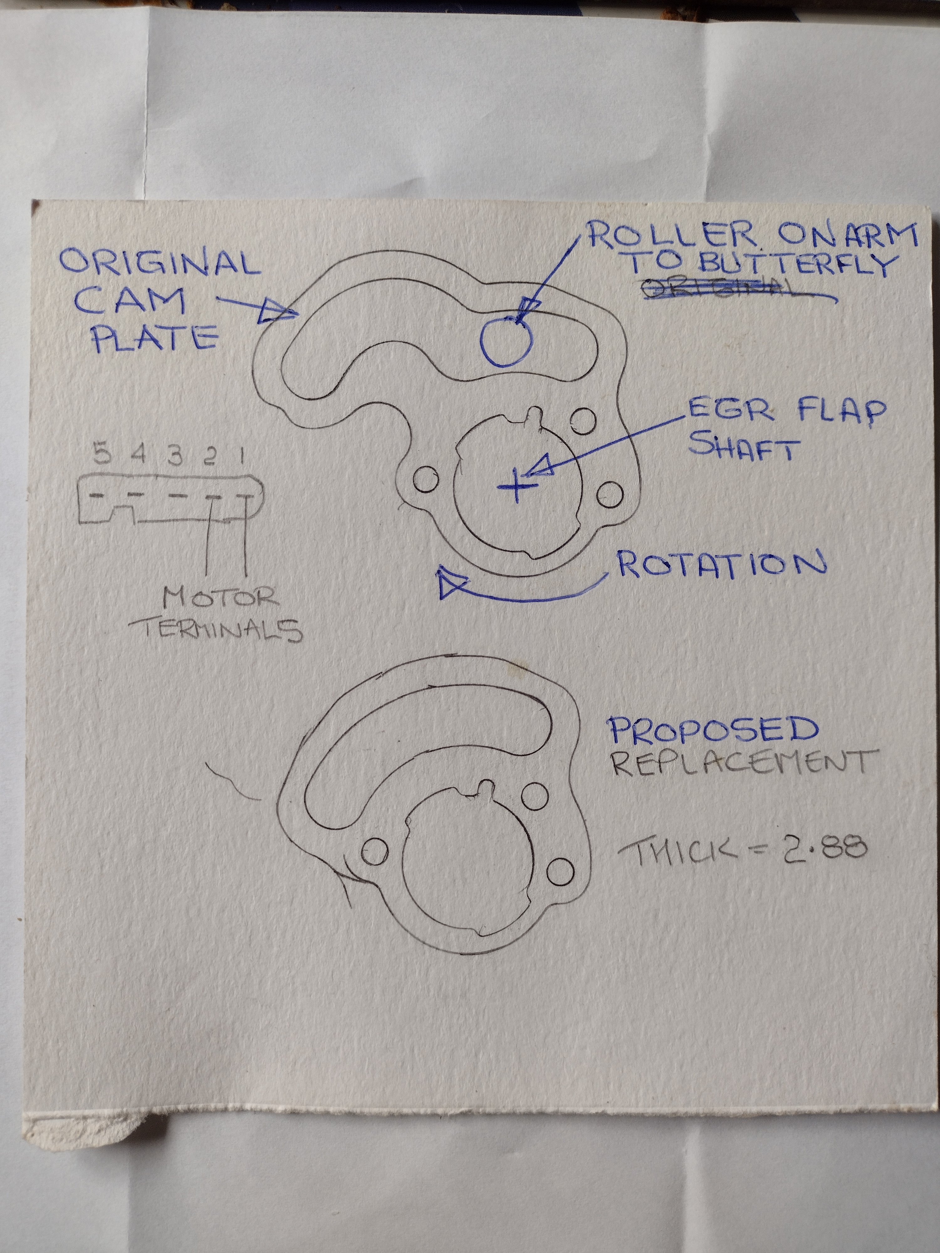

@jansla @deejays , I confirm I bought an LP EGR off eBay to enable understanding. I took the cover off. Inside is a single 12 v motor via gearing drives the EGR flap shaft. Direct mounted on the flap shaft is a cam plate. Look at my drawing, there is a shaped internal slot with a roller follower. The roller is on an arm from the butterfly axle/ shaft. So when the EGR flap is driven say to 50%; the butterfly is inactive. Over 50% then the camplate moves the roller follower to then close the fresh air butterfly.
The EGR was rusty inside (from their cleaning it) so it went back for refund.
Although I operated it by hand I cannot recall definitive but I think it closes the butterfly 98%.i said 98% because memory tells me that the butterfly hadn't marked the inside of the casting so wasn't touching.
I was thinking about making a new camplate fir testing in mine, however I've yet to figure out how to remove the LP EGR without first removing the DPF, alas I'm not fit for mega sub frame removal to access the DPF .
As said, on earlier page I did add photos of the LP EGR, do also take note that there are at least two models, I suspect the 150/180 turbo inlet attachment is different.
I have perused cutting an access porthole in the engine bulkhead to enable undoing the EGR cover plate - whilst drastic it mustn't be entirely set aside.

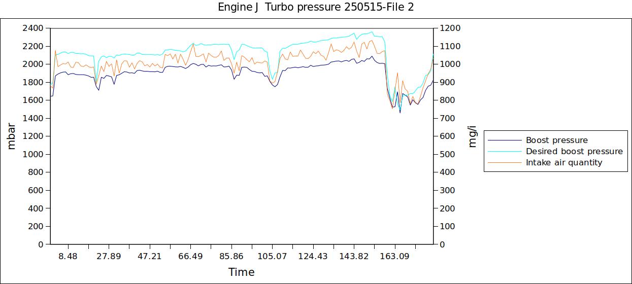

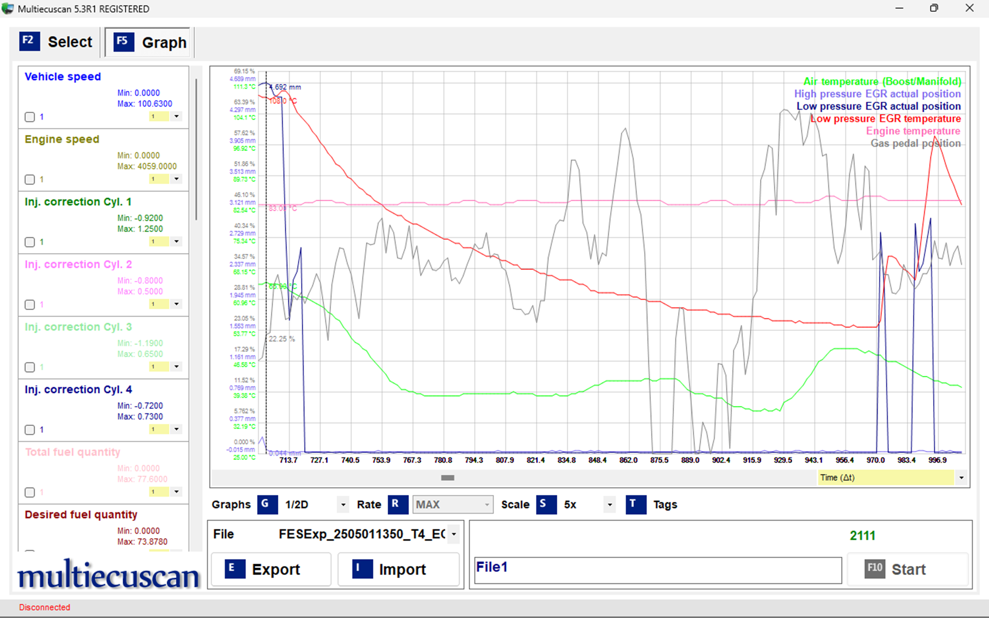

Hi @jansla , I wish to share with you some further snapshots of my engine. This shows pertinent data just at the beginning of a DPF regen phase (burn) and I consider this valuable to further demonstrate what may be the fundamental issue with your engine. Now, they are different engines, but one would think that there would be very similar parameters and responses.
The reason I have picked the beginning of the Regen phase is to demonstrate what happens to the Inlet Manifold Temperature when both the HPEGR and LPEGR valves are fully shut off, as is what happens during the DPF Regen phase.
This is an equivalent situation that would occur if an LPEGR cooler was blocked (or blocking) except the engine is not choked for fresh air. So far as the inlet system goes, it is normal except there is no EGR.
The following graphs are all the identical snapshot. Graph No. 1 is an overview with a vertical line drawn in the middle to show parameter values on the graph.
Graphs No. 2 to No. 4 are identical with three parameters removed to allow scale change for detail and decluttering the graphs.
Graph No. 2 - the vertical line drawn just prior to Regen showing the LPEGR valve modulating, near full open, LPEGR Cooler Temperature high, and Inlet Manifold Temperature in the normal operating range at 66C.
Graph No. 3 – The vertical line drawn approximately 115 seconds later after both EGR valves have shut, showing the fall of the LPEGR Cooler Temperature as there is now no gas flow, and also the rapid fall of the Inlet Manifold Temperature down to a very much stable 39C give or take a few degrees purely dependant on throttle opening and thus engine loading, power, boost etc. The fall of the LPEGR Temperature is not of consequence here. What is of consequence is the fact the Inlet Manifold Temperature is regulating in the very similar range that your engine is exhibiting with a fully open LPEGR valve and a high LPEGR Cooler Temperature.
Surely this points towards the issue being a blocked, or nearly blocked cooler does it not?
Graph No. 4 – The vertical line drawn later again, to demonstrate the area where the Inlet Manifold Temperature is influenced by the throttle opening (loading) of the engine.
As has been documented, with the LPEGR near full open, and a blocked or near blocked cooler, then the engine becomes strangled as the LPEGR valve restricts the fresh air supply to the engine. This in turn would lead to low boost levels as the air volume is not available for the turbo to boost.
If the waste-gate was leaky, then one would think that that amount of leak would be reasonably constant and the effect of that on the total boost amount should fall off as the turbo is called upon to provide more and more boost. But it is not. The actual boost is some 10% to 12% down on the required boost across the range. The other issue we face is we are trying to come to grips with how all the various sensors and actuators are integrated and all the various and interrelated feedback loops. However, I suspect the only sensor that controls the boost amount is the MAP sensor – and that has already been replaced. The ECU is reporting that the measured boost is lower than it should be according to the lookup tables written in the software for the given operating conditions. The boost is down across the entire range. If the turbo and the associated vacuum drive components can achieve high enough boost to drive the vehicle at 100kph, then it has sufficient operating range and capability to provide the correct small amount of boost at say, 30kph. But in this case, it doesn’t. I would think that if the MAP sensor is reporting low boost at 30kph, then there is more than enough range to drive the turbo to boost to the correct amount. But not if the air supply is not there.
If I was a gambling man, I would bet the house………., but I am not a gambling man. If I was an engineering man (which I am), I would think the DPF has been broken for some time (witness very sooty exhaust pipe) and the LPEGR Cooler is likely near blocked. If it is something else altogether, then hopefully your garage can find it and fix it; but if it was my vehicle, I would want to at least have the state of the cooler checked before I did anything else.
One thing I have noticed in this thread is that the documented engines with the blocked cooler issue had reported low Inlet Manifold temperatures around the same temperature.
@theoneandonly , can you add any further information regarding the Inlet Manifold Temperature with respect to a good working engine vs blocked cooler syndrome?
Graph No. 1: DPF Regen (beginning) overview, including Vehicle Speed, RPM and Particle Filter Temp. These three parameters will be removed to display detail in the graphs after this one.
Graph No. 2: Identical snapshot as above, with scale changed to show detail and vertical line reference shifted to beginning to show parameter values at start.
Graph No. 3: As above with vertical line reference shifted to show parameter values at different point on graph.
Graph No. 4: As above with vertical line reference shifted to show parameter values at different point on graph.
