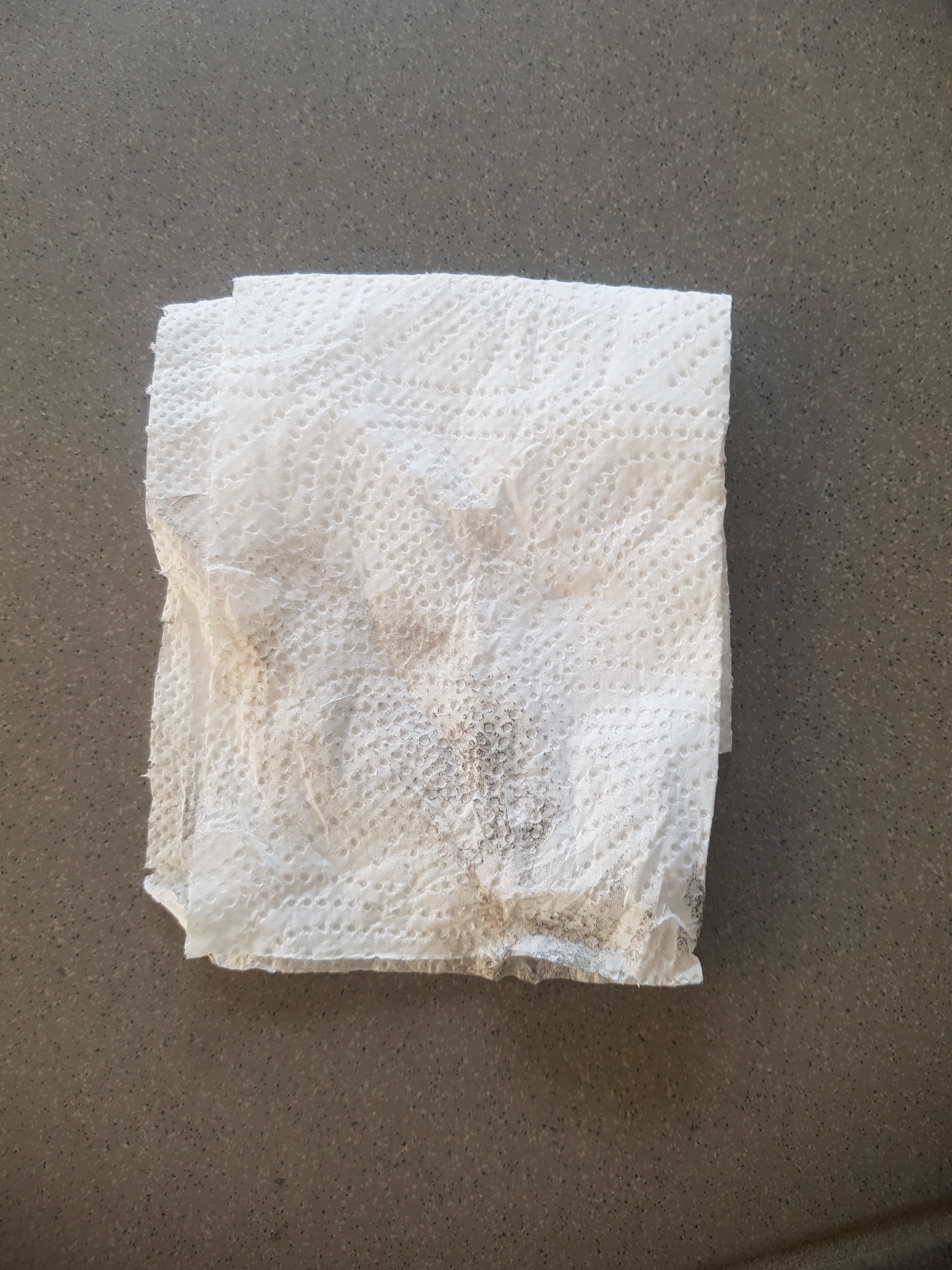

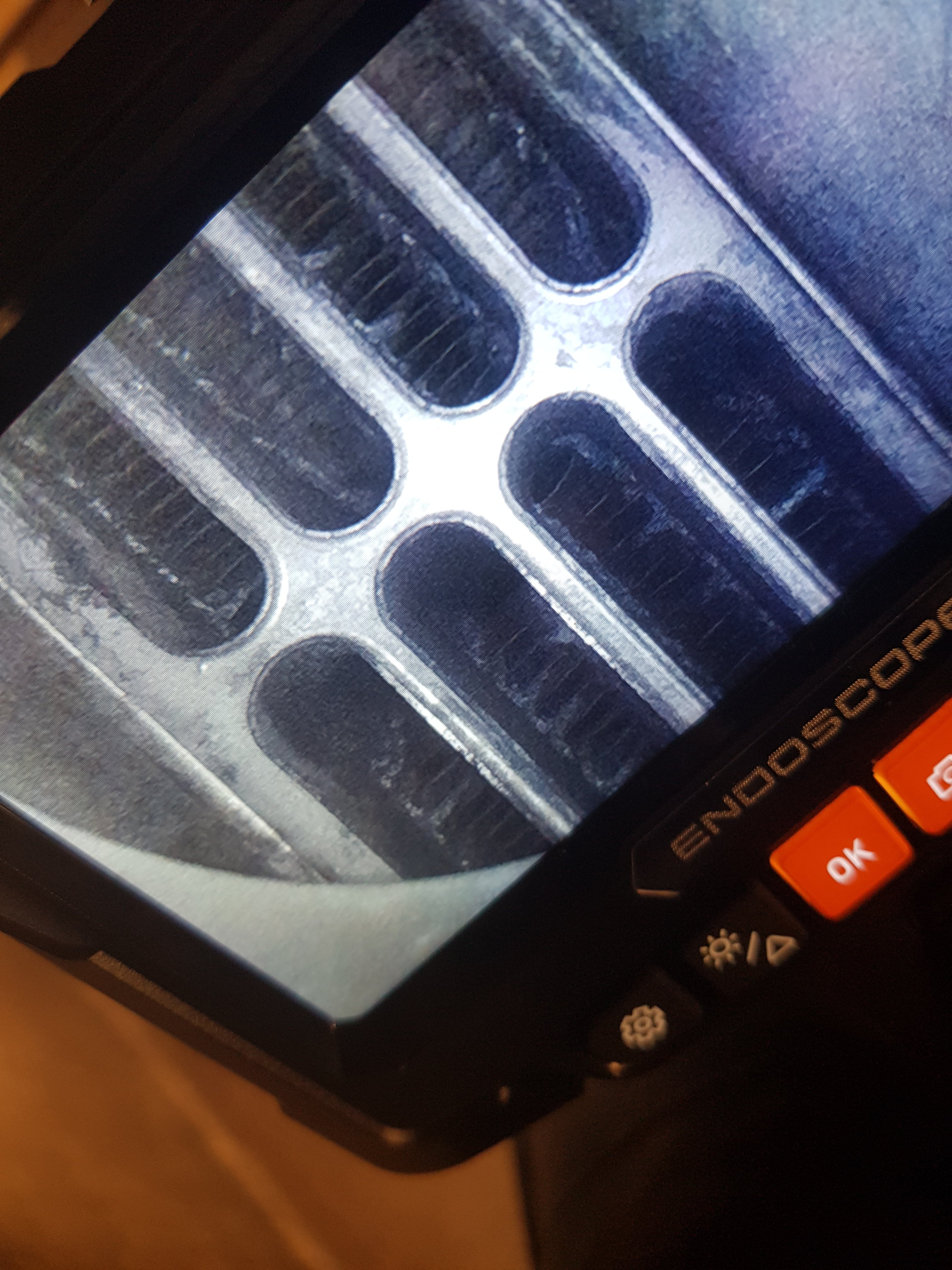

I checked the car for LPEGR problems.
My car Fiat Ducato January 2018 150hp 40K Soft ver 025
I have no problems with errors 401 and 402.
However, I have another problem. On a cold engine, on low and medium acceleration I have a problem with a momentary loss of power. When the engine reaches a normal operating temperature of 90 degrees, everything is fine.
Sorry for the quality of the photos, I don't have an SD card for the inspection camera yet.
I checked for soot, then I checked the MAP sensor. I unscrewed the Dpf Filter connection to the LPEGR cooler and checked with an endoscopic camera what is visible on the filter and cooler. Then I did a test drive according to the recommendations. I am sending photos and files in the attachment.

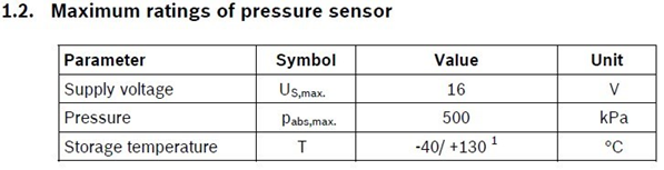

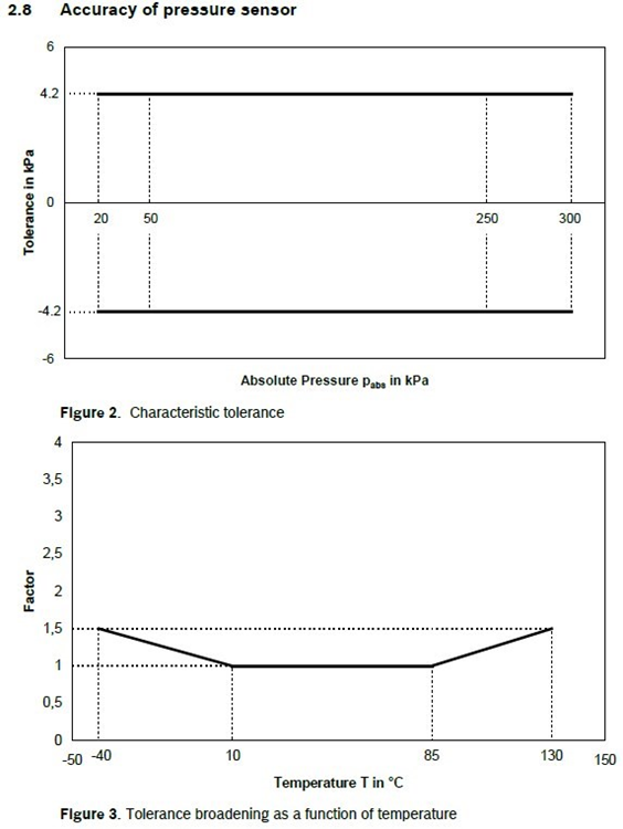

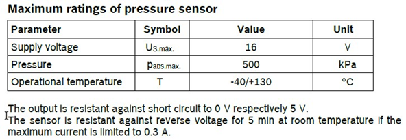

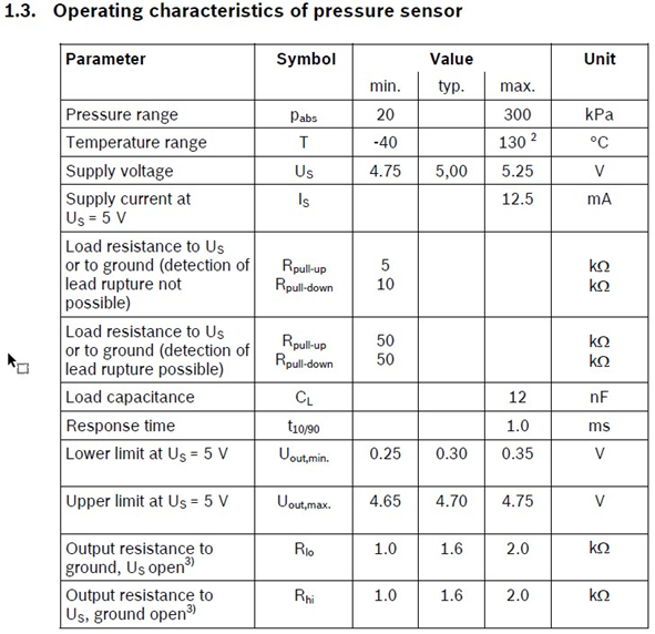

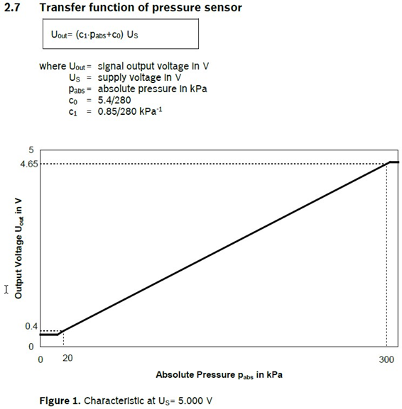

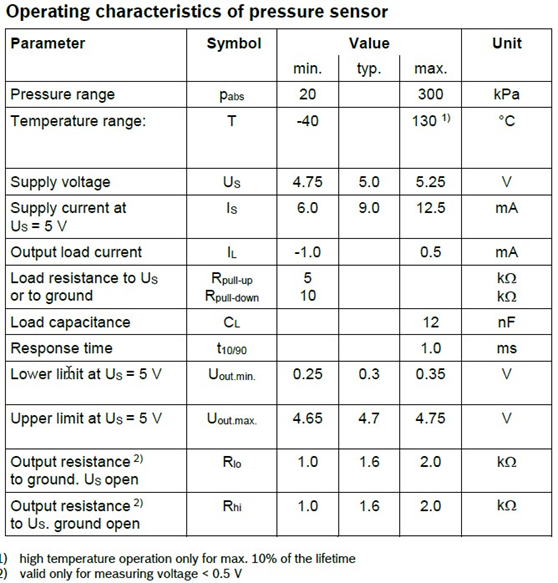

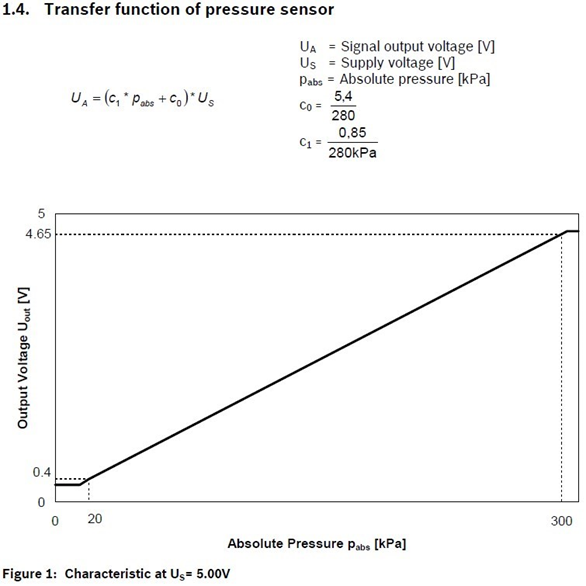

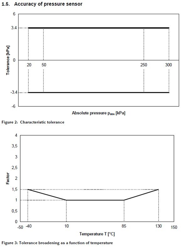

This is a fantastic thread with much collective input, and we must thank the OP for his original detective work getting to the cause and mechanism of the issue.
But the one thing that has always bothered me is the statement and prolific repetition that the Bosch 0281006028 MAP sensor is the wrong one and incorrectly fitted in the factory, never being allocated by Bosch for the Ducato.
Why then are so many Ducato’s with this sensor fitted still running around the world and running very well? It has finally got the better of me – and obviously a few others as evidenced by recent postings on this discussion. I decided it was time to buy a cheap borescope and have a look. No surprise there – my vehicle is fitted with the Bosch MAP sensor 0281006028 as well! Oh no, it has the wrong sensor! I have owned it from new and service it myself – all components as per factory delivery. It is a 2017, 2.3l, 150 with Comfortmatic and pulls like a schoolboy. It was running V.24 SW for most of its life, only updated to V.32 after coming across this thread around a year ago. No issues so far, and the exhaust running clean.

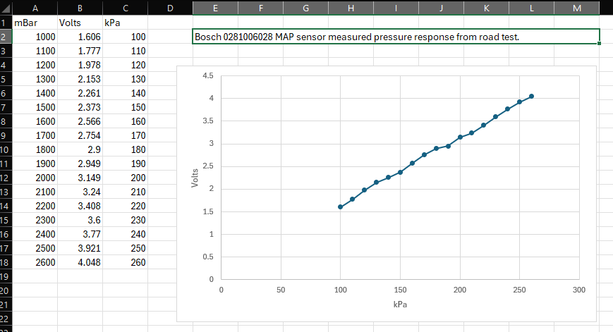

So, first thing I did was contact FIAT PRO and gave them the VIN number. They responded with the correct FIAT part number of 504369148. Oh No! That, according to Bosch is the Bosch part number 0281006076. HMMM! OK, time to dig deeper! I persist with my enquiries to Bosch, and they were fantastic to deal with. They bent over backwards to provide me with as much detail as possible for both sensor numbers. They also gave me permission to post the data here as well.
They had the complete data on the 6076, but not all the data for the 6028 (they were missing the thermistor response data). While I was waiting on the reply from Bosch (they had to communicate with Head Office in Germany for part of the data) I decided to use MES and go for a drive whilst measuring the four data points of interest and then calculate from that data the actual impedance of the thermistor versus temperature of my 0281006028 so it can be checked against the Bosch specified response curve of the 0281006076 which I already obtained from Bosch. Guess what – they track each other! While I was at it I checked the pressure response as well – and that data shows the two sensors are very likely identical.
I will also post the files and the derived spreadsheet of the results. Anyone who has the 6076 sensor and MES could duplicate the test run and compare the outcome if desired to prove beyond any doubt that both the sensors are interchangeable. For the keen of eye, the only noticeable difference between the two is a very slight change in the external plastic moulding, and the 6028 has a more accurate pressure sensor! So, anyone who has removed a good working 6028 and replaced it with the 6076 has a less accurate pressure sensor component! No big deal, but just a waste of money and effort.
To back this interchangeability up, buried in the data from Bosch is one FIAT part number that appears on the Bosch pdf lists of both sensors – and that is FIAT part number 55206797.
So please, can we put this MAP sensor issue to bed? Either the Bosch 0281006028 or the 0281006076 is going to work equally as well in the Ducato. FIAT did not fit the wrong sensor in the factory as originally stated in this thread, and it is not a factor in the underlying issue that this thread is about. In fact, the 0281006028 has a higher accuracy on the pressure sensing component, the thermistor (temperature sensing) is identical.
Readers may find this link useful: https://www.bosch-ibusiness.com/
Bosch MAP Sensor 0281006028:
Bosch MAP Sensor 0281006076:

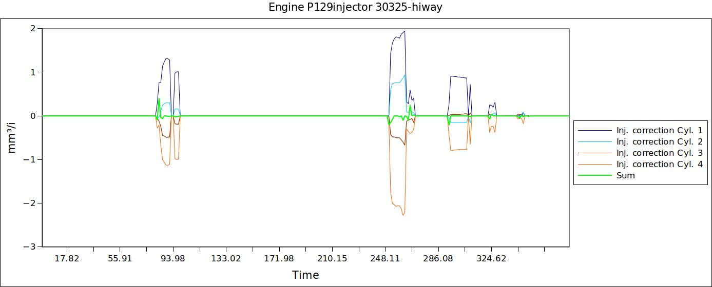

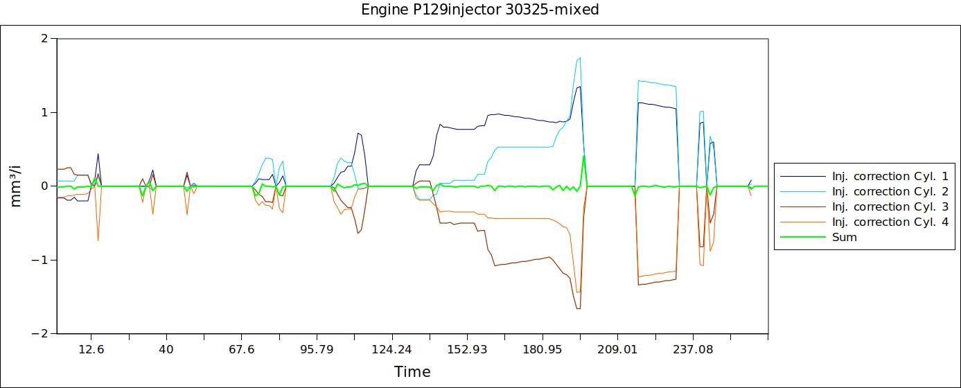

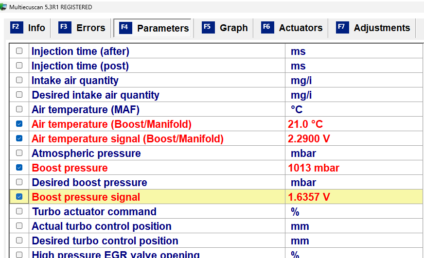

Some nice photos there. With those and the collected data i can say you have not got a cracked dpf/ blocked lpegr cooler.
illustrates good openning of lpegr valve and temperatures.
at temperature the turbo works as it should.
the city and mixed are from cold to warm and show the "actual" pressure higher than "desired".
If the problem was due to the turbo solenoid I would expect it to be tother way around. This orientation could be correct if the pressure measurements were incorrect ie dodgy MAP sensor, however i have seen worse looking ones read ok. if there is a picture of the centre of the sensor it may indicate the MAP as the problem. So first option clean the MAP.
Injector info good.
Have you got any data just before these three? It would include a very useful regen info for V25 (was 7.5 km before these results)
