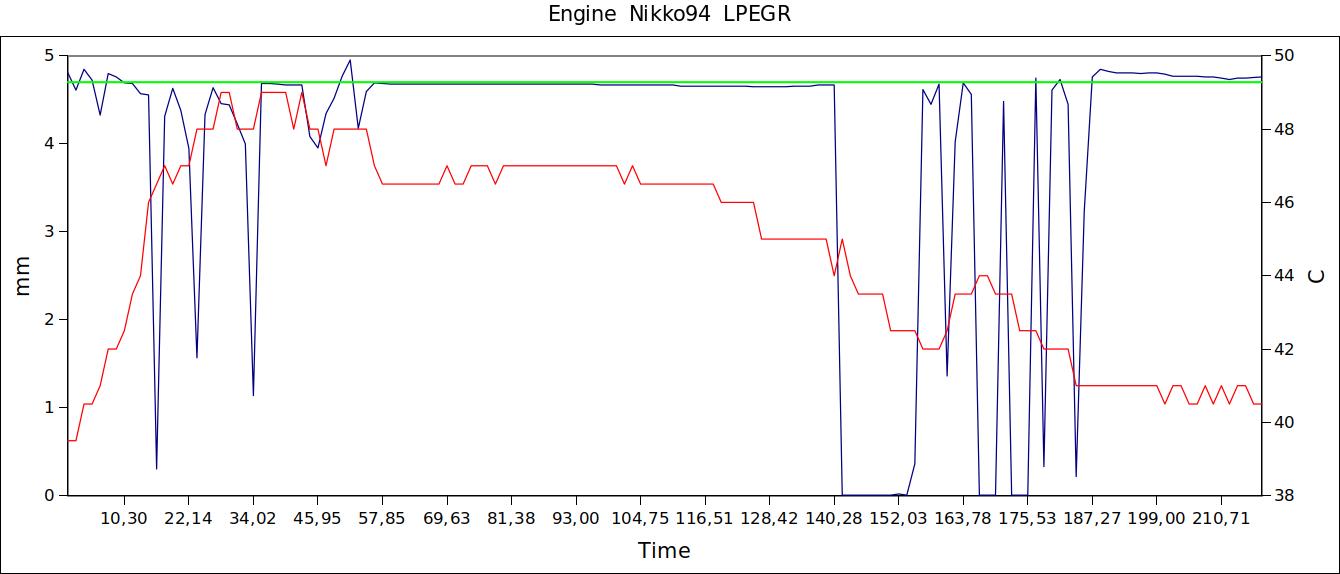

Hello, first of all thanks for the tips and many posts in the forum here. I also have problems with P0401, P0402, P0238. It comes sporadically and quite differently. Sometimes after 15km, sometimes after 80km. I want to keep it short. I got myself Multiecuscan and the necessary OBD adapters. However, I don't quite understand a few things.

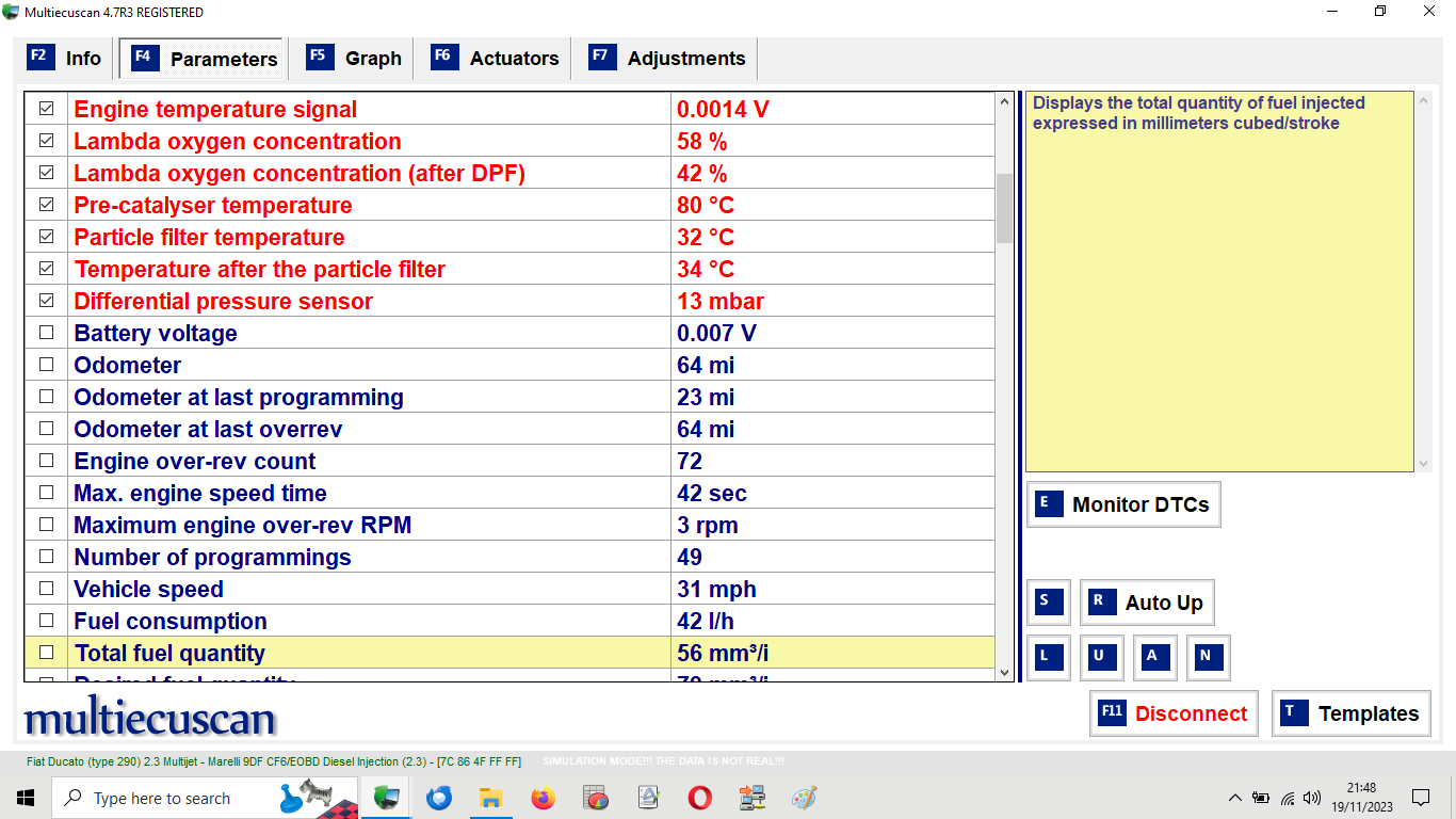

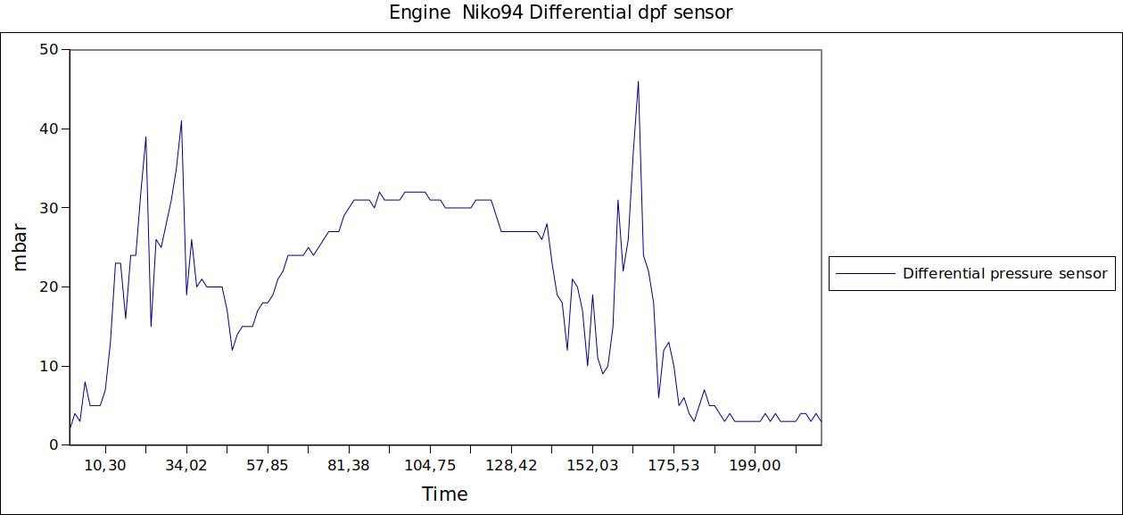

I've done some tests with different temperatures of the car. Then I created a CSV file like in the tutorial. But some data doesn't show me in the editor? But when I import the file back into the multiecuscan you can see all the files in the diagram again?
Is there a list of right and wrong values? For example, this DPF value is OK, this DPF value is not OK?

Can I suggest you simplify test runs, don't try all at once. Graphs will be easier to view.
The tests should be out on the road, engine at temperature and holding a cruise controlled 60mph for say 10-15 minutes.
First do a run looking at LP EGR opening, requested and actual and the EGR temperature. This will quickly show if the cooler is soot blocked.
Next do a run looking at the injectors variances, this should show if you have a good set or any defective.
You also need to check the engine software update, is it a 28 or a 32 or something earlier? Is it a manual or comfortmatic? Is your exhaust silencer tailpipe sooty or spotless?

Template 5 is a good place to start.
If you have a csv file post it here or pm me and i will create some graphs and hope to make sense of it
There are no black and white good bad limmits the lines are a bit blurred but more data i see the less blurred the evidence is.

I have now selected all characters as in Template 5. When I open CSV file, somehow not everything is displayed. If I paste the file into Multiecuscan, then all the information is there and visible!? I'll just add CSV file. Maybe you can still do something with it.
Here are a few more values...
When the vehicle is switched off...

@Niko94 unfortunately the results show you only ran for 3 minutes and the engine is not warm and upto temperature. The important thing to look for is to get engine coolant above 80C and watch the LPegr valve opening in a poor engine it jumps between 0 and 4.7 open to closed with no inbetween values eg 2-3 and low cooler temperature. The 401 and the freeze frame results are typical of a blocked LPEGR cooler. A 10min run after the engine is upto temperature is the minimum to get decent data to confirm a diagnosis.Engine  Nikko94  LPEGR.jpgEngine  Niko94 Differential dpf sensor.jpgEngine Niko94 injector.jpg
All right, thanks for the info. Strange, I thought that the engine was at 83 degrees. Anyway, I'm going to do a proper run for the next few days. I'm just skeptical that I won't cause more damage to the car with more and more testruns.
