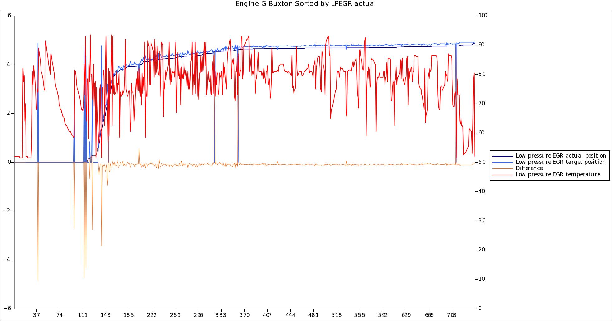

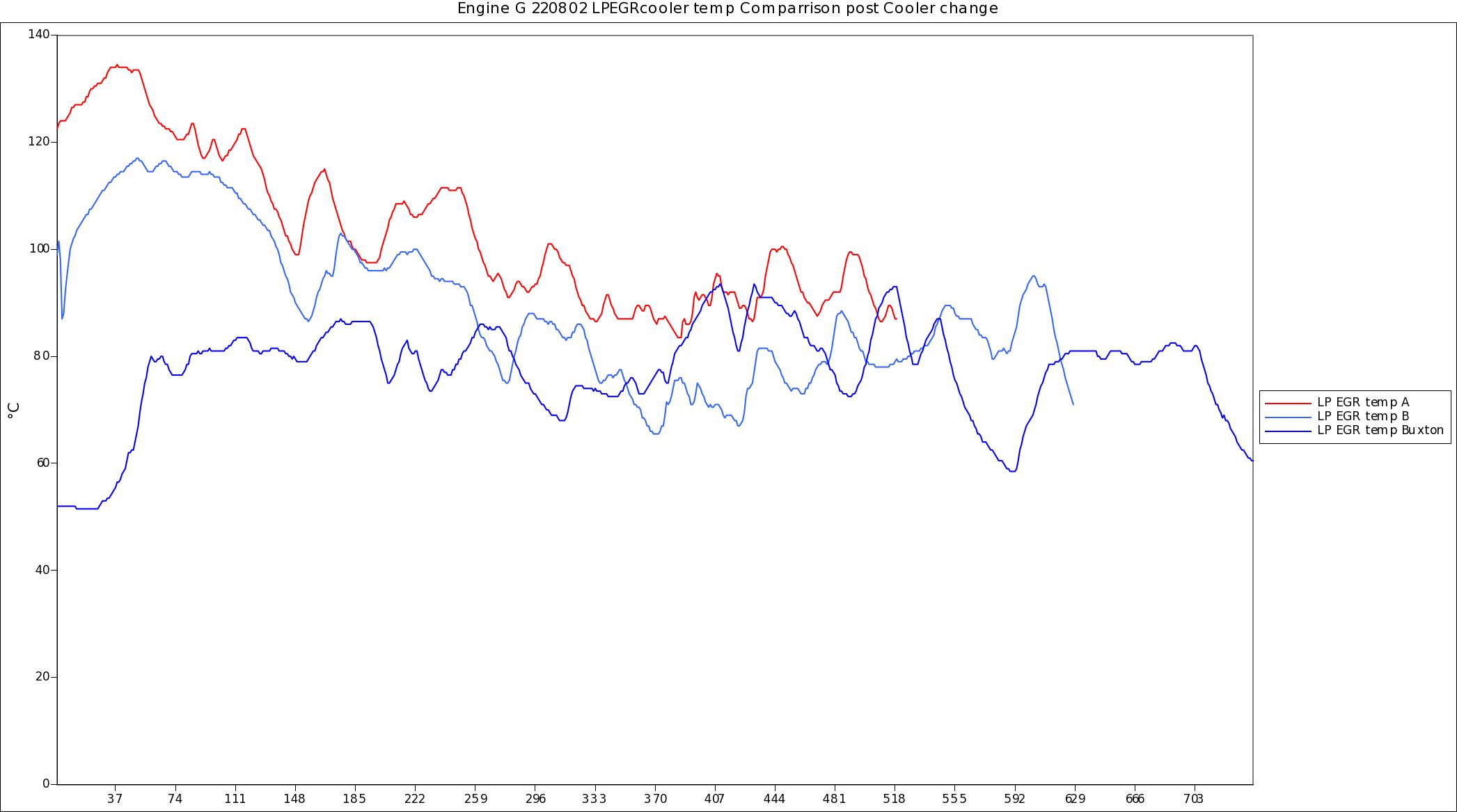

Foot off throttle the LP EGR is always closed so any downhill will only show the static LP temperature say 60-65 degrees as there will be now through airflow of exhaust.

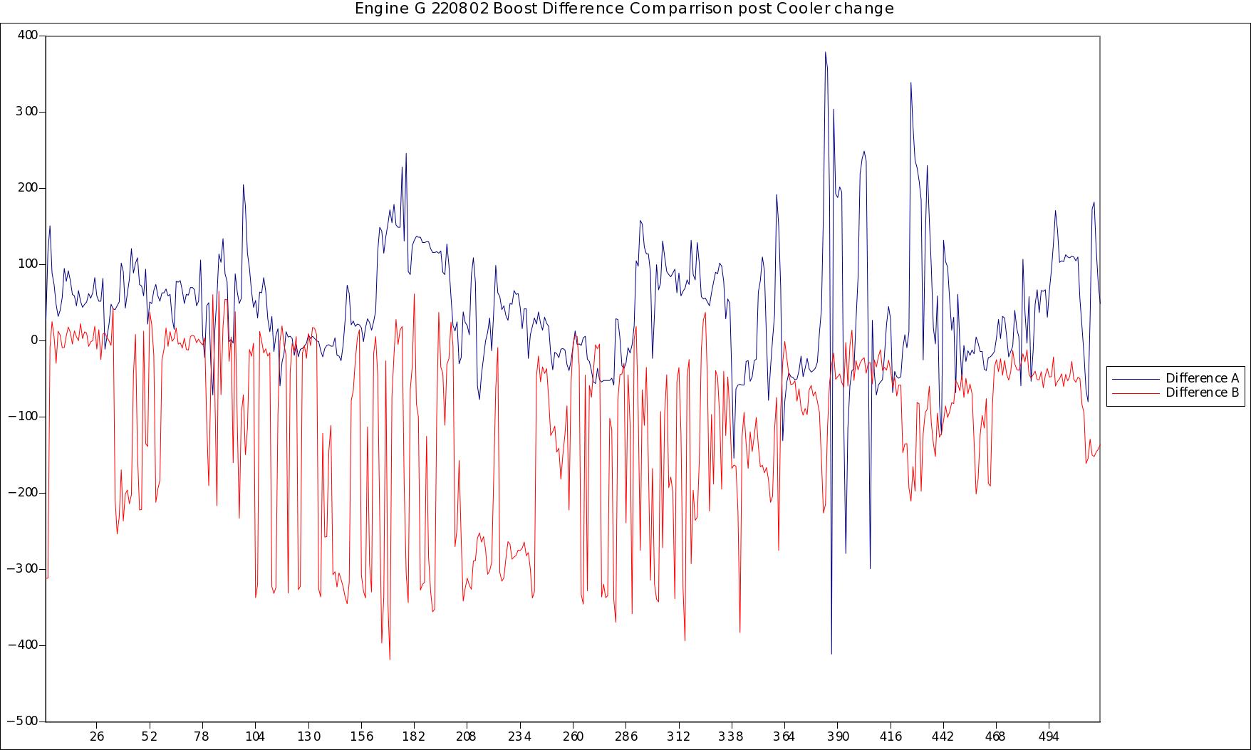

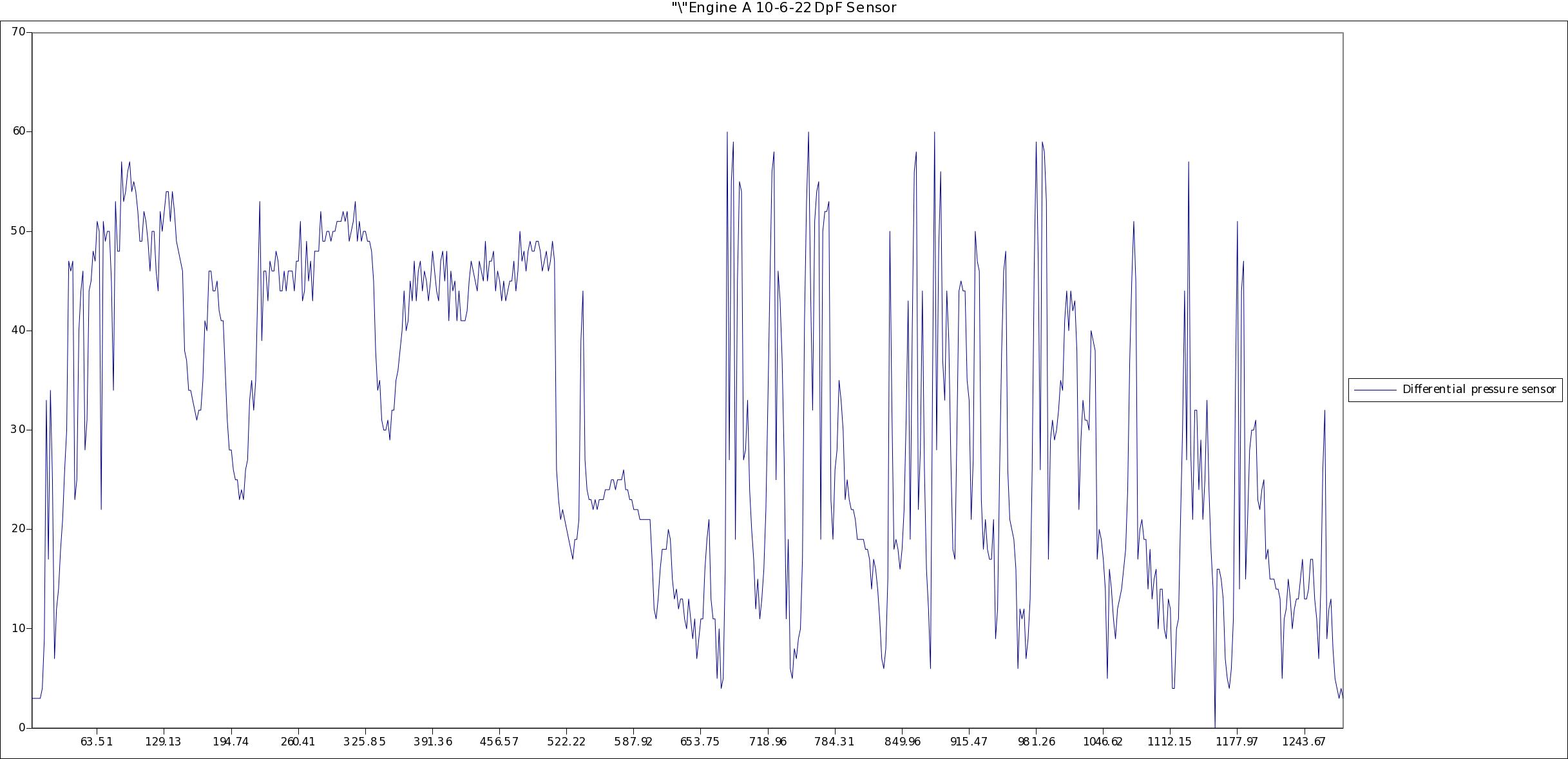

mc | max control value | |||||
spike | Arithmetic max ,eg maybe Physical maximum valve opening |
Engine | Errors | Version | DPF sensor | DPF sensor | Injector max | Injec Sum max | LPEGR % | LPEGR % | LPEGR mm | LPEGR mm | LPEGR C | LPEGR C | HPEGR | HPEGR | air max | max difference | |
Mc | Spike | Mc | Spike | Mc | Spike | Mc | Spike | Mc | Spike | ||||||||
A | 0 | 28 | 66 | 3.6 | 0.6 | 86 | 4 | 4.6 | 121 | 2.5 | 2000 | 200 | |||||
B | 1 | 32 | 220 | 300 | 5.8 | 1.2 | 4.4 | 4.6 | 75 | 87 | 4.7 | 857 | 20 | ||||
C | 1 | 115 | 120 | 3 | 0.9 | 0 - 84 | 84 | 4.9 | 4.9 | 42 | 47 | 2.5 | 2000 | 300 | |||
E | 0 | 32 | 150 | 180 | 3 | 0.6 | 30 | 85 | 4.7 | 4.7 | 95 | 110 | 3.5 | 2000 | 1100 | ||
K | 1 | 32 | 4 | 5 | 65 | ||||||||||||
G | 1 | 32 | 45 | 60 | 1.3 | 0.8 | 83 | 83 | 4.7 | 4.7 | 100 | 118 | 3.7 | 3.7 | 1350 | 100 | |
S | 0 | 32 | 50 | 95 | 0.6 | 0.1 | 25 | 30 | 3 | 4 | 90 | 110 | 0 | 1800 | 600 | ||
Z | 1 | 23 | 45 | 95 | 1 | 0.6 | 4.8 | 80 | 85 | 2000 | 600 |
Thanks for this, very interesting especially the wide variances between engines which I wouldn’t have expected, although I guess the driving conditions will have been different.Hope this makes sense.All data is from engines i have the data for except K (kang express data published here.)

I've been using Millers ecomax since last December. I can get LP EGR cooler temp up to 100 degrees occasionally on a dual carriageway run however I'm convinced my cooler is still part blocked. I wish I knew if the higher cetain burn does anything after the dpf where it tees off to the LP EGR system.Thanks.
