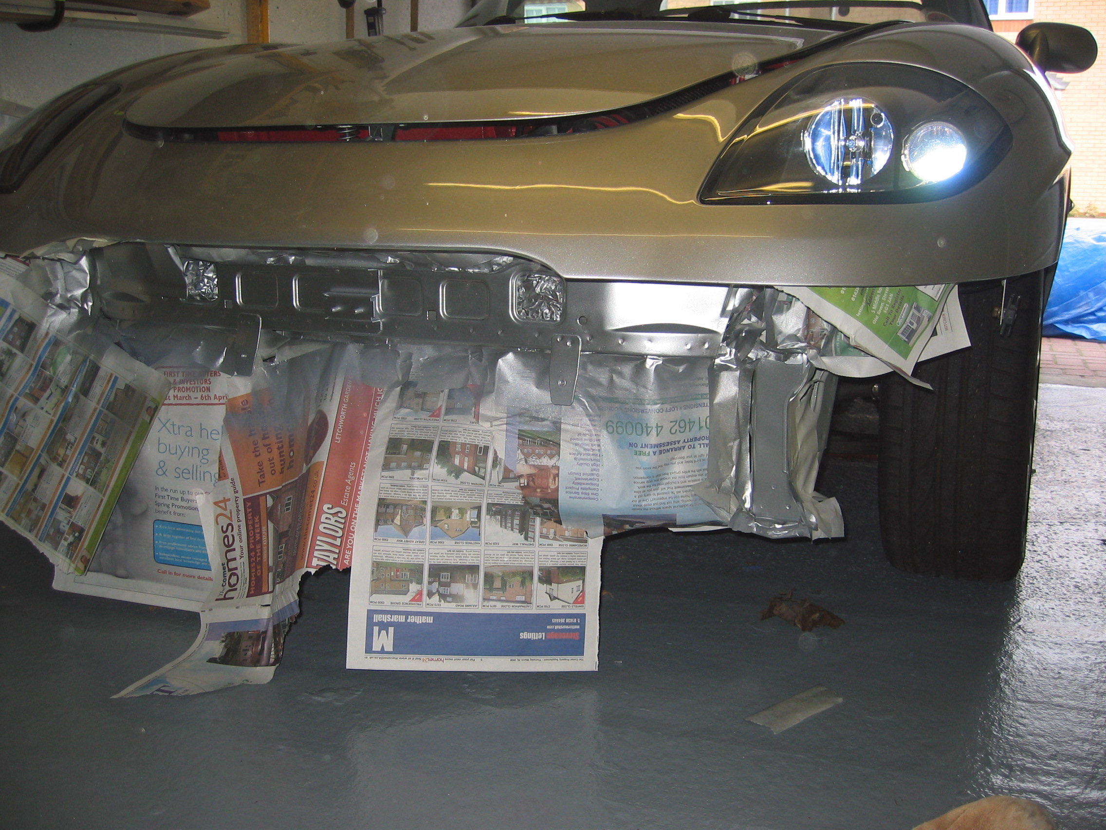

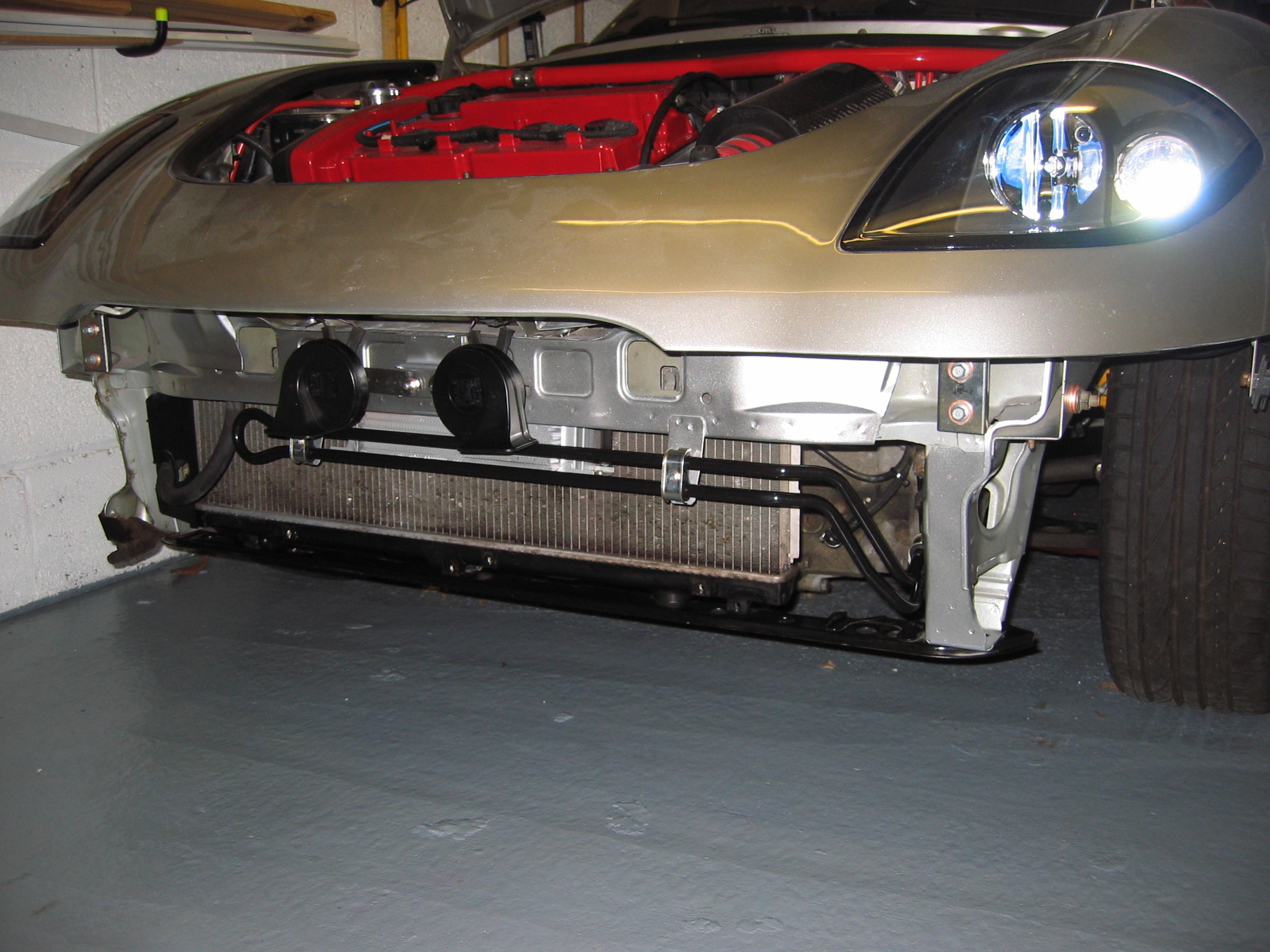

What started out as just fitting the HID headlight kit install has grown into a full front resto project heheh :eek:
I have replaced all the brackets with nice new polished ones and also removed all the little bits of rust that had just started to take hold around the front. I have spent today giving the front crossmember a new lick of paint and just have the clear to do. Once this is finished I have a few things I want to paint red and then I can start putting it all back together.
OK so you will not see 90% of all this once the bumper is back on but it should keep the rust away for a good five or six more years. :D:)
