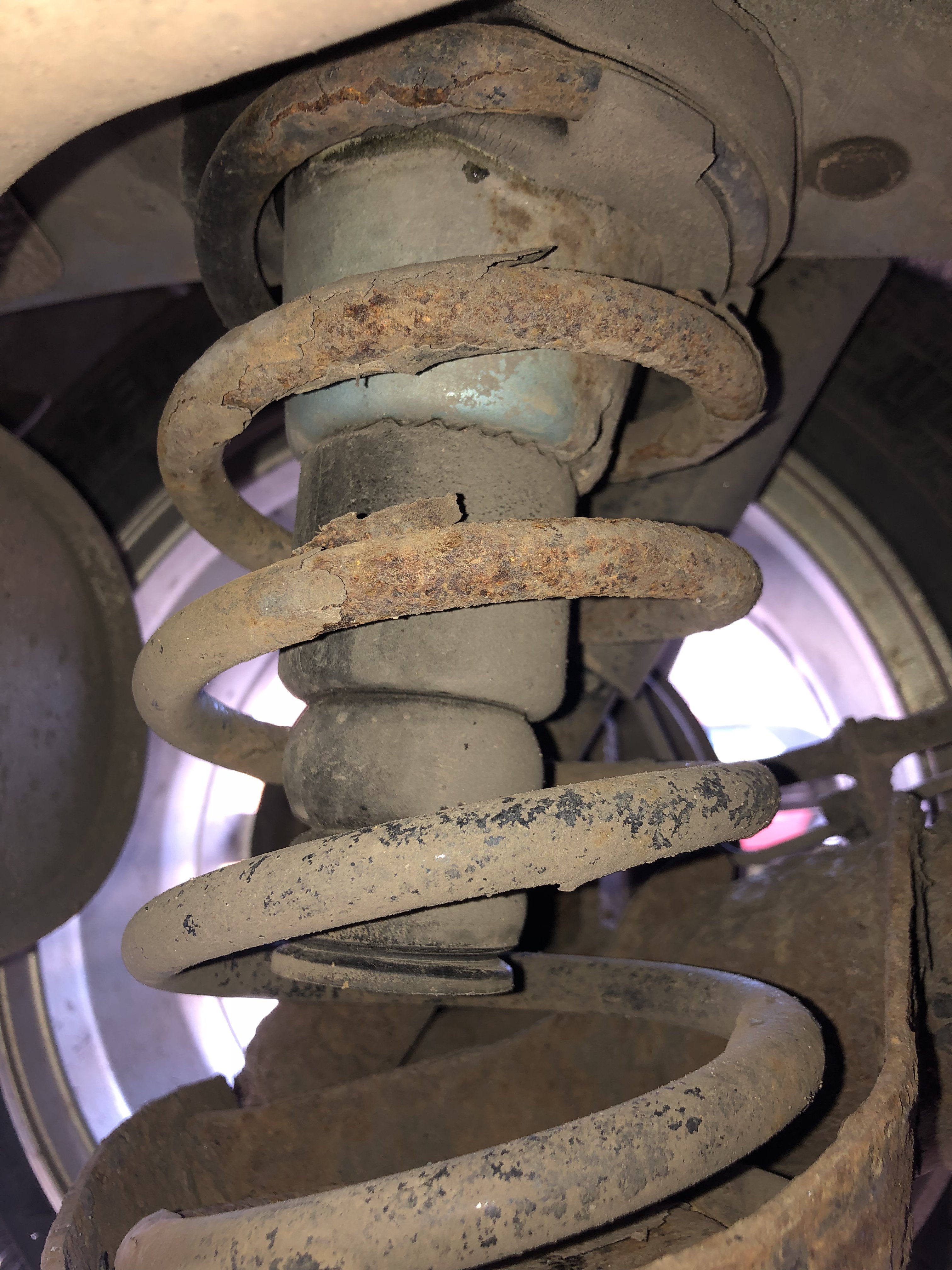

Looked under my 2011 Fiat Panda and saw this:
Seems to be a crack forming on the left.
Are the springs at their end of life as well?

That's worse than my Becky (2010 1.2) and she's had two years of advisories on it now with a "promise" that it'll be failed on it next year. The springs are compromised by the rust pitting which will be forming stress concentrations which increase the likelihood of it breaking. If you're doing the axle it's only common sense to do the springs too while you're about it.

Springs are perfectly fine, no need to change

I'll give you that if the axle was in good condition but with springs looking like this, then I'd be relatively happy to live with them and tolerate the possibility that one might give way. But, if you're fitting a new axle? I'd like to see new springs going in too.
My ammeter eye would have that off the road yesterday. Better safe than sorry. I think its totally past it. You dont want to be the cause of a nasty incident where anyone including you is hurt. The cost of an axle is not huge if the bolts will undo. It makes me feel much better about spending £80 on Bilt Hamber rust protection each year. That after all is only £20 a car to not have that situation. Daffo our 169 was a 2011 ca. While the axle was surface rusty it was still sound enough for several more years. A cheap power washer or a regular trip to a garage equipped with one is always a good move. Once the rust reaches anything like that stage I have always found drastic action is required. When our Seat was around 18 years old I sent it for MOT and it failed on rusted sills. It looked perfect but had rotted under the factory stone chip. I have to say Im grateful to the tester for picking that up. I dont think it really affected the structural integtrity of that car where it had gone, but the only way you will verify that thought, is if is sucessfully survives and does not fail and cause an accident or at best a breakdown. I wouldnt allow my daughters cars on the road in that condition. Its good to see someone asking and to see the range of advice which is all given without any prejudice.

I did clean up Daffos springs with some strips of aluminium oxide paper. They were better than those though. It was clear they were pitted but After they were well rubber down, I gave them 3 coats of red oxide primer and 3 coats of spray Hammerite. The Hammerite was still looking OK, no cracking or chipping 2 years later. If the axle is replaced I would go the whole hog, personally and change the springs and dampers then it will be good for at least 5 years. It all depends on budget and what the rest of the car is like though. Easy to spend someone elses money I know, but I would just rather take the hit and not revisit for a long time.

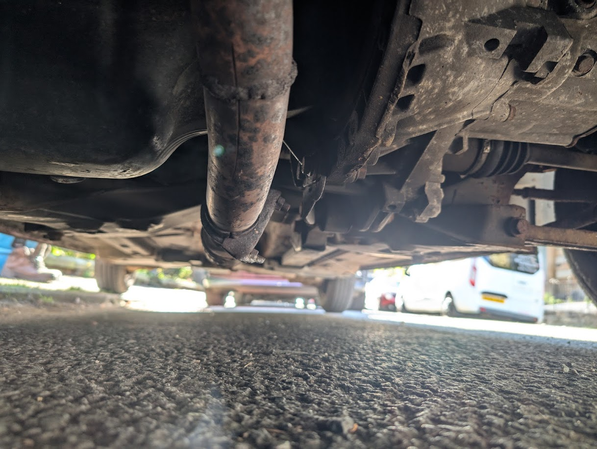

Thank you all for your replies. I really appreciate the help as someone who knows jack about this. While you are all here, I also scraped the bottom of this car in a rocky car park and seemed to have damaged or dislodged some kind of exhaust clamp? I think theres also a crack in the exhaust in this photo :confused:
You can see where it scraped by the white bit from the rock. Not sure how it managed to scrape there unless it was already hanging low?
Here is what it looks like from outside:
Any help with what is happening here too? Thanks again everyone
The weld on exhaust doesn't look factory?
