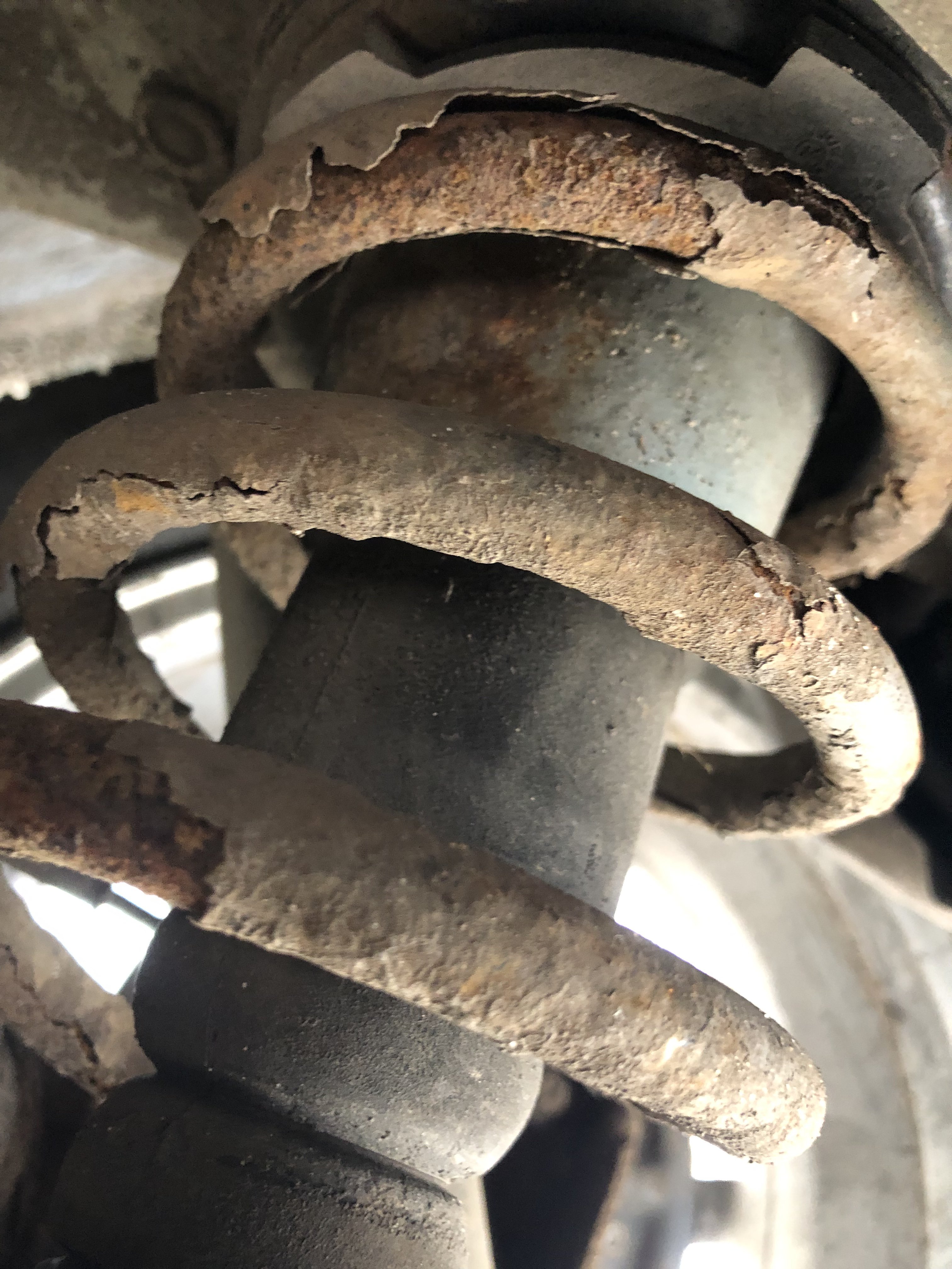

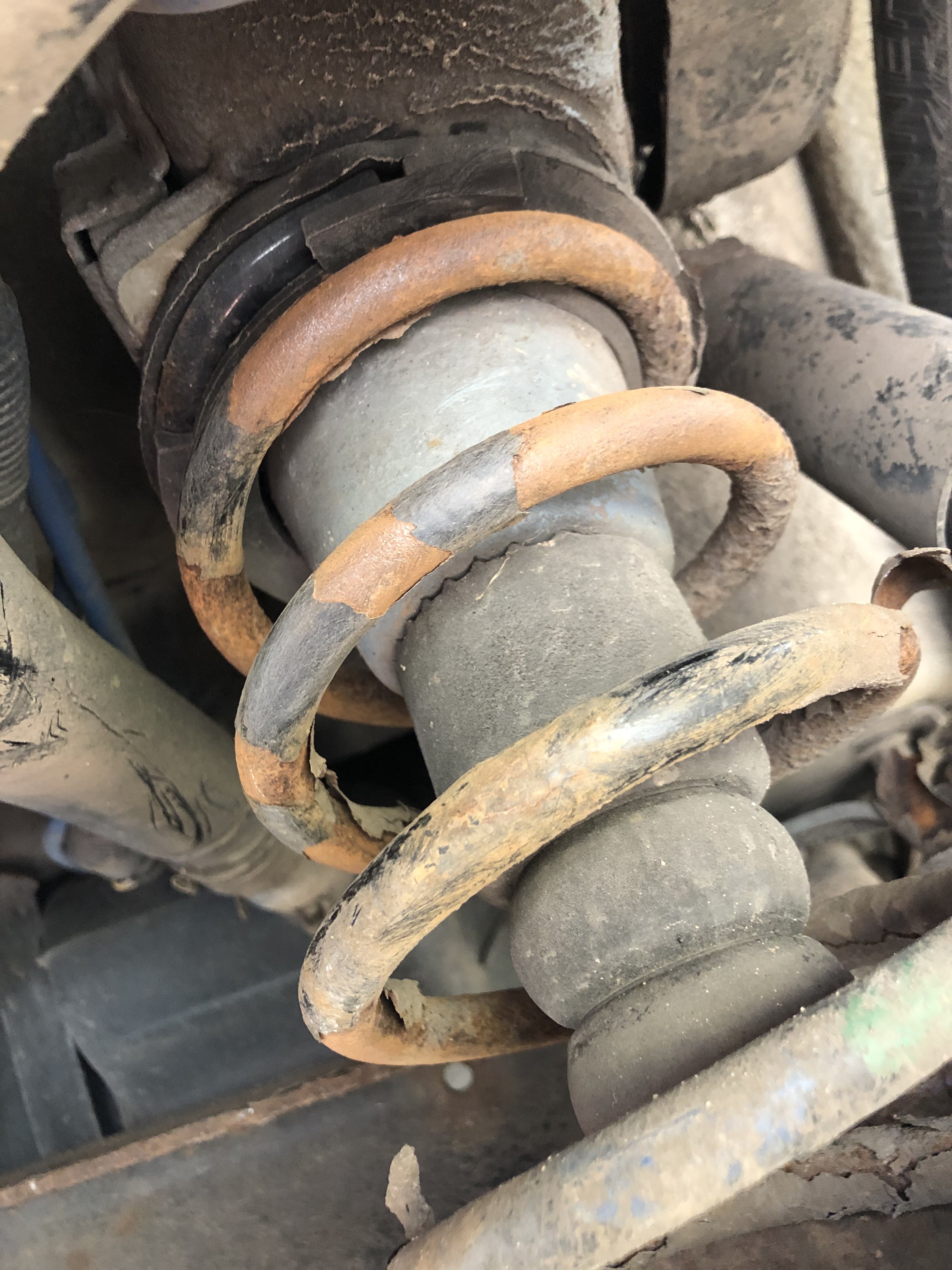

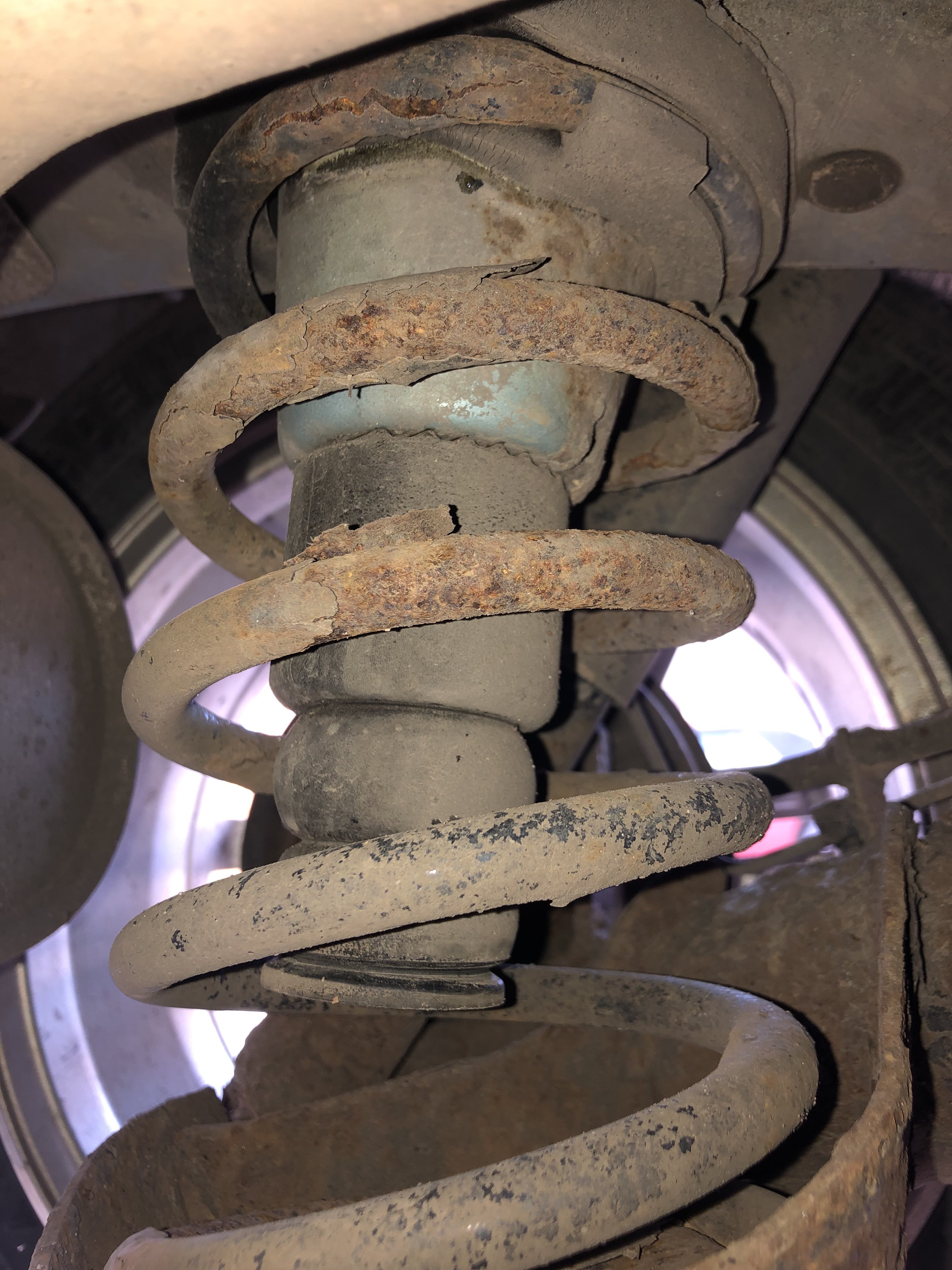

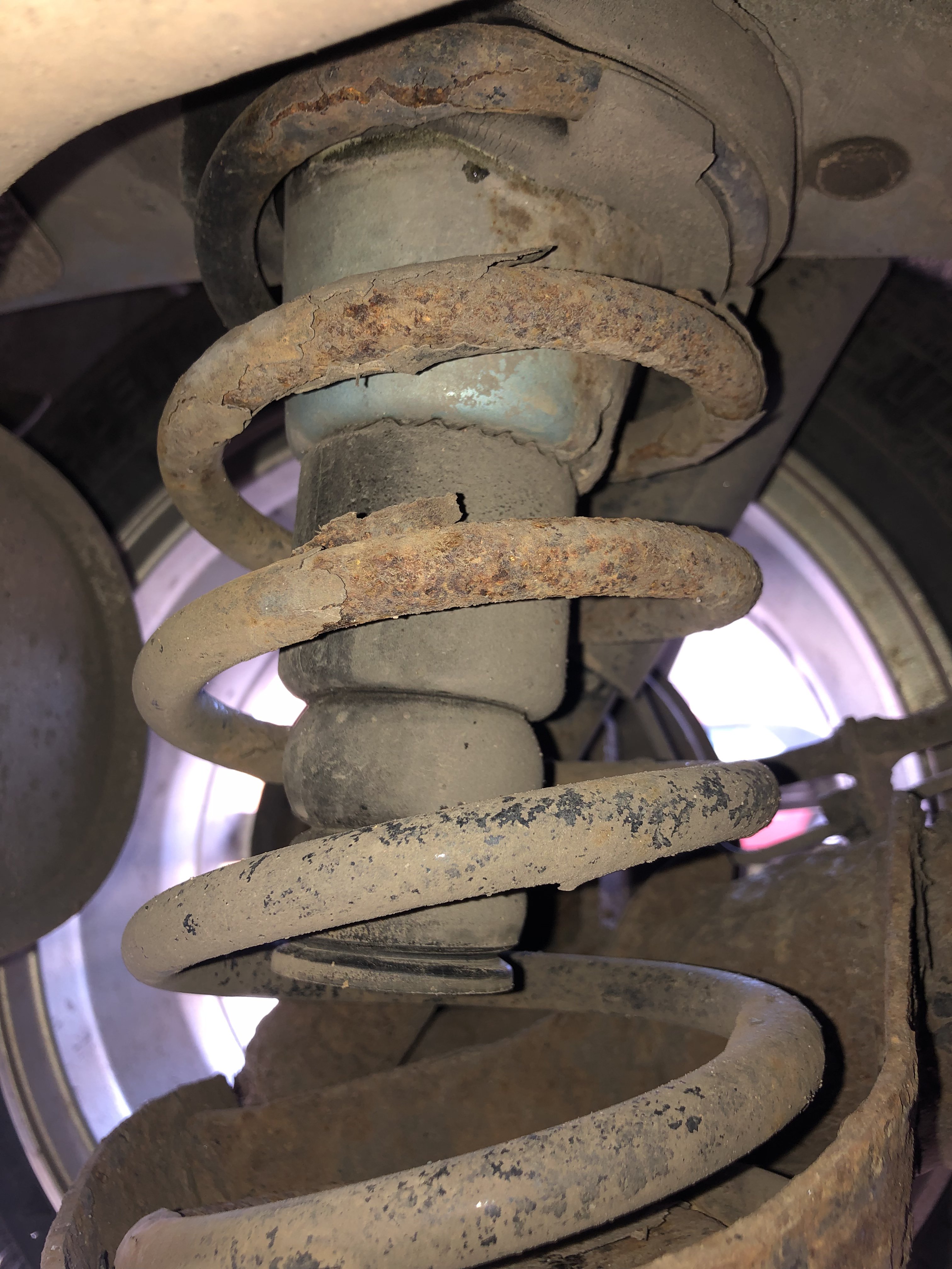

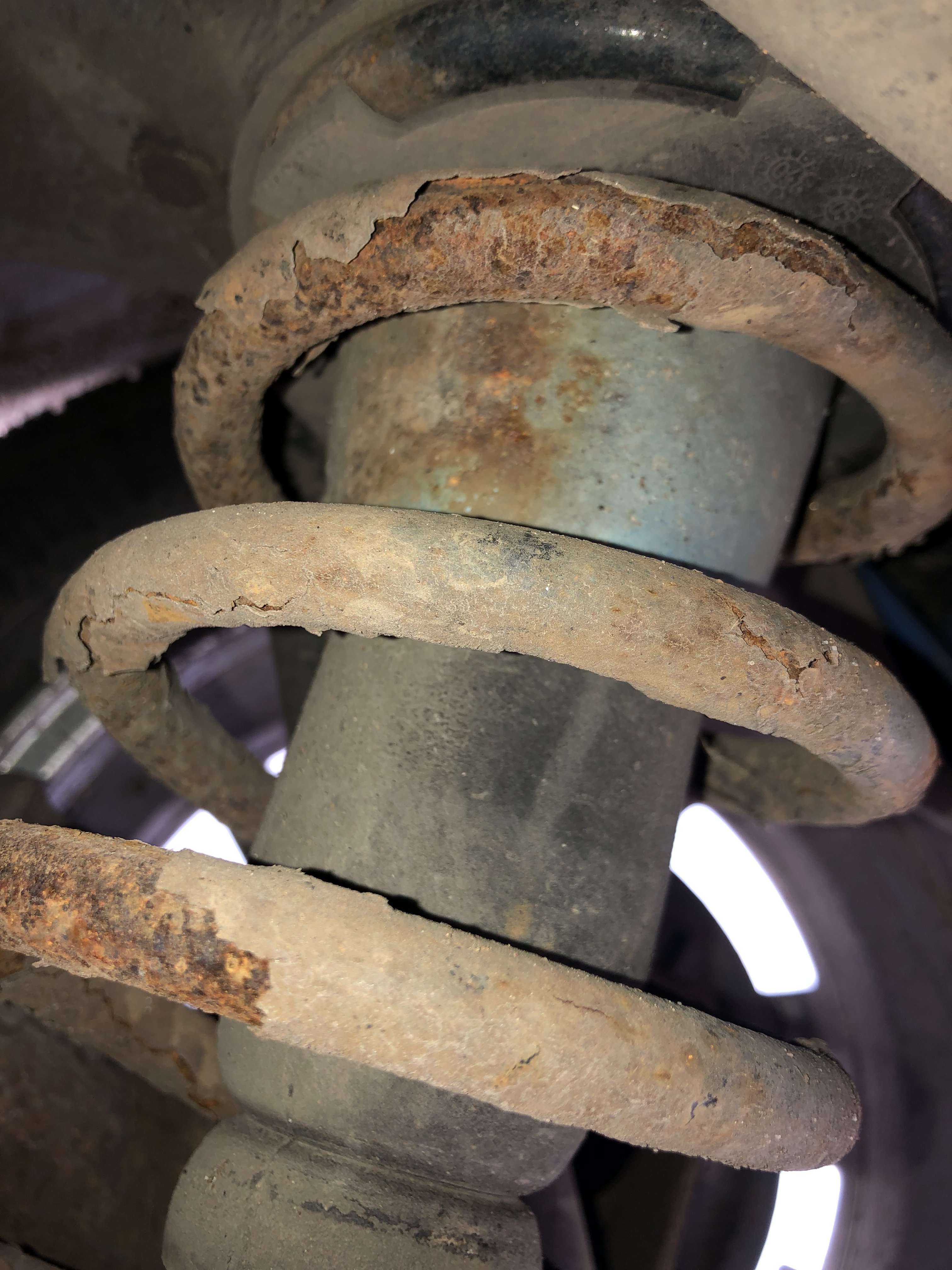

Our 04 panda just failed mot on a few points. Feels like they have been a bit harsh with their inspection and want another opinion. Failures are all on suspension and exhaust parts which is convenient as I took it to a tyre, exhaust and suspension garage….
To me this just looks like a bit of surface rust on the springs. Thoughts?

Some testers are more cautious than others, and corrosion weakened springs can and do break. I can't say it's an unfair fail, though most testers I know would have let this go through. A different tester might have given you an advisory on the springs, and a fail on one of the other advisories.
On a near-twenty year old car, it's simply not economic to replace everything that might be a marginal fail before an MOT. You just have to put it in and take it from there.
I've found from experience that testing stations which don't do repairs (like this one) are more likely to give the benefit of the doubt on marginal items.
All that said, having seen those pictures, and knowing the structurally weak points on the Panda, I'd actually be more concerned about the state of the rear spring pans.
you only have to look at springs which have broken to know that they will break with considerably less rust than that. It only takes the surface of the spring to start pitting and a crack can start to develop.

I don't think it was all that harsh for them to have failed the springs. The pictures show the paint'powder coat to be seperated from the coil in places, there is a clear hole if you like in the coating and the state of the spring inside of that is not clear to the MOT inspector, its not their job or within their remit to go poking around and trying to see if there are holes or cracks in the metal beyond that coating but the coating would not have seperated like that unless there was some pretty significant surface rust, So they did only what they can do.
Had they been cleaned up and all that loose coating removed before it was submitted for testing its possible they would have passed.
As other's have pointed out the rear beam with the cups/pans which the springs sit on top of, tend to rust on panda's very badly to the extent the back of the car can collapse. The 3rd picture at the top of this thread shows some pretty significant rust on those pans which you really need to address sooner rather than later, otherwise you're looking a big bill or a nasty accident, which ever comes first.
