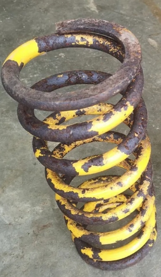

Our 04 panda just failed mot on a few points. Feels like they have been a bit harsh with their inspection and want another opinion. Failures are all on suspension and exhaust parts which is convenient as I took it to a tyre, exhaust and suspension garage….
To me this just looks like a bit of surface rust on the springs. Thoughts?

I'd still change the rear springs

Its not like they failed the springs when they were in tip top, brand new condition.
They are still rusty and having cleaned the paint off them and tidied the appearance up is not going to have fixed any cracks that might have developed.
They are still rusty, the surface of the metal is still significantly pitted, so while you might have got it though an MOT, I would still change the springs. and I wouldn't call changing the springs "unnecessary work"

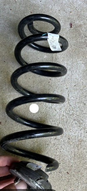

Nearly new with no rust snap especially in winter
I have had two snap in the last couple of decades, Neither were rusty
One was a merc a class after hitting a pot hole hard
The other was a suzuki alto, just reversing out of a drive slowly

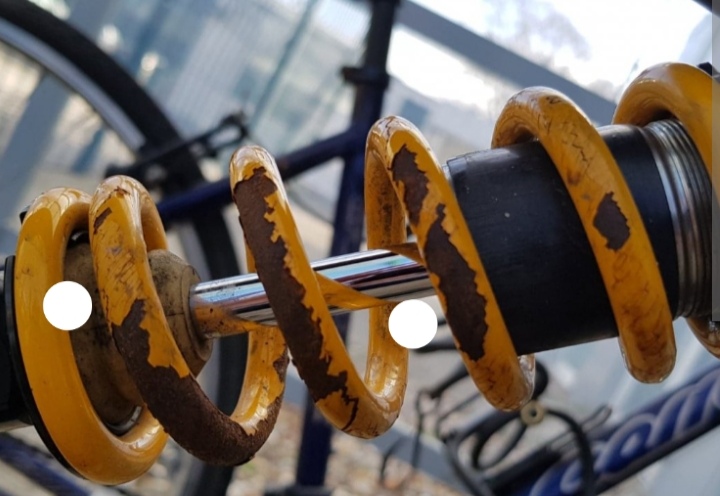

But rusty springs are very common whether a mountain bike, motor bike, car or lorry
A good percentage of cars over 10 years old will have surface rust on the springs
Most people just don't notice and does not fall under a MOT fail.

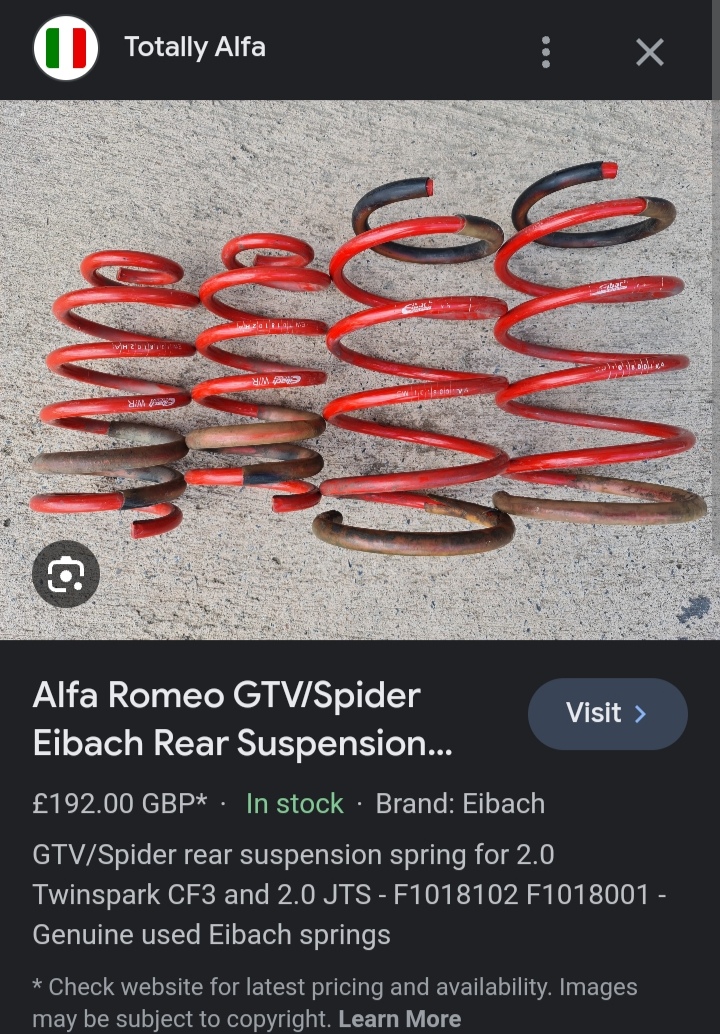

For nearly £200 you can buy a set for an Alfa from a well respect garage
Unless it's cracked, fractured, or corroded such that the cross sectional area is reduced to seriously weakening it Its no different to the majority of cars on the road

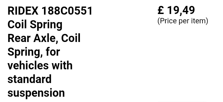

£300 is rediculous, for two springs, two bolts and less than 10 minuites
I can buy them for £20 each, without a trade account

If you shop around you can probably get the springs for around £30 a side so £60 all in. You spent a lot of time crawling around under the car to clean up the springs that were there, you might as well removed 2 bolts, changed out the springs and put two bolts back in. So while you keep saying £300 is a lot of money, you will still ultimately need to change the springs and by doing it yourself you could save £240 on what you keep quoting.
