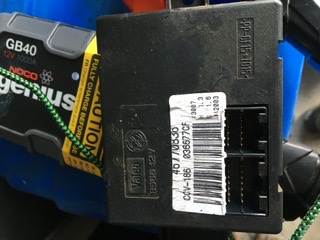

Locate and unplug ccm see if short is still present or gone.
a circuit diagram with wire colours on
And help identifying what else that fuse feeds would be of great help.
Ok I m not sure if this is climate control , but checks back to the relay however it’s disconnected so will see if the fuse blows
