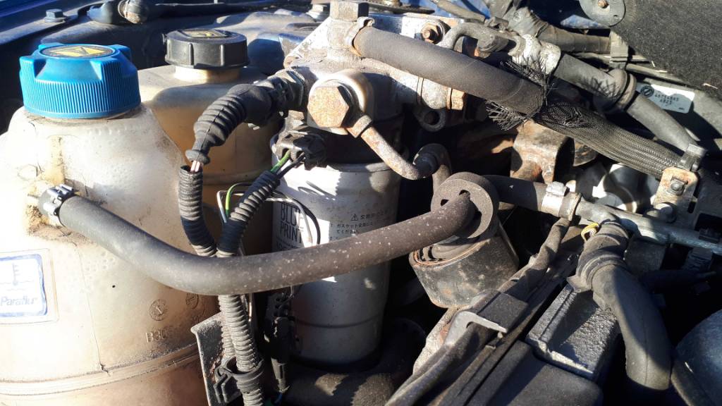

Post a picture of your battery in place with something pointing to the blown fuse location
Ok not good at this , other sites are much easier , I can’t get the hang of this at all . I can get the photo from the phone but haven’t been able to continue from there

That's great it worked.

The fuel heater is part of the diesel fuel filter head the filter is screwed directly below the fuel heater

Anyway I ll extract the filter body , there is a yellow plug on top as I have said but the wires look ok , but its maybe not the one I should be looking for .
Maybe not tonight , I will see.
Filter bowl removed and plugs of top and bottom.
Key turned to ign , no life of lights on dash and again the fuse blows(filter heater relay)
The plug in the centre of picture is plugged into fuel heater.
You don't have to extract the heater just unplug it.
