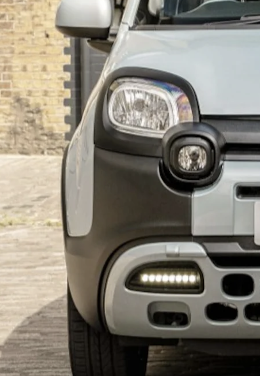

Driver’s side daytime running light is less bright than other. No warning lights are showing. Any suggestions as to problem?

On the Cross model (which this is), they have different, all LED DRLs with non-replaceable ‘bulbs’ (and the fog lights move up beside the headlights

I know it's already late, but if the problem is still not resolved I can help as I had the same problem when I bought my new panda. The issue is that one of the drl was facing down more than the other and when I looked at the front of the car the lower light seemed less intense, but if I lowered it a little the intensity increased.
The solution was to adjust the drl orientation, this was done by the dealer.
