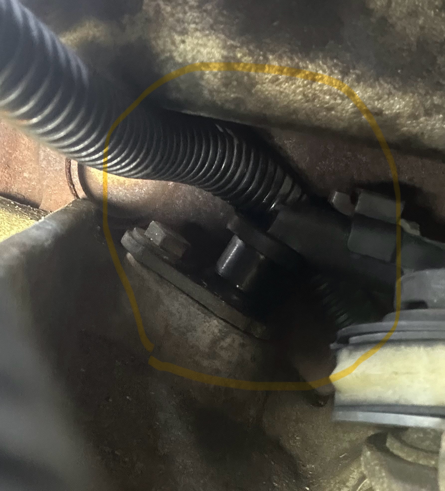

I managed to find it but it feels like it’s going to be a bit awkward as I can only feel the nut and doesnt feel like there’s enough clearance to pull it out I’ll try and get a photo 👍
is this it ?

is this it ?
It looks to be in the right place to pick up a signal from the flywheel.
Does it look like the replacement Crankshaft Position Sensor.

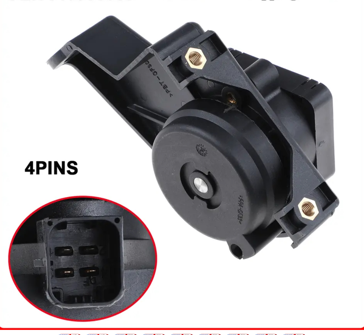

I can’t find an earth wire do you know where it’s located
this the tps just bolt to metal frame
